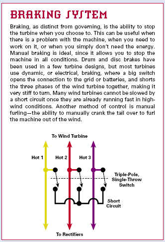

Joined: 25/02/2006
Posts: 495
Posted: 10:14am 25 Mar 2007
  brucedownunder2 said
I have installed a big 3 phase breaker beside my control box . The mill 3 phases come in through this switch and before the rectifier bank.
It works perfectly,but wait till the mill slows,by keeping an eye on the Amp meter, then switch in the dead short, a piece of bussbar connecting the 3 seperate breakers .
Just a little comment here....
Yes, common thinking is "3 phase circuit, need 3-pole switch".
I did my brake with a heavy duty *DOUBLE POLE* switch which was WAY easier to get and LOTS cheaper.
If you think about it logically, you don't need 3 poles.
Join one end of BOTH poles of your switch together with heavy wire and run that to phase 'A'.
Run phase 'B' and 'C' to the other ends of the switch.
When the switch is open, all 3 phases are unaffected.
When the DOUBLE POLE switch is closed, all 3 phases are shorted together.
