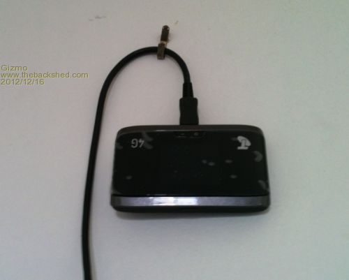

A few months ago I signed up for internet at my new residence. At the time I had no land line, and even if I did, I was too far from the exchange to get ADSL, so mobile internet was my only real option. Ended up with a little rebadged Sierrra AC760S. It's a 3G/4G wireless hot spot device. I'm in a very poor mobile reception area, my mobile phone only works in a few places around the house, so I wasnt't expecting much better for my internet hotspot, not with its standard internal aerial anyway.
The AC760S does have some basic screens, and signal strength indicator, but I soon discovered this has little to do with actual internet speed. By relocating the 760 around the house, I could get up to 4 bars of 3G signal, but my internet speed was very poor. Here's the 760 hanging on a wall, the best location for it.
I used http://www.speedtest.net to measure my internet speed, and the best I could get was about 400kBs. 400kBs is OK for checking mail, light intenet surfing, etc, but I knew I could do better.

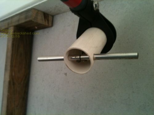

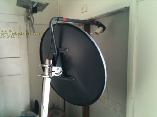

After reading a few forums ( http://whirlpool.net.au/wiki/nextg_3g_satellite_dish_antenna ) where members used old satelite dishes to improve their 3G service, I decided to give that a go. I purchased a small dish from the local recycling centre for $15, and mounted a dipole at its focal center, then started testing.
I have 3 mobile towers I can use, Oakey and Pittsworth are about 15km away, in opposite directions, and behind hills. Dalby is about 50km away, with no hills in the way. Using a map I worked out the direction to point the dish, and then using speedtest.net, fine tuned the direction until I got the best internet speed. Speed was best with Dalby, and I could download at around 4 to 5 MBs, about 10 times faster than before. Oakey and Pittsworth would give about 3 MBs.
With the dish my internet speed was now very good, I could stream youtube videos and use remote desktop on my clients computers, so I thought that was the end of the project. But I was soon having problems with the internet dropping out. It would be fine for hours or days, but then die. Dissconnecting and reconnecting the 760 didn't help, the only solution was to turn the dish to another of the 3 towers, reconnecting, and it would be working again. It got to the point where the only way to have reliable, if slow, internet was to dissconnect the dish, and use the 760's internal aerial.
I guessed it has something to do with the dishes directional width. A few degrees one way or the other would kill the signal, and maybe the terain between me and the towers was having an effect. Plus if a tower is having "technical" problems, the dish meant the 760 couldn't switch to another tower, since it was focused on one tower only. The fact the 760 could work reliably with no dish meant it could pick and choose which tower to use.
