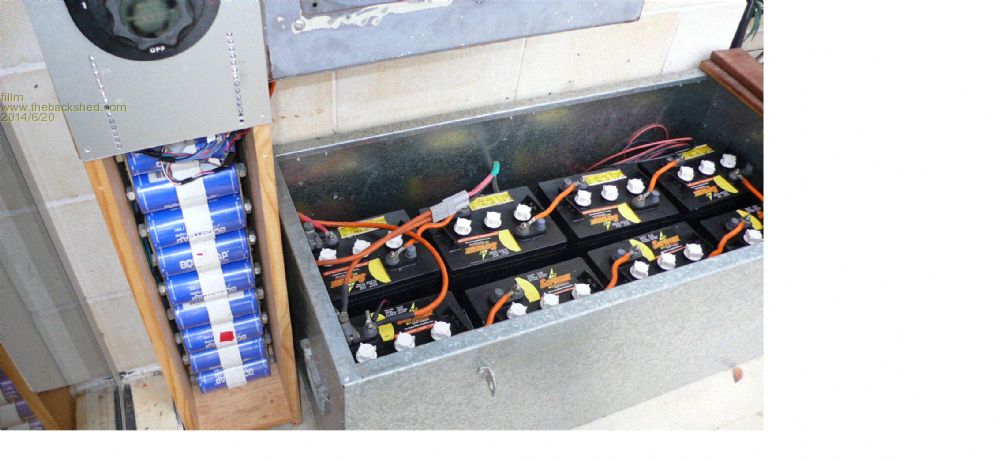

Ultra-Caps are very viable option to add into a Grid Tie system. I have had this set up for a number of years now. I do not know why because some engineering student does a 45 page thesis all of a sudden make it a discovery as buses and other forms of electric vehicle applications have been using ultra caps for power recovery on regenerative braking for quite a while.
With wind/solar it is no different, as gusts and solar bursts cause rapid power spikes and overpower batteries causing damage because of the slow response time of grid inverters to match these spikes.
Before I added the Ultra Caps the voltage line on my logger over a day looked like it was recording a R9 earthquake, after adding the Ultra Caps the line is not totally smooth but everything reacts at a controlled pace , as well as reducing the lost power due to the solar being backed off and battery losses due to gassing .
I have 25 x 2.7V 3000 Farad Maxwell Ultra Caps that are in paralell with a 48V / 225A/hr battery set , they can be switched to be run as separate systems or together which is normal. The ultra caps can absorb 8000W for a period of 30sec with a voltage rise of 53 to 60Vdc , so this easily absorbs wind gusts and solar bursts .
Here is a pic of the Ultra-Caps / Batteries , there are 2 x PVE 1200 Grid Inverters feeding off the system , 2.5kw of Solar and at present I have 2 x 2kW Chinese wind turbines up for testing , one with the GOE Blades opposed to the Factory supplied blades.
I posted some info some years back when I fitted them and after that Tinker also added them to his system , I do feel they have a place in grid tie systems such as mine but as for Off -Grid I can see no benefit. If you are getting rapid voltage Spikes means your batteries are to small or buggered.
