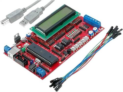

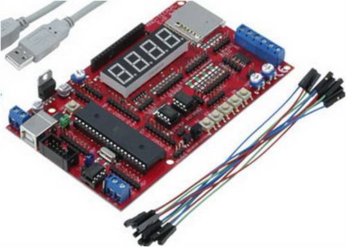

For Atmel ATmega microcontrollers fans (ATmega16, ATmega32, ATmega644P) I recommend this development board with a great of configurability:
Pdf manual
Is a Polish board and the good news is that you can use it with Microchip microcontrollers - not directly inserted (DON'T EVER DO THAT) but via those "one pin" connection wires (of course, you must remove the ATMEL microcontroller first). Someone is using it in this mode. And this way.
