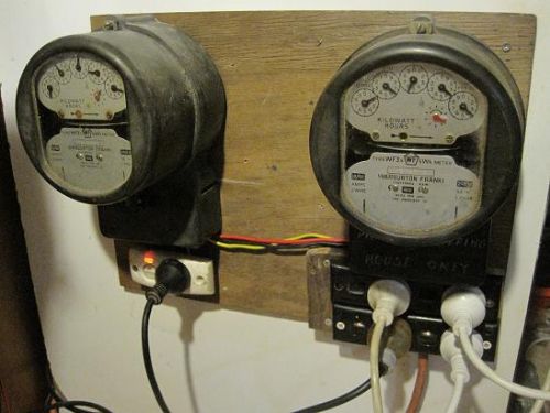

Winning and loosing meters
The meter on the right was giving conflicting readings, some days a few units and some days none at all, although the disc was turning.
I pulled it apart and observed the fine worm pinion was no longer in contact with it’s mating gear.
A little twist of the frame and it now is working.
Originally I had them mounted pressed together and was getting strange results.
If our consumption was up for a day so was the production from the grid ties.
If we were away hardly any power was delivered at all.
I spaced them apart and the results were more like I would expect.
Except if we were away for a day not many units were produced.
So lets leave this peculiarity for now.

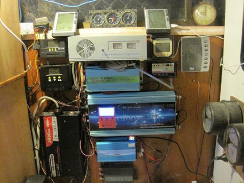

Here is Big Happy Jack with his bros
From the top on the window ledge,
Meters on the left and regulator is for the 12 volts of the internet/phone, then weather station monitor, humidity/clock/temp, another weather station monitor and my childhood old bedside clock (stopped at 10 – coffee time)
Next row – Solar 20, Big China’s Wind controller, Dual battery controller, dead Bios weather monitor.(Another story)
3rd row – Solar 60, 600w Grid tie inverter
4th row - 2500 watt inverter, Big Jack
Below that is the 600w wind controller and at the bottom is a spare china wind rectifier.
Explanation –
The Solar 20 is connected to the outputs of both wind controllers and to the 600 watt Grid tie inverter.
When the batteries reach a determined voltage the Solar 20 switches off and the gennys drive the grid tie.
I should mention that I need a wind of at the minimum of 20 kph to make any useable power.
(I am thinking about voltage doubling caps)
The Solar 60 is connected to the solar panels and Big Jack, when the batteries reach 26 volts the ’60 switches off allowing the panels to power the inverter.
The 2500 inverter runs the house when the grid is down.
This Power Jack 1200 watt Grid tie has been working away with 1200 watts of panel for some months.
I thought it was all working like it is supposed too, but I have noticed that the best I have seen it converting is around 760 watts.
I expect as it has to have 28 volts to start up this reduces the amount available from the panels.
A few weeks ago I noticed Big Jack flashing the red led (twice) then back to the pulsing green.
This began to get more regular, eventually, always when the output went over 510 watts
The unit began to buzz and click each time the red led flashed.
I have put up with it for 2 weeks; it seemed to be getting worse.
So on a patchy cloudy day I settled in with a cup of coffee to watch.
I noticed the red neon in the power point under the winning meter flickered when the red led in Jack flickered.
I grabbed a double adaptor and connected a 40watt clear bulb with the inverter.
A micro second before the red led flickered the bulb pulsed brighter. (So higher voltage?)
Then it would go back to working until the output crossed the 510 watt point.
What the heck does that mean?
