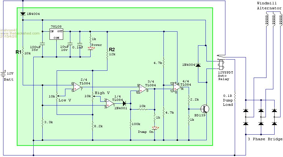

hi. i have build this charge controller and was working fine untill i bought a 180 watt solar panel.
once solar panel supplies about 20 volt the relay starts switching extremely fast on and off. it seems the 12volt relay cant handle this higher voltage. would a 24 volt relay work.not sure if it would operate also at 13 volt
the low trimpot is set at 13volt and the high trimpot at 15 volt
here is the link of controller I build.
http://www.thebackshed.com/windmill/articles/TL084-Controller.asp
thx

The relay and rest of the circuit is powered by the battery, so should never go much above 15 volts. So no way should the relay ever see 20 volts. Just wondering how you have the controller set up. If it was me, I would have connected the solar panel where the windmill bridge rectifier is show in the circuit, and dispensed with the dump resistor as its not needed for solar.

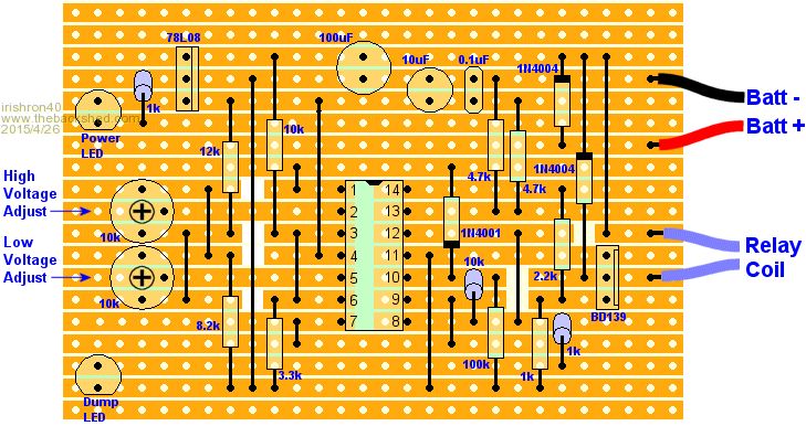

thx, pin 85 and 86 are connected to the 2 wires form veroboard which indicate relay coil.
pin 30 is connected to + of solar panel
pin 87a is connected to + from battery and + from veroboard
pin 87 is dumpload which i dont use
thx
Posted: 09:52pm 25 Apr 2015
180 watts at 12v is 15 amps, and that can result in some serious voltage drop across the wires from the battery to the relay 87a contact. As you are also connecting the controller to the 87a contact, its going to be affected by this voltage drop. Chances are the controller is measuring something like 20 volts, while at the battery its only around 14 volts, so the controller is switching the relay off. Ideally, the controller needs to be connected directly to the battery terminals, so its measuring true battery voltage.
I would connect the controllers positive and negative input directly to the battery terminals, and see if that fixes it.

just thinking Gizmo. the battery doesnt show 20 volt. it happens when the supply from the solar panel reaches about 20-21 volt. I still think that the problem is whith the high voltage going into the relay(pole 30)as its a 12 volt relay. and normaly could take upto 130% of its rating.which would be about 16 volt. any higher the coil would get hot and burn out. correct me if i am wrong please. thx

A 12V battery -can't- show 20 V, the most you see if its really really fully charged is around 14.5V.
Think of a 12v battery like a sponge, it can hold only so much water (charge) no matter how wet you try to make it.
Your solar panels -should- put 20V to the -input- side of the controller.
You -must- power your relay from the output (battery) side of the controller.

yes according to these 2 diagrams it shows input to veroboard is from battery.
it shows input from turbine is or solar is connected thru the relay.
now Im confused.
its working fine untill solar panel gets full blast sun and supplies 20 volt and over.
Posted: 01:27am 26 Apr 2015
Pretty confident if you connect the controllers Batt+ and Batt- directly to the battery, it will work. In your post you said "pin 87a is connected to + from battery and + from veroboard", meaning you have two wires going to the 87a contact. Ideally, this should be at the battery, otherwise the controller input voltage, which it uses to monitor battery voltage, will be affected by a voltage drop in the wire from the battery +ve to the relays 87a contact. At 15 amps in full sun, this voltage drop could play havoc.

ok changed it so that + from veroboard is going strait to battery.
I also connected my volt meter dirrectly to battery.
I did notice that voltage reading was a little lower now.
so far no rattles. I keep it like this for an other day to see did it really fix the prob.
I now also understand that this way the coil get less voltage.
Fair play to you Glenn.
I think you have proven right. AGAIN lol

well glenn. that did seem to have sorted the problem.. I only didnt get a chance to run a separate neutral. I also lowered the low trimpot to 13 volt. now it may only click once every 5 min. thx very much for your help.
Posted: 12:36pm 27 Apr 2015
When you said you had connected both the battery and the controllers + input to the relay contact, I knew that would be the problem. The wire between the contact and the battery will show a voltage drop along its length when the panel was switched on, and this could be a couple of volts for a 180 watt panel, depending on wire thickness and length. Therefore the controller would see a voltage much higher than the actual battery voltage when the panel is switched on, so it switched the panel off, and so forth. The solution was to put the controller as close as possible to the battery terminals, or use very thick wire.
