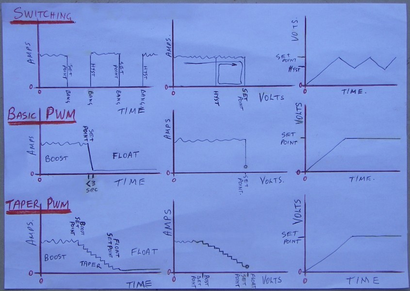

For those trying to follow this thread on PWM regulation, here's a few little graphs for those(like me) who need a little visual input too.
WIND GENERATOR REGULATORS
correction: the two little circles should sit on the 0 line
What we all use(to my knowledge) is the top one.
Gordon's project is the middle one. You Beauty!
And I am about to attempt the lower one.
The area of most concern with my proposal would be displayed by a large circle in the middle graph also shown as a ripple in the Float lines of the two outer graphs.
I hold the optimistic view that it will be well within acceptable levels, so I have to make it and see.
I am a plodder at making things, but it will happen soon.

Fortunately, at no time does your test results report a failure of the device to satisfactorily achieve it's intended purpose.
Unfortunately, I don't think it was tested for it's intended purpose.
Cheers Gill _Cairns, FNQ
GWatPE
Joined: 01/09/2006
Posts: 2127
Posted: 06:52am 26 Nov 2007
Hi Gill,
Yes, somehow a line of code re measuring the amps fell off the upload file.
There was enough wind today for testing.
The code does regulate. I still noticed some hunting though in the float operation. It may be due to the time constant on the battery voltage sensing input. I will not persue it though. Good work Gill.
I design my ccts for worse case. This includes one where a battery lead comes off, or corrosion restricts current flow, etc. My ccts have to do their job, even if this happens. This is what I expect from automatic control. I have some form of foldback protection ahead of every vulnerable component including rectifier, slip rings and MPPT. My setup will work without a battery connected, even though I do have a battery in the system at the moment. I regulate the voltage by feeding back to the grid. If the grid fails, then my system self protects by regulating all the power inputs to the battery. All happens automatically. My battery spends most of its time during the day at 27.7V, and my 24VDC to 240VAC inverter is bypassed. Today the power went off for a few minutes. The main solar array shut down with the grid connect inverter. The 24VDC inverter was reconnected. The smaller array MPPT then boosted the battery to 29.5V. This triggered the mill shutdown. The solar MPPT regulated the battery back to 27.9V. The mill then cycled on and off in a casual manner. [The mill MPPT starts producing output at a generator voltage of 10V, around 5W output.] The system restored to normal operation when the power came back on. I do not use a dump load, as I can just electronically short my mill output with the MPPT cct, in any conditions.
I have to get back to the AXE-08M MPPT project now.
cheers, Gordon.
