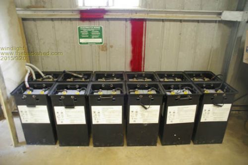

In May 2011 I "retired" moved to the Daintree rainforest, I put my hand in my pocket and outlayed $80k on a renewable energy system.
10 Kw of solar - great
Selectronics inverter/charger -great
3x Zantrax solar controllers - great except it's a pity programing an equalize is next to impossible.
And oh must I say it a bank of 1600 Ah Exide batteries, now here I must admit Exide seen me coming, in 4 years one failed, the day the installer (a very helpful and genuine guy) took away the offending battery I discovered another dead in the water. I predict 4-5 to follow based on readings, so obviously Exide is not my flavor of the month.
Now here I will say they are replacing the dud batteries free, that part is good, but I have lost faith in their batteries that should have lasted me 12+ years ( I baby them).
ATM I am running the generator on evening assist to try and stave off the inevitable.
So what other brands are the rest of you using for total Re systems?

Hi govertical, thanks for your interest, these batteries are defiantly not sulfated they are fully recharged each day, usually by mid to late morning.
It is a manufacturing fault.
Allan

They are Energystore batteries.
Based on voltage and SG
The current dud is still holding reasonable volts but practically zero SG, and when equalizing it has no activity, just as if the electrolyte is just water.
I only do SG readings once a month. I usually notice it on overnight DOD.
Allan

windlight
Joined: 03/03/2007
Posts: 331
Posted: 11:52pm 24 Sep 2015
Since this is a single bank all batteries see the same current, I am waiting on replacement #2 and hopefully feed back on the first failure.
I tend to agree with your assessment of an internal short, but how many more? assuming they are all from the same "batch" happy days.
windlight
Joined: 03/03/2007
Posts: 331
Posted: 11:24am 01 Oct 2015
OK just had the second battery changed this morning, still no feedback on what is happening.
The agent did say that he doubts it's an internal short as they normally go reverse voltage if they short, this was still about 1.1V correct polarity but SG 1.
Allan
yahoo2
Joined: 05/04/2011
Posts: 1166
Posted: 07:35pm 01 Oct 2015
when you consider 2.1v is charged and 1.7 volts is stone motherless dead flat, a measurement of 1.1 volts unloaded could be measuring any stray voltage, the cell is completely stuffed. if the current is getting from one terminal to the other when you have used them then for all intents it is low resistance somehow.
I wrote a post on how I test cells however My computer hates me and I am trying to cut hay so I gave up.
I have made a point of tracking down what is wrong with a cell with these sort of symptoms in the past and I can tell you that no-one wants a verdict in case it was their fault.
I have found them bent inside from being squashed, dropped or dented, bits have come adrift, bus bars melted, somebody has added some special sauce or contaminated the acid somehow and there is scum or jellied crud inside, the list goes on.
there is not much future in babying a set of batteries, it will make you paranoid after a while and that take the fun out of life!
windlight
Joined: 03/03/2007
Posts: 331
Posted: 07:47pm 02 Oct 2015
I suspect you are right about cause of failure.
