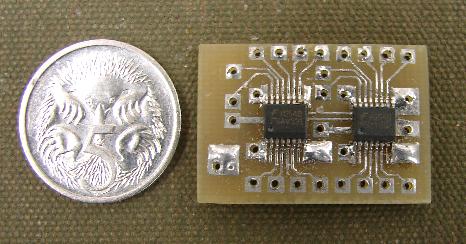

The modern use for the 15 pin connector is in the DB9 shell format with 15 pins as the analogue PC display connector. This has 3 rows of 5 pins. This connector is extremely difficult to use on anything but professionally made boards. It is almost as bad as soldering quarter size SMD DIL components. [These are the ones with 0.025" lead spacing] I have used these sub miniature components in the analogue multiplexer on my logging board. Very difficult to solder. A bit like soldering a component with 16pins the size of a grain of rice.
Here is a photo of my logger multiplexer, 2 channel with 2 x 4 into 1, 2ohm resistance multiplexers compared to a 5 cent.
The IC's are the little black bits. I will leave you to ponder on that.

The black bits are what we commonly call cockroaches or centipedes.

I think you will appreciate that the components I am using are far smaller than a caterpillar, or cockroach or 5centipede.

Those little surface mount ic's. I solder one complete side in one hit with lots of solder, then suck up the excess with solder wick. The chips I use at work are CS5534's, 24 pin.

I don't do it for work, but I use a similar process.
