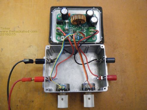

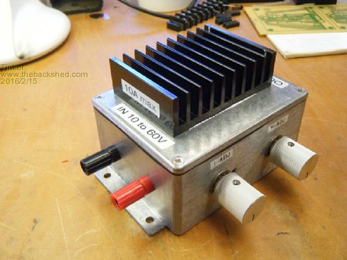

To make this module more user friendly I fitted it into a diecast box.
I should have used a bigger box, it was a tight fit. The finished item looks like this.
Testing it all out it worked fine after a little hiccup (more about that below).

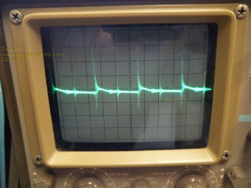

The output with a 150W load gave this trace on the scope.
The scale is 50mV/div, I think those little spikes could be easily removed with a series choke if so desired.
The larger potentiometers make it easy to set the unit, I particularly like the current limit feature which works well.

Nice find Tinker. Yeah a choke and a few low ESR filter caps on the output would help.
