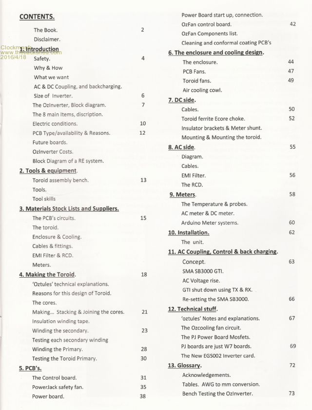

The Book Index....

I have talked to the 3 most important World wide Forums Moderators and they understand where I am coming from and that this OzInverter should be published and OUT there.
But I am not keen on downloading PDF as its easily hacked and sold on by the unscrupulous, and I do not have the necessary Police-ing facilities.

I know where you are coming from on the PDF, and I also think you should NOT offer that at this stage. To paraphrase you for a moment, it is really easy for anyone with a flatbed scanner to scan a printed copy and start selling off electronic copies of something they did not even write.
Ill-gotten gain is what it is all about to some - it sucks, and I totally understand your reasons.
I would like to purchase a copy of the book though, when you are ready to sell.
