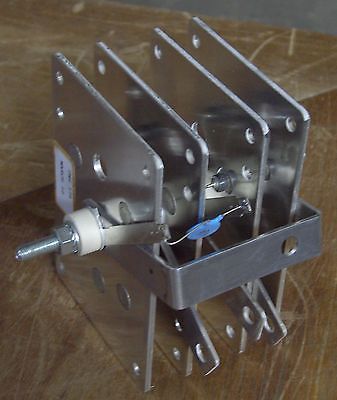

At my favourite scrap yard I came across a 150A MIG welder with this bridge, which I quickly removed. Have read on the web that with AC welding the hot point changes from material to rod 60 times (here 50)and as my welding is "multi-point tacking" I have this dream of ever so slightly improving my welding by changing over to DC welding from AC.
This bridge rectifier consists of two huge 100x100mm heat sinks and each heat sink has four circular diodes pressed in. One heat sink is marked plus and the other one minus. The two rectangular AC supply bars are marked with the swung dash (~) symbol and two cables are coming off those bars. Dr Google cannot help me with this DQB-120A model number. A circular cap (?) connects the two heat sinks.
Questions: The negative heat sink has one thicker cable coming off it but there is no positive lead coming off the positive heat sink. A huge M14 hex bolt is tying the heat sinks together via isolating porcelain disks. There is a U-shaped bar coming off that hex bolt, which connects to the outside frame of the MIG welder.
1. Have just noticed a witness mark of a spring washer or lug on the heat sink opposite the negative cable. Must suspect the positive comes off there. Perhaps someone has already checked if the rectifier is OK.
2. Am ignorant of the AC voltage at the welding rods of my transformer/fan welder, but is it possible for me to divert the AC to this rectifier and make the smoke escape from the rectifier if I try hard enough?
3. The cable coming off the negative heat sink only has a dia. of four mm, how can that carry a welding current?
Thanks.

Had I not been so ignorant I could have avoided contacting the forum. When I connected the 36VAC to the ~ marked bars, the fuse blew. No wonder! Learned all about diode checking from Dr Google and noticed two diodes were dead shorts. A reason for throwing that MIG welder away.
DC welding compared to AC welding gets a good rap. Now I have to wait for a cheap single phase rectifier bridge of 80A or thereabouts.

So... diodes are replaceable, press fit for a few dollars, only problem is they will probably blow again they are usually pretty cheap and nasty, they are the same as car alternator diodes. A complete 3 plate rectifier assembly is around $60 new
have a look at this video mig welder upgrade it might provide some inspiration.

Thanks for that Yahoo2. The rectifier in the video is exactly the one I am working on. Looks like those MIG welders are prone to fail with those cheaper diodes.

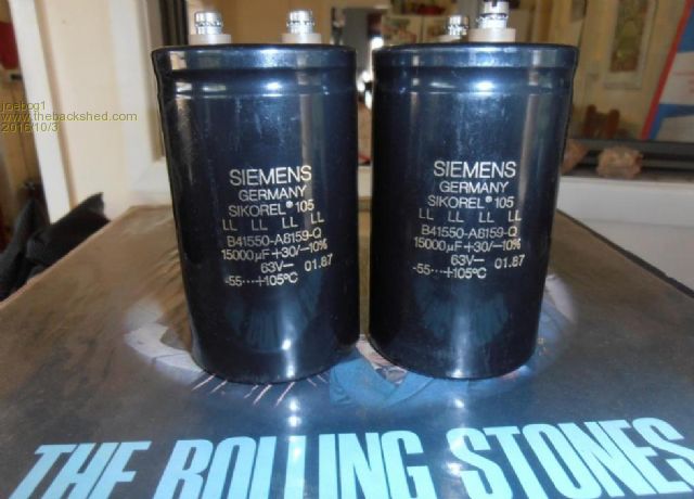

hhmmm to give you an idea, these are the caps Im using.
ex raaf long life even if they were made almost 30 years ago. They are brand new
Joe
The LP cover is to give you an idea of scale
