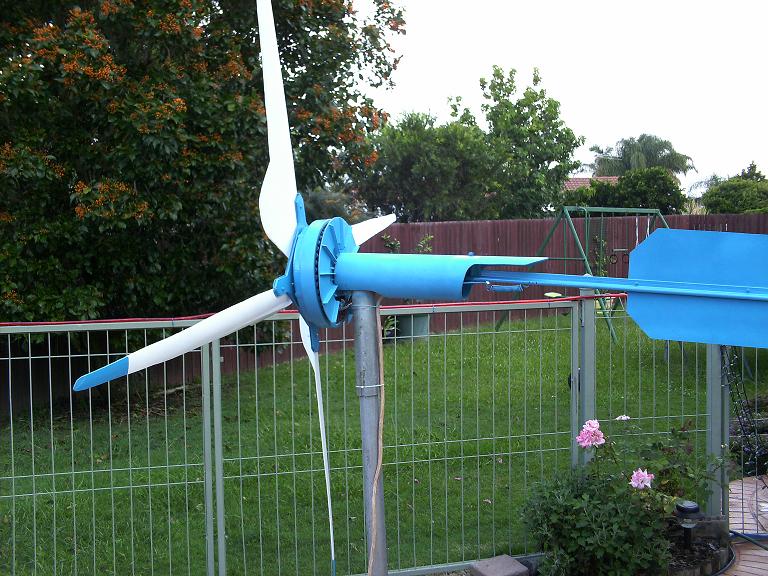

Sorry about the large Pics...

Yeah your turbine is a little small, and those blades a too thin to make any more than a couple of amps. A bigger turbine made from 12inch pipe will be a big improvement. Also you need to get some height, thats a little close to the ground to work properly, not to mention it could take someone's eye out

How high above the ground is the mill head?
The blades could be becoming stalled at the RPM when the load comes on.
Do the blades become a blur if the load is disconnected temporarily during a wind gust?

I forgot to mention, that the picture wasn't the site where I have positioned my mill. Its off the ground about 5-6 meters. That pic was just to test unit. Sorry about that.

Note, Furling system is pretty bad, dont try this method. Will change on the next mill.

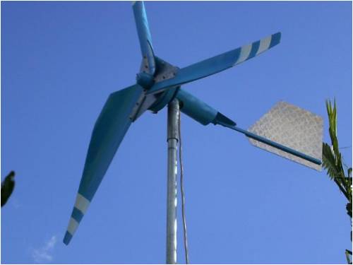

Hey everyone, just to follow up. Have added wider blades from 12 Inch PVC, and all seems to be going well. Have seen more than 10 amps here on the new blades. (3 blade prop). Popped a 10 amp fuse one day, and that was a stupid move, all it did was open circuit, -but this gives a testimony to the strenght of my build -NO BLADE DESTRUCTION !.
