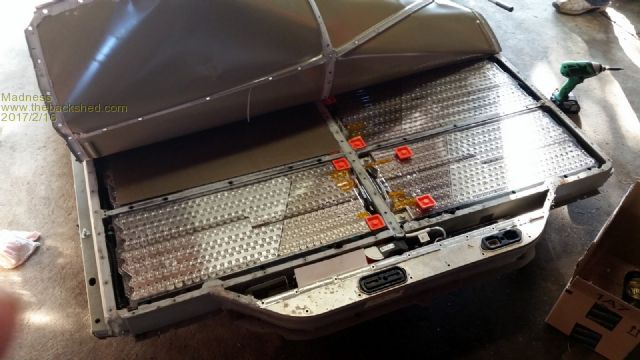

One option would be to get a few thousand 18650 batteries and a 3D printer and make your own version of the Tesla batteries.

Tinker that is exactly what is in the Tesla cars and Power Wall, sound strange but it is true.
When I said you need a few thousand I was not over stating it.

Thanks Madness, for that picture - I did not know they use tiny cells. Perhaps these make it easier to mold the battery into odd shapes.
But the connecting side looks like a nightmare. Perhaps a robotic assembly?

  Tinker said   Thanks Madness, for that picture - I did not know they use tiny cells. Perhaps these make it easier to mold the battery into odd shapes.
the tesla battery pack is basically flat, it forms the underfloor and part of the chassis. refereed to as a skateboard configuration.
2 rows of 7 modules and an extra pair stacked in front for the bigger 90 and 100kw pack to give a total of 16 modules.
unfortunately I am addicted to Bjorn Nyland's LOOOONG Vlogs about road tripping Tesla's, I have spent hours watching him charge those damn things.
I think the 100D charges to 402 volts and has 8,256 cells so that would be 86 cells parallel by 6 cells series per module. I was hoping it would be 7 cells in series because that would be a perfect 14 cell/ 56 volts with a pair of modules for our 48 volt systems.
