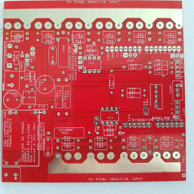

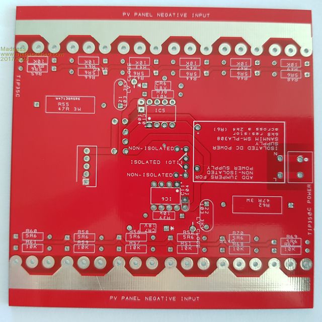

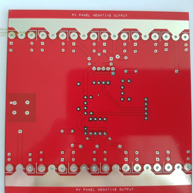

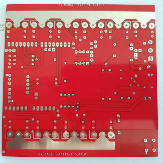

Just received the new PCB's today for the GTI/PV charge controllers.
Master PCB
Slave PCB
These will allow any combination of up to 4 GTI's or PWM PV panels to the battery, allowing control of around 20KW of panels with both master and slave PCB. It is suitable for 24V or 48V but not 12V as the driver chips require 18V. The best PV panels to use the ones with a maximum power voltage (VMP) of 30.4 or close to that. Having 2 of these panels in each string give maximum power at 60.8V which is just above the 59.2V Absorb voltage required for many batteries. Yes a $1,000 plus MPPT charge controller will in theory give slightly more power from the same panels. However, if you build your own controller for less than $100 you can buy a lot more panels with that extra $900, I recently bought 5KW of secondhand panels for $700. So for the same amount of dollars you will have significantly more power from your PV panels.
This is based on Oztules design in this thread, my version has the MOSFETs, isolated power supply and multiple banks of MOSFETs on the PCB. Over the next couple days, I will get a PCB assembled and running. These will also run on Oztules code with the addition of control of the extra digital output pins. I am working new code that will include temperature compensation and the ability to control two separate dump loads (ie hot water system) to take advantage of excess power, I plan to use to control air condition in the container where I have my batteries and inverter.
For those new to this, some Inverters inculding the Ozinverter will allow the connection of a Grid Tie Inverter (GTI) to the AC output of an Off Grid Inverter (OGI) this is called "AC Coupling". The excess power generated by the GTI passes back through the OGI to the battery bank. Some advantages of this are the use of less wiring from the PV panels as it running at a much higher voltage, it takes advantage of the GTIs maximum power point tracking, during daylight the GTI adds to the capacity of you OGI allowing greatly loads and GTI's are readily available second hand for minimal cost. One big disadvantage is that a GTI is designed to make as much power as possible for exporting to the grid, this a problem with an off grid power system as once the batteries are full you need to stop charging them or it will cause harm to the batteries, some types are more susceptible to this than others. However there is now a solution thanks to Oztules and upgrades I have added.
With this control board, we can control the charging of the batteries using MOSFETs and a PWM signal that rapidly turns on and off the connection to the PV panels, therefore, reducing the power going to the batteries as they get towards full charge. This is controlled by a Microcontroller called an Arduino and gives us total control of the charging at a fraction of the cost of commercial charge controllers.

Nicely explained Madness.
Love the painting by numbers boards, excellent.
Had a few electronic guys mumble about my boards being "painting by numbers", but at least normal folk can readily understand what's going where, with fewer mistakes, and easy to repair in the future. Also helps my memory and stops me hunting/ getting paper work out.

Why would someone have a bitch about having the values of the components on the board? I would have thought Ivory towers would be in short supply these days.

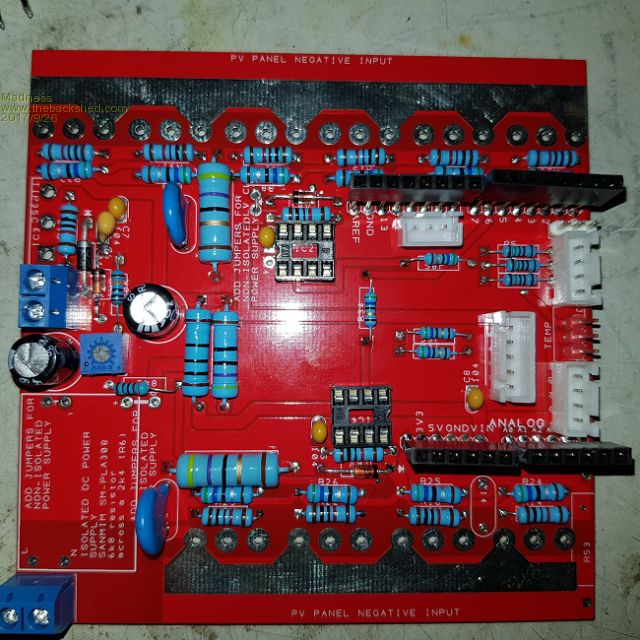

I have had to use long pins for the Arduino socket so there is sufficient clearance for the connectors below it.

This is a game changer board Mad, I can't find anything out there even remotely comparable.
Handles huge current and cheap as you can get, while still having everything you could need to control lots of charging... of any source really.
Don't know why this has not been done before up to this power level... but then none of the home brew inverters are any where near what you have got now either.
Nice work.

[quote]Had a few electronic guys mumble about my boards being "painting by numbers", but at least normal folk can readily understand what's going where, with fewer mistakes, and easy to repair in the future. Also helps my memory and stops me hunting/ getting paper work out.[/quote]
Absolutely !
The guy that has to repair it a few years from now may be YOU.
And a part may have become burned to a crisp where the colours are no longer identifiable.
Even new parts can be difficult to decide if its orange, brown or red.
Or is that white or is it grey, or maybe blue or violet ?
Even some of the integrated circuits have markings that are so faint as to be hardly legible with a magnifying glass under a bright light when the chip is brand new and perfectly clean.
Putting the component values on the board make excellent sense.

As the others said, this is a well put together layout, even I can follow the path and value of most of it. Not having a go at anyone, most of you have built a lot more than me lately.
If all boards were done like this the world would be a simpler place.
At work the guys doing the electronics systems have hells own problems sometimes following the circuit tracks, let alone values of componants.

  Clockmanfr said  Had a few electronic guys mumble about my boards being "painting by numbers", but at least normal folk can readily understand what's going where, with fewer mistakes, and easy to repair in the future. Also helps my memory and stops me hunting/ getting paper work out.
I am an electronics design guy, and I always put the component values on the silkscreen. I actually prefer that to using "R1" and "C8" kind of marking. The latter does have it's uses though, cos then you can find that component on the schematic - makes it quicker to service if you are looking for the most likely point of failure.
However, having said that, I still much prefer the values on the silkscreen. It makes assembling the board that much easier, as you then don't NEED a parts-list....
I also put in the cap voltage ratings etc too. Technically speaking, there is no "Wrong" way to do this - it tends to be individual choice more then anything else at a standardized level. Perhaps if you were going to get thousands made or something, but if you are only doing a hundred or less....
