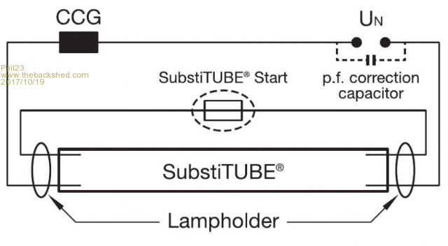

Wiring circuit is like this:-
Osram Substitube
The substitute "Starter", that I popped open appears to be nothing more that a fuse,
so has me wondering if the ballast is even relevant, & whether I can just ditch the Electronic ballasts & wire the tubes straight to the mains.
Phil.
(Suspecting an experiment is up-coming)...

I replaced all the 4 foot fluor's in my garage (10) with led tubes a year ago, they have internal drivers that run direct off 230vac so dumped the iron ballasts, starters and wired end lamp holders in each fitting direct to mains entry fuse and neutral. Made a huge difference to light output and use a way less power.

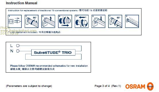

I ended up finding this in a product brochure.
Recommendations fore new installations.
Phil.

the way I understand it is the ideal installation is to remove the iron ballast, wire it directly to the main supply and save energy BUT that is not plug and play level for the average punter so they leave the ballast in swap the tube and replace the starter with a fusable link.
yes you are right, electronic ballasts MUST be removed before fitting LED tubes.
the tubes I have used myself only have an active and neutral on one end the other end is a dummy.
OK I had a look at the page you linked to and in the downloads section there is installation instruction download for both ballasted and direct installation. This is for the EM version they also have a HF version that is designed to retrofit electronic ballasts- that one is not suitable for anything else.
installation/operation 1.1MB
the only one that looks a little tricky is the series connected dual fluro conversion to direct connection.

Sorry for bumping such an old thread but the information it contains is still current and might assist someone else. Following these diagrams and pics in yahoo2's download, successfully wired-out an electronic ballast and added the fuse (bought a starter socket from Bunnings) that came with the EM type A Osram Substitube LED 2 pack from Bunnings. Pack also has instructions but the photos in above "installation/operation" PDF were more helpful. Hopefully Ledvance (Osram) keep the link up. Thanks to OP and all above posters!
