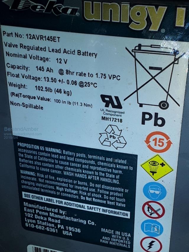

Ben and Amber,
I've had and still got working Valve regulated lead acid batteries for around 15-20 years ,some of them I've thrown out ,because they slowly died.
So, I think you will be happy with your purchase, if you treat them nicely ..
Mine all "fell off a truck" ,but ,thats another story.
Bruce
Bushboy
BenandAmber
Joined: 16/02/2019
Posts: 961
Posted: 02:10am 04 May 2019
Wow that is incredible do you have any post on how you take care of your batteries

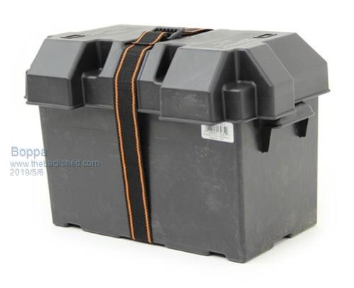

I have taken the 3-cylinder diesel generator out
Out of the its bay to make room for batteries charge controller and inverter
This Bay is vented I'm not sure if I would have to use non-vented batteries or not
but after the story from above I better be checking into it
I know the very back smallest Bay has three very large batteries 4 starting the bus
The bays are huge you could fit a washer and dryer side by side in them and it is 8 ft wide or deep what ever you would call itEdited by BenandAmber 2019-05-06
renewableMark
Joined: 09/12/2017
Posts: 1679
Posted: 09:16am 05 May 2019
They produce hydrogen gas (which rises). (and goes Kabooooom)
They also produce a mist from the electrolyte evaporating and it's slightly acidic.
If that's in a luggage compartment of your bus then it will eat away at the metal unless you pay very good attention to venting.
I fitted a hood over the top of mine made from core flute plastic stuff. Signs are often made from this.
Then fitted a fan to extract the gasses, mine runs out the top of the garage roof.
here Edited by renewableMark 2019-05-06
