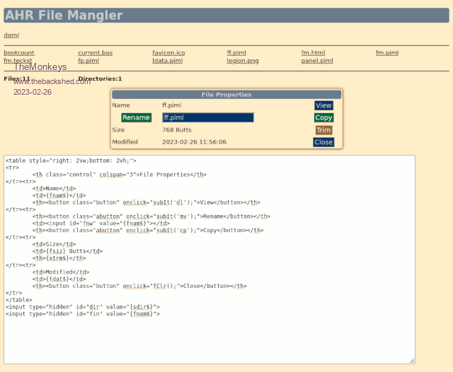

I have some experience with HTML, CSS and Javascript (I spent a couple of years as a web developer).
I'm playing with TassieJim's File Manager. Currently, it's one step away from working (I haven't added the line that actually performs the action(s)).
What is possible is to have a page that updates without re-loading, using javascript to reduce the load on the Pico.
I will admit, though, that for some reason it won't display more than 14 files.
This is the properties form displaying its own source.
I'm quite happy to explain how to make stuff work.
Cheers,
Chris.
Edit: Oh, yes. "current.bas" is the programme currently in memory, saved to disk when the server is run.
Edited 2023-02-26 16:13 by TheMonkeys
