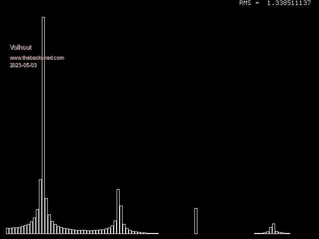

Below is a picture of the captured spectrum from a PWM running on GP0, that is going through a 10k/100nF low pass filter (to change it into a triange-like waveform).
The spectrum clearly shows the 50Hz base frequency, and 150Hz, 250Hz and 350Hz harmonics. Totals spectrum is 0-400Hz.
The program uses 2 more functions that might come in handy:
MATH ADD a(),x,c()
where a fixed value x is added to each of the samples in the a() array, and the result copied to the c() array. In my case the ADC input is around half Vdd (1/2 * 3.3V = 1.65V), so adding -1.65V changes all values around zero.
MATH SCALE a(),s,b()
scales the FFT results in the a() array to the vertical resolution of the screen. Each value in the a() array is multiplied by value s and put into array b().

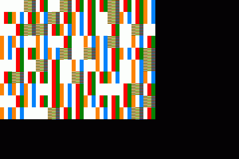

Posted: 03:21pm 14 Sep 2023
Spent a fun few minutes playing with ideas for volhout's PETSCII program and thought this might be more generally useful
PROBLEM
Store sprites efficiently and plot them on the screen (works with PicoMiteVGA or F or L framebuffer on any PicoMite)
Solution:
Store the sprites as CSubs (1 nibble per pixel)
Use memory copy to move the required sprite to the screen
Hopefully the attached is obvious from the comments
MODE 2
plot Rnd*3,Rnd*14,Rnd*10 'demo
' routine to display sprites, currently optimised for 24x24 pixels but easy to change
Sub plot(s%, xin%, yin%) 'sprite number, x_tile position, y_tile position
 Static w%=MM.HRes\2
 Static c%=Peek(cfunaddr test)
 Local yy%, y% = yin% * 24 * w%
 Local x% = xin% * 12
 Local b% = MM.Info(writebuff) +x% + y%
 Local a% = c% + s% * 288
 For yy% = 0 To 23
   Memory copy a%, b%,12
   Inc b%,w%
   Inc a%,12
 Next
CSub test '24x24 sprites (should be saved in the library)

Posted: 04:56pm 14 Sep 2023
  matherp said  (works with PicoMiteVGA or F or L framebuffer on any PicoMite)
I don't have much of a handle on this--is an updated version of the firmware needed, or a change in code for a picomite?
> load "spritetest.bas"
> run
Error: Invalid address - resetting
PicoMite MMBasic Version 5.07.08b15
Copyright 2011-2023 Geoff Graham
Copyright 2016-2023 Peter Mather
Posts: 12034
Posted: 05:29pm 14 Sep 2023
  Quote  is an updated version of the firmware needed, or a change in code for a picomite?
No, but as per my post
  Quote   or F or L framebuffer on any PicoMite
So to use it on a Picomite it must operate on a framebuffer
FRAMEBUFFER create
FRAMEBUFFER write F
i%=0
plot Rnd*3,Rnd*12,Rnd*9 'demo
If i% Mod 50 = 0 Then FRAMEBUFFER copy f,n 'update the screen every logical ope
ration
Inc i%
Posted: 09:13pm 14 Sep 2023
Ok, looks good. Thanks. On ILI9488:

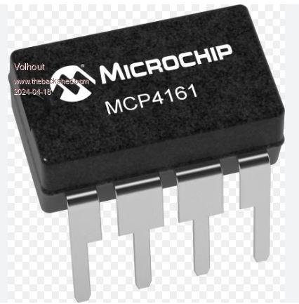

MCP4161
The ---- Digital non-volatile potmeter ----

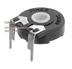

I think most of you know these parts:
They where used abundantly in analog electronics in the 80's.
Technical blabla:
For a project that requires a very low noise instrumentation amplifier, we needed to divert from the integrated instrumentation amplifiers, like TI INA111, and use lower (input current noise) separate amplifiers like TI OPA2188, or even better AD8572.
But that requires very accurate resitors. The commercially available (and economically viable) parts are 0.1% tolerance, and have below 15ppm temperature drift.
But 0.1% resistors give you only 60dB common mode rejection in the instrumentation amplifier. So additional tuning (to 0.01%) was needed. The idea was to use a potmeter. The manufacturing site did not like that (mechanical adjustment), so we opted for a digital potmeter.
The MCP4161 is a digital potmeter, that is NON-VOLATILE. You can adjust it in circuit, then disconnect the SPI bus from it, and it will keep the last settingprogrammed in EEPROM at each successive power up.

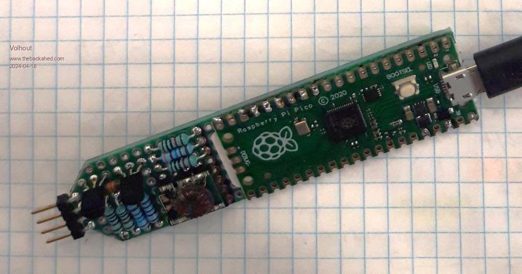

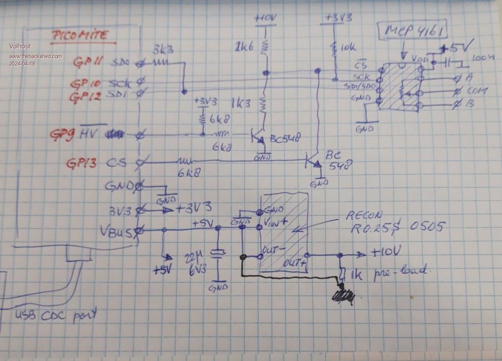

I worked out a circuit for a programmer (you need +10V to program the parts EEPROM) based on a picomite.
The ciruit was build on veroboard, and below photo shows the circuit before the shrink sleeve was put on it.
The picomite when attached to the PC will allow you to tune the potmeter with + and - buttons on the keyboard. Then write the current value into EEPROM with "w".

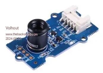

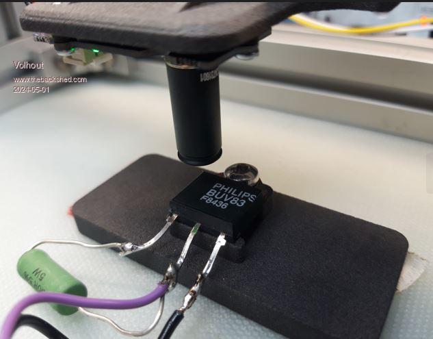

Thermal Camera's
This post contains 2 programs that can be used to read temperatures from Melexis thermal camera modules. The modules are from SEED STUDIO Grove series.
The camera's where selected to evaluate if small SMT resistors heating up can be detected in series production.
For this to be successfull you either need a thermal camera the good resulution (such as a Fluke TIS-45, which cost a fortune), of a camera which is small, and can be mounted close to the object under test. That camera should have a small opening ange to distinguish between one component and another.
MLX90614-DCI
A single pixel camera, with 5 degrees opening angele.
This camera outputs degrees K(Kelvin) on it's I2C bus. Attached program can be used to log 60 readings (1 second each) to a log file. Running on PicoMiteVGA.
A photo of the setup (measuring the component edge of a larger component).
The MMbasic program
MLX90614-DCI_V02.zip

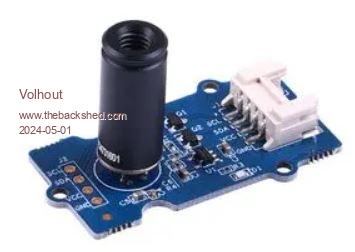

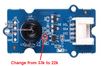

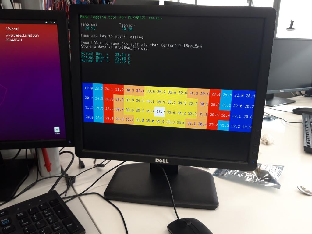

MLX90621-BAB
16x4 pixel camera with 60 degrees opening angel (around 4 degrees per pixel). This camera outputs raw voltage per pixel, and you need to read calibration constatnts from it's EEPROM, do a lot of math, to convert to degrees C. This math is included in the below MMBasic program.
The module I received from Farnell has a flaw. It powers the MLX90621 chip with 3.3V where the calibration data in EEPROM is for 2.6V operation (says datasheet). And indeed, reading where wrong. After modifying the module to 2.6V reading where far more accurate.
The MMBasic program does the same logging, and also shows the pixel temperatures on the VGA screen.
The MMBasic program
MLX90621_V03.zip
This code is made to "do the job". It is not perfect or formatted perfect. But can be used as an example of how to interface with these modules.
