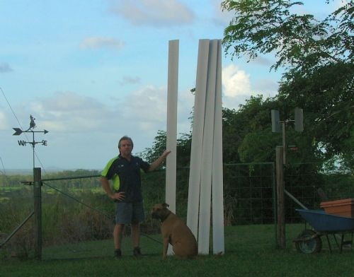

Hi guys.

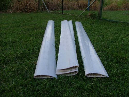

Well they have arived, my sample PVC blades. Cant wait for the weekend
These will soon be available for purchase at a very good price compared to other options. They should be cheaper than those extruded fibreglass blades, and if your timber challenged like me, a lot easier to put together.
Each lengh is 3 meters and weighs 4kg. Chord is 160mm
Exciting stuff.

Looks promising Glenn , has a price been set yet ? ...Will be interesting to see the hub arrangement you design and their performance , do you require your piclog back ?
Posted: 12:00am 25 Mar 2009
Hey Phill.
No price set yet, but the idea is they will be too cheap to not consider, even for the hard core timber blade fans.

Wow those pvc blades look scary be interesting to see how they will perform.

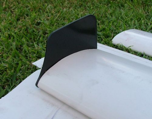

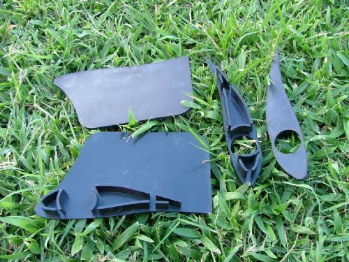

Those look really nice. I almost want a set for myself! (No I'm too far away in Canada)

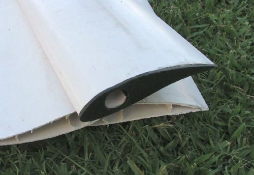

Do I see a closed cell in the trailing edge? That will help torsional stiffness. The biggest part of the torsional stiffness will still be the tube down the center and the end caps.
Very ambitious, adding a "plate" to the tip's end cap. I hope you have lots of spares because it will take a lot of testing to prove what works and by how much.

I'm going to fit a set to my dual stator windmill this weekend, 2.6m diameter. Standard 1 inch exhaust tube will fit up the middle of these blades, and for the first 400mm from center ( most stressed part of the blade ) I'll slide in a length of 22mm steel rod. The 22mm rod is a neat fit inside the exhaust tube. I'll buy these today and post some pics as it comes together. Will keep an eye on the weight as I go.

The 1 inch exhaust pipe is a standard size and has an internal diameter of 22.2mm. The 22mm rod is a neat fit, with a little grease it should work fine as a bearing in this application. A grease nipple could be soldered to the outer pipe and pumped full of grease every couple of years.
