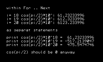

There is a funny result when calculating trigonometric functions using the cmm2. The results are not only not zero as expected but they differ when doing the calculation either within a for..next loop or step by step:
print "within For .. Next"
print
for i = 18 to 20
 print "i=";i,"cos(pi/2)*10^i";cos(pi/2)*10^i
next i
print
print "as separat statements"
print
print "print cos(pi/2)*10^18 =",cos(pi/2)*10^18
print "print cos(pi/2)*10^19 =",cos(pi/2)*10^19
print "print cos(pi/2)*10^20 =",cos(pi/2)*10^20
print
print "cos(pi/2) should be 0 anyway"
-andreas

I get cos(pi/2) to be 6.093216209e-17 on a PicoMite VGA running 5.0707. It's pretty small. :)

double precision math has about 16 digits of precision so all you are doing is exposing the limits of that precision by scaling the error component - nothing interesting or wrong

Why are the results for i = 19 and an explicit 19 not the same?
(And similarly for 20?)
Posts: 12040
Posted: 05:43pm 31 Dec 2023
Because it has added 1.0 each time and 3.0 cannot be exactly represented (amongst others)

The for loop is using floats because that is the default.
Try adding
OPTION DEFAULT integer
and the results for the loop and individual are the same.
Likewise, if you leave the for loop as floats and change the 18 19 and 20 to 18.0 19.0 20.0 the results are both derived from floats.
Posted: 09:47pm 31 Dec 2023
  TassyJim said  The for loop is using floats because that is the default.
Good point. You can also add DIM INTEGER i and get identical results.
