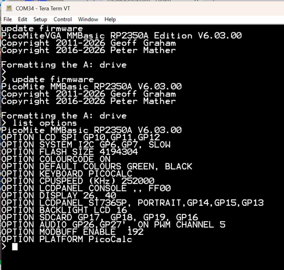

Do the following, if this doesn't work I'm beginning to suspect your PicoCalc is on the way out.
Load PicoMiteRP2350VGAV6.03.00.uf2
You should see it boot up as follows: then reload PicoMiteRP2350V6.03.00.uf2 and it should immediately re-confiure for the PicoCalc

Posted: 06:10pm 30 Jun 2026
On this PC, the terminal only works through the USB-C port. And that port isn't enabled by default yet.
Okay, I loaded universal_flash_nuke.uf2, then the USB version, and then the regular version.
I had to restart PicoCalc twice, then I saw the message "Formatting the A: drive," and when I entered "OPTION LIST", "OPTION PLATFORM PicoCalc" was displayed.
After a restart, the following message appeared again:
Invalid clock speed - reset to default
Frank
