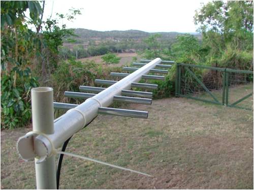

This might be a bit of handy info for anyone who like me uses a NextG modem for their internet access. I cant get ISDN or ADSL, Satellite is too expensive, so its NextG wireless for me.

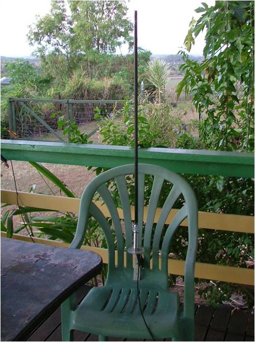

My NextG modem/router ( Bigpond 7.2 Home Network Gateway ) came with a little 3 inch aerial that screwed into the back of the router. Actually there are 3 aerials, one is the primary aerial, one as a axillary, and one for WiFi networking. Its also got 4 lan ports, not a bad bit of gear really, works great.
I'm about 30km from town and with the little aerial I was on 3 bars signal level, about half. The NextG network internet bandwidth depends on signal level, so better signal = better download speed. With this in mind I bought a high gain dipole "whip" aerial for $150. That improved the signal level to 4 bars, and there was a good improvement in internet speed. Its been clamped to a chair on my front patio for the last few years. I did have it on the roof but I was tired of unplugging it every time there was a electric storm in the area.
I was pretty happy with it, but a few days ago I stumbled across a web site where a amateur radio hobbyist built a yagi aerial for his NextG phone for when he goes camping.
This is the page I found...
http://www.perite.com/vk7jj/nextgyagi.html
I bought some 50ohm low loss coax, connector and a length of 10mm aluminum tube. I already had the PVC pipe. All up I spend about $50. I bought double the coax I needed, the girl behind the counter was cute and I forgot how much I needed . This is the result.
With the new yagi connected up, I get full signal strength, 5 bars . A speed test to Brisbane gave a ping of 167mS, a download speed of 1.44Mb/S and a upload speed of 0.84Mb/S. Thats pretty darn good!

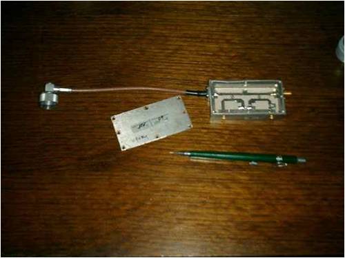

If you want to I can get you a little something with which you easily can build your own SWR bridge for antenna measurements - it'd help in tuning the antenna for optimum performance. The bridges I have (ex-telecom) were used in 900 MHz cell stations (0.1 dB insertion loss), but are usable up to 1300 MHz. Let me know if you want one - proper teflon print with stripline loops. Add a little meter and a potmeter and you can make accurate SWR measurements at those frequencies. Let me know if you're interested and will send two your way - no charge of course.

I think you made it harder (to connect it) by using a tubular boom, I think I'll try the PVC channel conduit as shown in the article, with the lid popped back on it should be rigid enough.

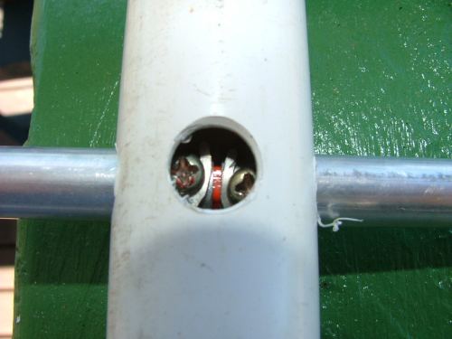

How are you attaching the driven elements inside a round tube?

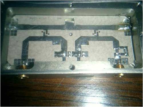

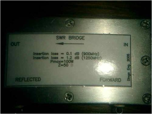

Looks like you (or someone) put in quite a bit of work optimising the directivity of those forward and reverse couplers!
Do you what the measured directivity is?

Dave, I don't know more measured results than what I put on the label - long story... :( I spent about an evening measuring it in any possible way with a friend who had borrowed a networkanalyzer from his work for the evening. I made only very few notes myself that evening, as the analyzer had storage capacity and could print very sexy graphs when hooked up to a PC. When the analyzer was returned to his work, another colleague used it and removed all data. ARGH! An entire evening gone to waste. All I know now about it is the insertion loss at those two frequencies. What I do recall was that it performed generally very well in all respects up to 1000 MHz, and very usable up to 1300 MHz (23cm band).
The optimizing was done by the original manufacturer by adding bits of foil, scraping away pads, making cuts, etc.etc. They didn't spare time or effort trying to get the best results out of it. Another reason why I generally love ex-telecom stuff.... built to high standards.

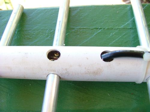

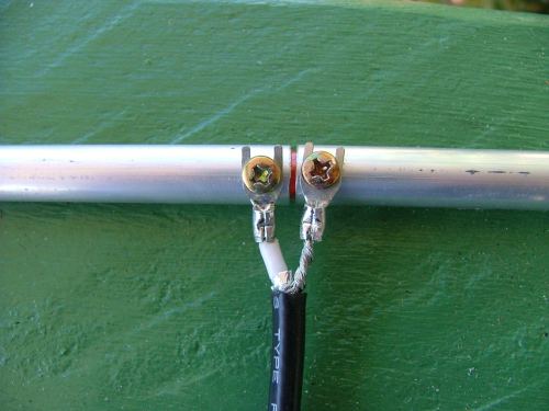

Here's how I attached the coax to the driven elements.
I used crimp connectors, soldered as well. Kept the exposed inner as short as possible, and the screw terminals as close to the inside ends of the driven elements as I could.
Underneath the PVC tube I had drilled a 12mm access hole. The way it worked is I slid in the driven elements from one side untill I can see the screw holes, and screwed down one terminal, then slide a bit further and screwed down the other terminal. The holes in the PVC were a neat fit around the 10mm aluminium tube, loose enough to slide the aluminium pape through with a little pressure, and tight enough that I dont need any glue. Yes, it was a fiddly job, like building a boat in a bottle, and I wished I had used a wood beam instead of trying to be smart and using PVC pipe cause it looked better.
But it did go together eventually.

I would have used solder eyelets under the screws, they are even smaller and perhaps more secure than the crimp spade terminals. I wonder why you choose to run the coax through another hole, why not run it past the reflector tube and out of the end of the PVC tube?
Edit: looking at your initial pics again I see why, you have the mounting pole at the end of the boom!Edited by Tinker 2009-09-20
