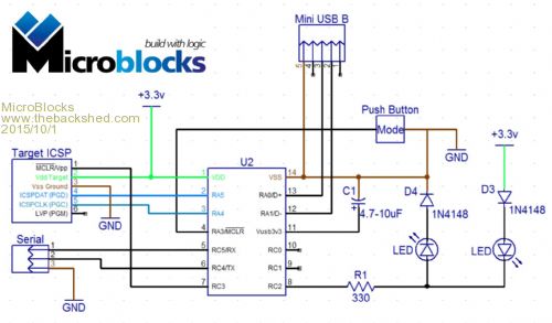

Posted: 06:02am 01 Oct 2015
Here is the promised schematics on how to connect the PIC with all the parts.
Not sure when the packages arrive but normally it is around 10-14 days.
The package containes a PIC16F1455 DIP, a pushbutton, 2 Red LEDs, 2 1N4148 diodes, 330 Ohm Resistor and a mini usb connector.
You will need a voltage regulator for making 3.3v, or a power supply that has that voltage available. Also a capacitor 4.7 to 10uF. A small breadboard and some wires.
The PIC is preprogrammed. If you have a micromite or other 'mite' with a serial console the you can test it right away.
If you want to program a PIC32 chip you will need to download pic32prog.exe. A thread about pic32prog is also on this forum and has links.
Schematic:
It will start in USBSerial mode. By pressing the button you can change the mode to PROGRAMMER, MONITOR, CONFIG and back to USBSERIAL.
The LED's will inform you which mode is active and it will also send a text with the mode to the USB.
I used a little trick to show 4 different states with 2 LEDs and only one pin on the pic.
The pin is either an output or an input. When it is in input mode then both LEDs are off. When the pin is configured as an output it can be LOW or HIGH. In both cases one of the LEDs will be on. The last mode is switching rapidly between LOW and HIGH which will light both LEDs at the same time.
The extra 1N4148 diodes are used top drop the voltage so that when the pin is in input mode the LEDs are off (or very very dim).
The 330 ohm resistor makes sure not to much current will go through the LEDs.

Posted: 06:18am 01 Oct 2015
@Chris, Sure. You should already have the previous version in your email. I will send the latest soon.
Here is a better version of the schematic as the forum software makes it a bit too small to read.

twofingers
Joined: 02/06/2014
Posts: 1782
Posted: 07:40am 01 Oct 2015
@MB
It is intended that you omit the voltage regulator?
(5V from USB1)
Michael
