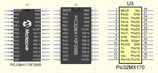

I recently discovered on the Dex Forum User MiR posted a PIC32MX170 SOIC part and he incorporated an IMAGE into the schematic which IMHO made the Schematic look much better.. See this example. He provided 2 parts with slightly different images.
This is two images of the same part next to my standard PIC32MX170 - SSOP
The parts themselves are attached here:
2016-06-02_071026_PIC32MX170B_With_Images.zip
EDIT *** The images got compressed by TBS so I have attached them in this ZIP
2016-06-02_071429_PICs.zip

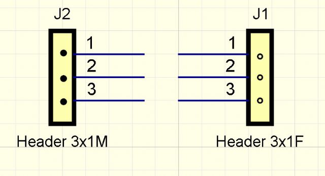

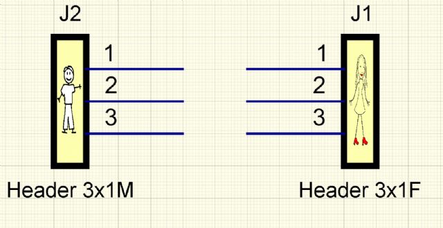

I have managed to follow your manual and got your headers onto a pcb and viewed this in 3D. The 3D is impressive, I thought I had left pcb work behind, but not just yet now.
It ocurred to me that headers shown in schematic does not show visual male/female nor right/left description.
I can visualise the straight headers showing male with a dot per pin inside the rectangular outline. I do not know enough to edit a part to show example yet.
Similar for female a circle per pin inside the rectangular area.
Right angle headers, hmmmm do not have an instant idea desriptor.

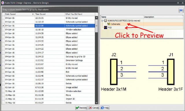

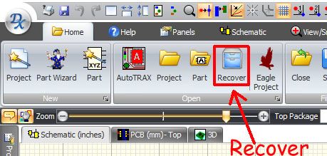

On the HOME menu there is a button called RECOVER
This will bring up a list of all of the automatic system saves (DEX saves EVERY change you do to your project) for those times where you have done something wrong and just can't see an easy way to fix it.. Just browse your recent saves and revert back to an earlier time where you were happy with your project.
Don't worry if you realise you have gone back too far your `later' saves are still there..
By clicking Restore you get a pop up that allows you to click on the PCB or Schematic to get a preview of the project before clicking the Restore button (at the bottom of the panel) to bring up your earlier version.
NOTE! Currently the save time appears to show GMT times and not local times.. I have reported this to Iliya and hopefully that will be addressed soon.

Yes you can add any symbols that you like in your parts..
The following is just adding a few dots (solid for Male and hollow for Female)
Of course with the ADD-IMAGE facility you can add whatever image you like.

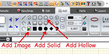

These are all done with the ADD key tab.. I used the Solid circle for the male, hollow circle for the female and Image for the mini pictures.

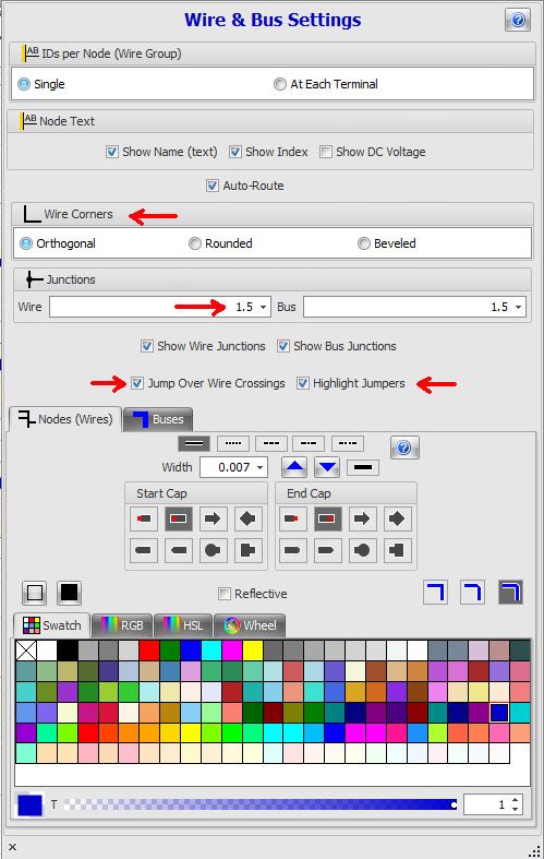

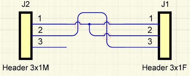

By expanding the WIRES tab (bottom right hand corner) in the Schematic tool bar you can bring up a list of property options for wires and jumpers.
I selected ROUND wire corners, Jump over wire crossings and Highlight jumpers and my schematic now looks like this.
TBS compresses the images so I suggest you have a play and see what you prefer for your wires.
You can also set the `global' wire/node colours, wire widths and other styles

Hi Plover,
Hold Ctrl down and the elipse snaps to a circle.
Once your circle is drawn just drag it to the location you want, experiment with the snap grid settings on the top (middle) tool bar.
Also if you want you can change the colour of the outline and the inner fill by clicking on the boxes just to the right of the shapes menu.. currently it is set for BLACK outline and GREY fill.
Of course if you load a part and edit it to put what ever marker you chose you can then save that part away and it will bring in your markings with it.
Kind Regards,

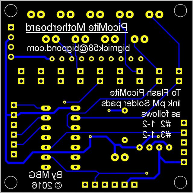

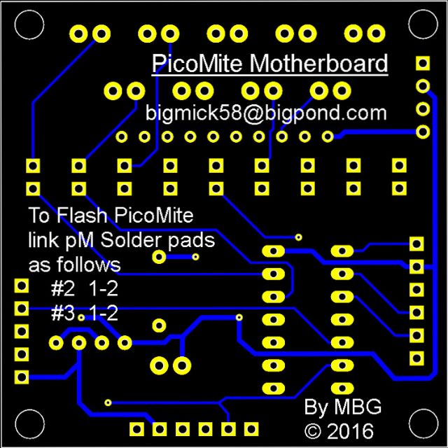

DEX normally shows all the layers viewed from the TOP so when you add text to the bottom silkscreen it will look something like this:
Now whilst you can work out what it says it isn't quite the same as seeing the board (of course you can view the 3D and see it) but there is a little icon hidden away on the right hand side of the PCB key tab called `View From' that will allow you to view from the BOTTOM side of the board..
This will reveal something like this.
Yes this is one of my latest two boards, currently in production, I will have in approximately one month.
