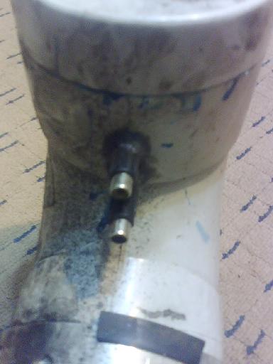

it is possible, but i made the unit from pvc should of used a stainless cannister, the water in the unit got quite hot and i found the pvc warped. the unit was kept under controle using a washing machine water level switch, which swithced off the power via a relay when the preasure inside the hydrogen unit rose too high. overunity wont happen but as a booster there definatly is potential, the ideat of using a f&p for the power has its faults, driving off tailshaft or wheels only produces loading of drivetrain therefor no gain to efficiency, using a small vawt like the a/c in some vehicles merit more investigation.
and yes the 20amps on the alternator also loads motor but i did get better ecconomy.
as the hydrogen is used as it is made storage isnt an issue and i advise using flashback arrestors or a bubbler befor the intake.

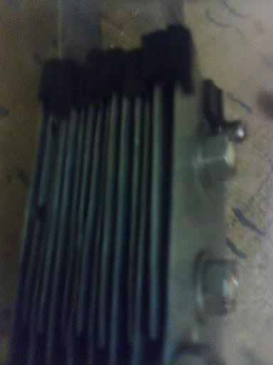

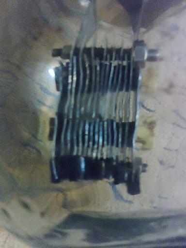

my last running unit used 15 off 1.2mm stainless steel plate about 5 inches by 3 inches set in a negative positive neg pos etc arangement about 2mm apart, you can use an electrolite but dont use salt water as it produces sodium cloride gass(i think thats the name of it) very poisenouse.
use baking soda or caustic soda i prefer the first. measure the hho produced by bubbling into a upside down plastic bottle submergen in a bucket of water and measure the displacement for liters per minute.
i will try to get some pics of unit set up in test enviroment soon if you would like to see it, there is other arangements people use including neutral plates.

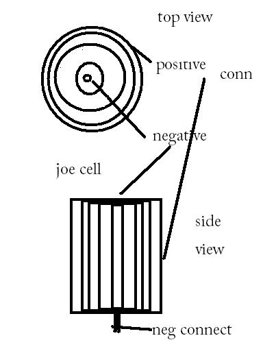

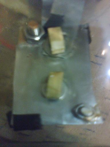

yes cnc pro plates do corode i think the negative erodes whilst the positive builds up thats due to the transfer ions affect, but the general guide is the thinner the plates the better the production of gas, the joe cell uses 5 or 6 concentric rings of stainless steel assembled together as one cylinder and spaced apart by rubber spaces one solid s/s bolt through the center as a negative the positive on the external ring.
sory about the drawing
the steel must be 316 stainless about 2 mm thick, and the unit must be seeded through 4 stages.
the water / soda was about 3 table spoons to a liter but the best way is to see the amps drawn with clean water then add soda slowly as the amps rise quickly with a electrolite, you want to use as less amps as posible for max output of gas try to find the best combo but it varies depending on salts etc in the water suply, i usualy start with distilled water as bottled water contains salts.

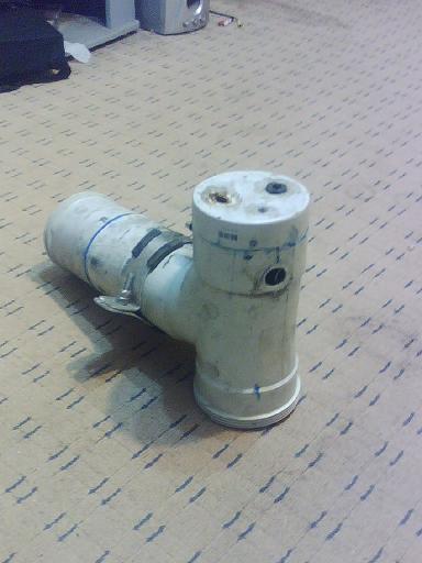

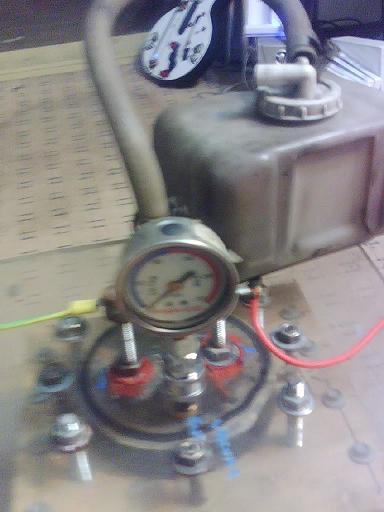

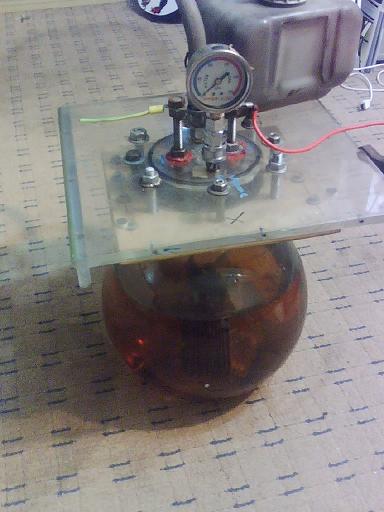

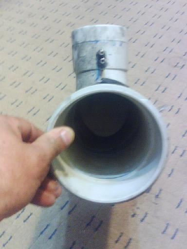

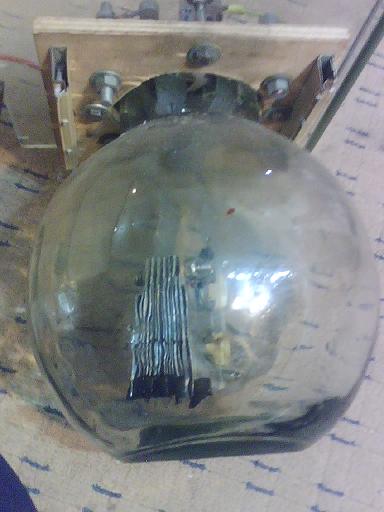

here is some pics of the old unit and test setup
this is the cell i will remove tomorow for a better pic
and the old unit i used in the pajero
the jacks in the side was for a water level sensor
thanks for the interest
