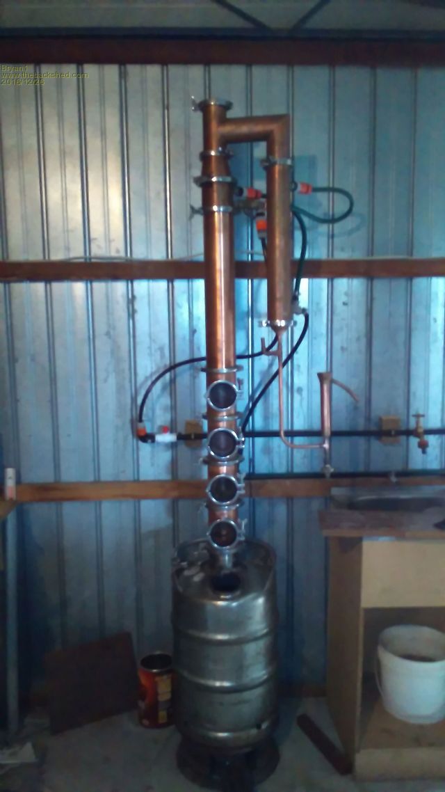

Yea I was tempted to put up a pic of my 2" SS pot still doing a Ouzo run, also good for making distilled water of course. But don't want to get in trouble so thought best to leave it

Bryan1
Joined: 22/02/2006
Posts: 2297
Posted: 06:18pm 25 Dec 2016
G'day Guy's,
Well not sure how long my deluxe water distilling appliance will stay up but here it is...
