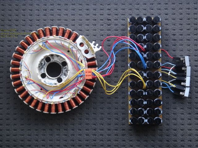

Have been doing some research into the possibility of have a form of automatic electronic braking in high winds.
There has been a lot of previous discussion of F&P stators operating above 500 RPM the core becomes saturated with the torque curve dropping off. With furling set up correctly this can keep things under reasonable control. In very stormy conditions this may not all work out so well so some form of braking should be considered.

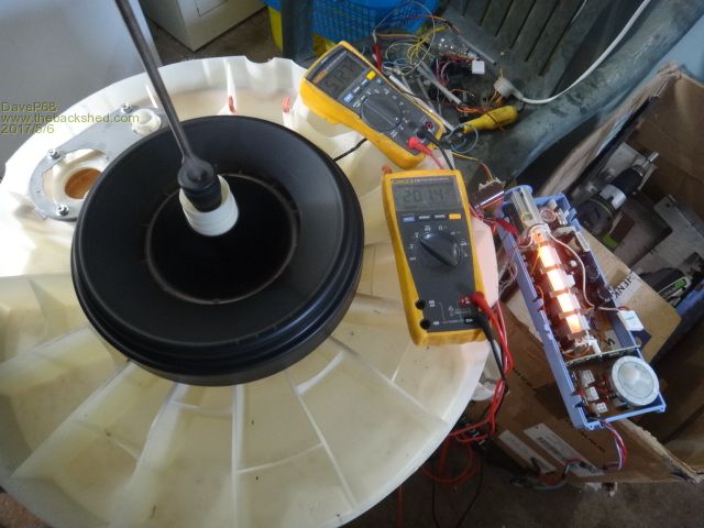

F&P washing machines made between 1993 and 1998 had a 300 W peak rated dynamic brake function. A safety feature used if a lid was opened at max spin of 1000 RPM it could bring a load of bowl + clothes 20 kg's max to a stop in less than 4 seconds. They type of stator used was the 80s on all those machines.
For a day job I repair these boards and need to activate this function as part testing the motor control module.
Here is a photo of a modified module used as a load at 900 RPM 1000 W of energy being extracted from the stator.
The proposal I have is to use a capacitor doubler to extract maximum current out of the stator before the core becomes saturated. The trick is to extract maximum power from say 2 stators on the same shaft when a peak RPM is reached. If more power is taken from the shaft than the blades can deliver we go into a lower TSR range. That way a controlled shut down can be done before the wind gets too strong.
This requires some fine tuning in terms of a workable system, but from some testing I've done with one stator it should be possible.
With this separate cap doubler (one for each stator) is used for braking only when running in over drive mode on a 36 pole 4x 3p Delta I get 72 VDC 16.4 Amps 1.18 kW @ 550 RPM. Thing is the shaft power required to drive the stator is >2 kW. That is from just 1 stator! This same stator when not used in braking mode would normally be charging a 48 VDC battery system. The same system can be set up for a 6x 2p Delta, with the brake operating at 48 VDC 24.6 Amps peak at brake application.
Taking more power from the shaft than it can deliver will push the blades into stall region slowing them down by dropping the TSR to below 5. The maximum current and voltages of course would reduce and have to be carefully controlled to slow the blades down.
This way the blades can brought to almost stopped state (tuning slowly if wind is strong enough) if set up correctly. The brake would release when the stormy conditions have passed so to speak. Yes you would not be making power while storm passes but wind turbine stays safe
This is only in a concept form at present so no working system yet.

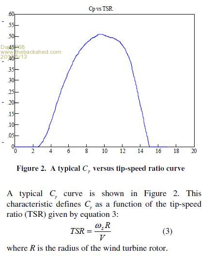

I hold a pilots licence which means I understand stall condition very well, if I didn't could have killed myself and my passengers. I formally worked in aviation sector which gives me a bit of understanding of this stuff.
There is practically no difference between the amount of lift that a wing "generates" and the amount of power blades can feed into a shaft. This is shown at the top of "that nice curve" above. Stall condition once it's reached (not desirable in an aircraft) is exactly what we want to use to bring the blades electrically under control.
When the RPM is under control (below 100 RPM in stalled condition) the current in the stators will be at a manageable level, so no excessive heating of those small coils!
Like I said above your idea does have lots of merit and I like it Please also consider I have put good amount thought put into a concept before it is published.

You read my mind. Yes already have the basic circuit which currently works in the voltage trigger mode (40 - 480 VDC). Just need to use a spare LM393 op amp on the boards I have to amplify the small voltage across a current sense resistor. This can then be put into the same variable value comparator input that I currently use for the voltage trigger point. This circuit works by as you say by the same hysteric controlled PWM.
That Blue coloured board in the photo has all the parts on it to perform this function. Just need to make the resistor a lower value and make sure the IGBT device can handle the peak current. The current sense resistor will need to be about 0.01 ohms and rated at 10 W.
What do you think?

You may need a fairly decent electrolytic across the dc bus to minimize the worst of the wild voltage swings, as the load comes on and off, but that is the general idea.
Only way you could do much better than that at lower rpm, would be to energise the original F&P motor drive fets to slow astern. I have no real idea how an F&P actually does all this, even though I have one in the laundry. Its never missed a beat so I have never had the covers off.
Cheers,  Tony.

Have been thinking of doing some more work on this Electronic Dynamic braking and I think you're idea to energise the stator is great to get the RPM down to a minimum amount. This can be done by firing an opposing waveform back into the stator. This can be a closed loop controlled system by making use of the RPS unit (Rotor Position Sensor) that sits on the side of the stator.
Refer to the white device that is sitting at the 2 o'clock position on the stator in the above photo. In this setup it's only going to be used to measure the exact operating RPM of this stator.
