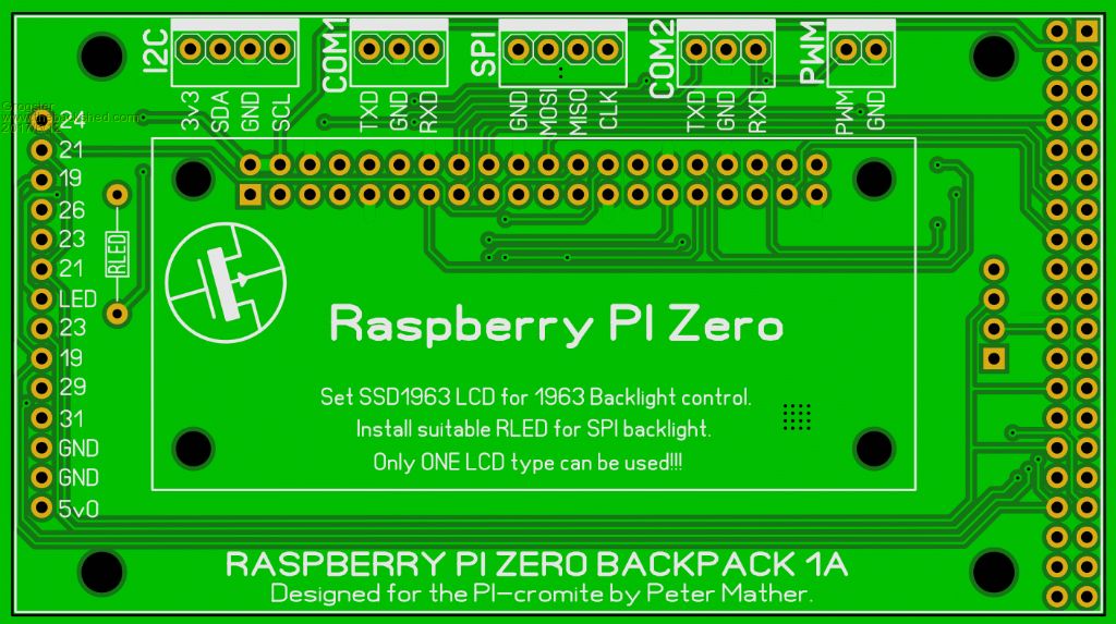

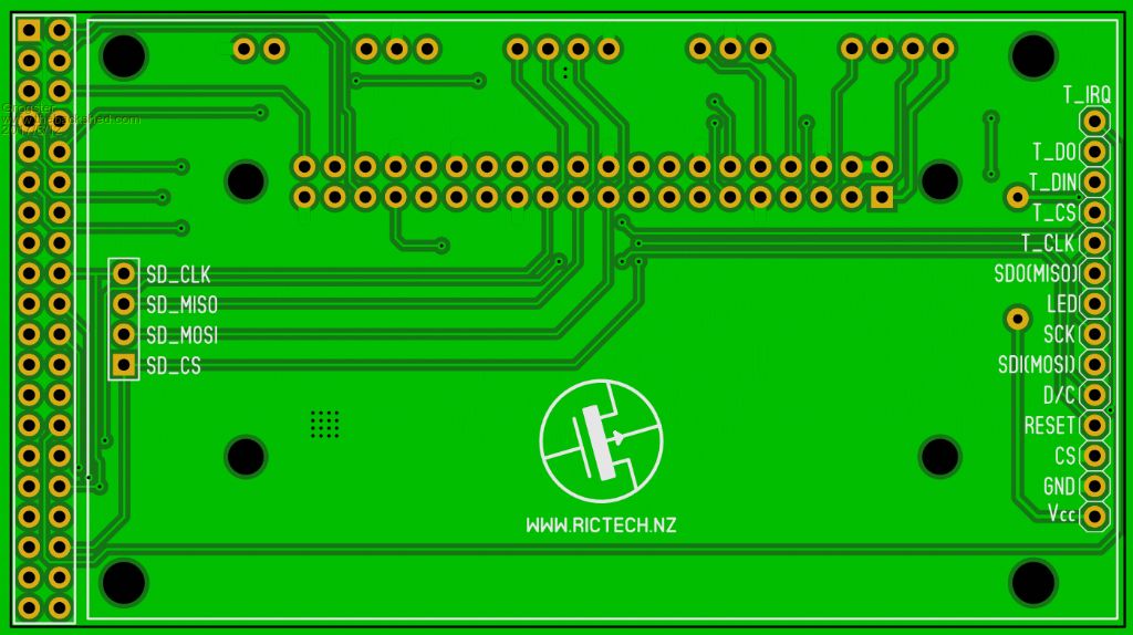

Posts: 10070
Posted: 11:29pm 11 Jun 2017
Well, here you go led-bloon:
Will that do?
EDIT - Forgot to mention:
SPI LCD D/C = Pin 29
SPI LCD RST = Pin 31 (same as 1963)
TOUCH CS = Pin 26
TOUCH IRQ = Pin 24
SD CS = Pin 33
1963 RD = Pin 36
H/W PWM = Pin 12
All other pins are as already stated. You can use either a 2.8" SPI LCD with touch, or ANY supported SSD1963 LCD with SPI touch and SD card. For the latter, you don't fit the SPI LCD, and instead plug the PI-zero board directly onto the pin-header on the 1963 LCD module of choice. You would need some self-adhesive PCB supports for the arse-end of the PI-zero board, to stop it flapping around on the LCD header, but that is dead-easy to do.Edited by Grogster 2017-06-13

led-bloon
Joined: 21/12/2014
Posts: 210
Posted: 12:43am 14 Jun 2017
@Grogs very nice .. but does it come in red?
@Mick - all I can say is that the displays are relatively cheap (ILI9341
& SSD1963) and the code is written for them .. sounds pretty good to me.
@Matherp - BIG thanks
Miss you George
Posted: 01:05am 14 Jun 2017
Hi Led-bloon, All,
Whilst the ILI9341 are relatively cheap you also have to factor in the price of the adapter board and connectors and components, then the fact is it adds an extra 12mm to 20mm at least to the height due to a 3 level stack.. is it worth doing?
I don't want to sway you away from this project, I instead prefer to think that I am offering an opportunity to take a closer look at your design idea before you commit to a production run..
If After all you want to go down that path, great.. I may even buy one. But I think it isn't an ideal outcome, especially due to the added height... you need female/male headers between the Pi and adapter AND between adapter and display, although you could direct solder to the display..
Posts: 10070
Posted: 03:10am 14 Jun 2017
You have exactly the same arrangement on the E100 boards, if you use ANY click module - a three PCB stack consisting of the LCD, the E100, and the Click module.
I don't see that as any big deal, frankly. That's just me though. Obviously you Aussies have a hard time with stacking stuff up - we kiwi's are much better at stacking then you guys seem to feel comfortable with....
Also, remember that the LCD's you can get for the PI, take up the whole damn GPIO port header, and it is difficult or impossible to get extra connections on to the unused GPIO pins once you plug one of those LCD displays onto the PI.
Hell, the PI-zero is so bloody cheap, there is no reason why you could not permanently mount the PI on the backpack board, so it essentially becomes permanent, dropping you back down to a two-board stack - or 2.5 board stack, if you want to look at it that way...
@ led-bloon - default is green, but YES they could be ordered in red!
led-bloon
Joined: 21/12/2014
Posts: 210
Posted: 02:18pm 14 Jun 2017
Just checking the pins in use now .. would like to see any
pins not connected going to a row of vias for future connection
(possibly at the bottom of the board?)
Also, any room for a "click" board adapter area?
Miss you George
led-bloon
Joined: 21/12/2014
Posts: 210
Posted: 02:43pm 14 Jun 2017
@Grogs
You have directly connected the CS of both LCDs to ground.
The SPI LCDs should use an output pin from the pi for CS
(not sure if SSD LCD should have a separate CS too)
Otherwise it will clash when selecting touch/SD card or anything
else on the SPI bus
Edit: My bad - NO unconnected pinsEdited by led-bloon 2017-06-16
Miss you George
Posts: 10070
Posted: 03:23pm 14 Jun 2017
You are correct about the SPI LCD CS - My mistake - will fix. 1963 LCD CS is grounded, as you will always be using that LCD if it is installed at all, but I made a boo-boo with the SPI LCD CS.
I don't think there is room for a Click socket - I will look and see, but the entire bottom edge of the PI module has to be kept clear for connectors on the PI module, so you can't put anything there, which pretty much.....

Posted: 07:20pm 14 Jun 2017
Grogs
The SPI Header at the top of the board is pretty much wasted
as it has no CS output. Could I suggest increase header to
5 pins & using COM2 TxD doubling up as offboard SPI CS?
At least COM2 RxD could still be used for logging on a serial
line say.
I would probably mount the Pi Zero between the PCB and
the SPI LCD display (albeit upside down) and soldered in, with
adequate spacing for connectors.
I think too much to ask for a re-design or second version.
Using SPI LCD additional (spare) GPIO pins are available at the
SSD LCD header .
SSD LCD there are no spares available, but COM2/PWM/I2C can be
re-deployed.
