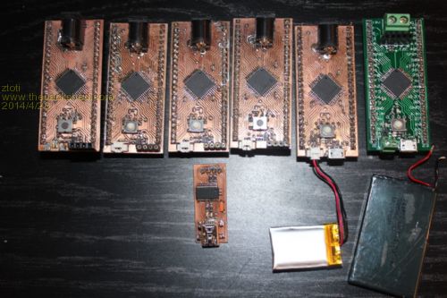

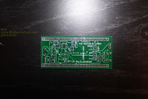

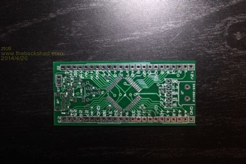

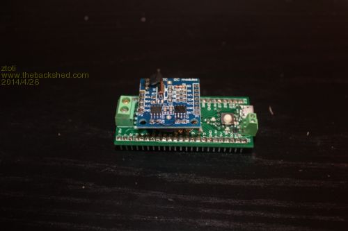

In past two months I made 6 version of Micromite (44pin) and here is final version how I see the Maximite.

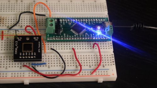

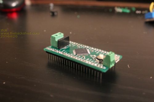

This is breadbord friendly adapter with couple DC inputs: 12V, 5V, 3.3V, LiIon battery, microUSB. The power module is switching DC/DC converter from 12 to 5V, plus linear regulator to 3.3v.
Maximite will run from any of those DC source with no complain.
LiIon battery is charging from USB or 12V and there is LED to indicate the charging.
USB to serial converter with FT232 chip is onboard, with microUSB connector and Rx/Tx leds.
The 4th LED is connected to pin 13 (like Arduino) and I use for some indications or debuging.
Two terminal block are for 12V DC and LiIon battery.
Also on the board is 5pin female connector for I2C units, designed to be pin compatible with RTC module from EBay:
http://www.ebay.com/itm/Arduino-I2C-RTC-DS1307-AT24C32-Real- Time-Clock-Module-For-AVR-ARM-PIC-SMD-/170910326110?pt=LH_De faultDomain_0&hash=item27cb0c9d5e
This module has RTC chip on it (DS1307), EEPROM (24c32), battery, place for temperature sensor DS18B20 and the price is just $1.22.
I've posted on youtube demonstration with this module, how to use in meteostation with data log.
Please check the video:
https://www.youtube.com/watch?v=Wf68_EPhNDI

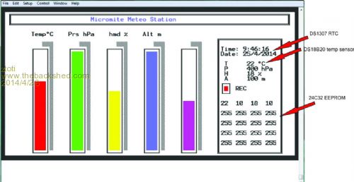

Here is screenshot for meteostation:
