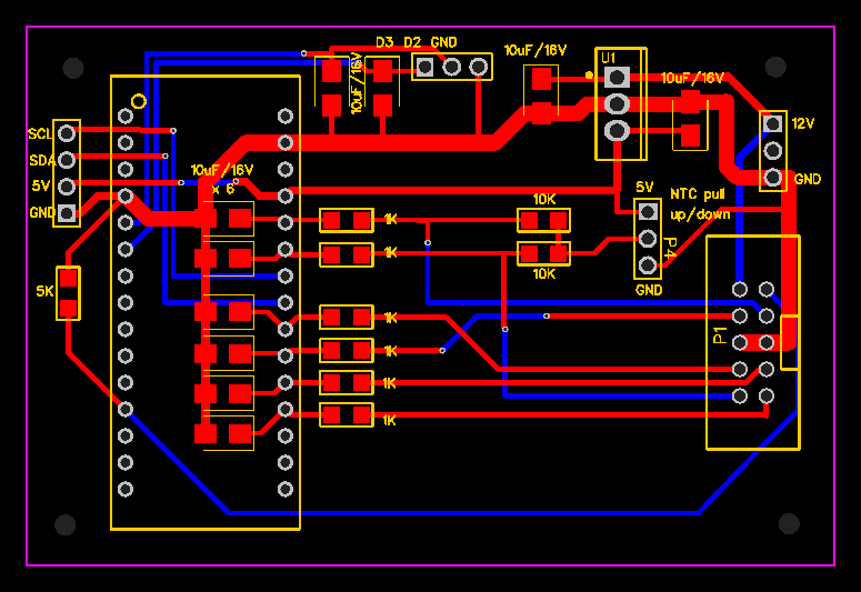

The brainboard nearing completion.
Added:
I2C header, compatible with the nanoverter pinout, for a LCD.
This could be repurposed to become the output for another serial data port
to talk to the LCD should I2C bring too many EMI issues.
Pull up/down jumper for the 10K resistors used with the NTC thermistors
10uF filter caps to clamp down on noise for the 2 digital input/outputs, one of which will be used for the EQ start/stop bushbutton. Maybe 1uF caps would be better. I will try it and see.
I expect to control and obtain data from the board using the USB serial terminal.
This will be a permanent fitting when I build and install it in my home system.
The Raspberry Pi will be able to get the running data whenever needed, such as output power, total energy, volts and current...I probably won't use the LCD much.
I probably will end up with a home system running 2 of these mppt controllers and the nanoverter/Madness 6kW power board inverter. All home built. The data logging, system control and web interface all written by me. (I'm not trying to impress, just noting what has been/will be done..) And remember folks, each and every solar panel we put on the roof causes Angus Taylor to shed another tear. That is why I do it.

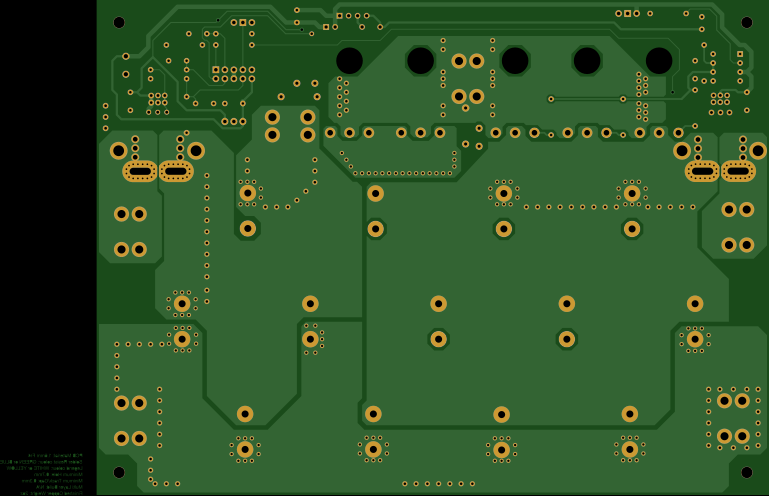

It's time to order some of Mike's (Wiseguy) improved design PCBs.
JCLPCB cost is $7 plus delivery (about $40 for 10 boards)
Anybody here want a board or two?
I will be making an order for 10 boards at least. I want 2 or 3, Mike wants 2
Mark will want a couple...
I will do it the same way I did with the nanoverter boards. Just recover cost.

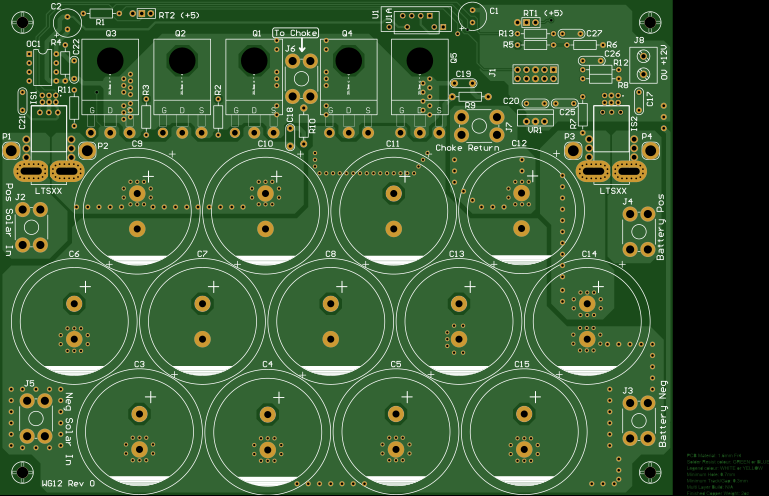

This is what they look like:
No SMD parts this time so it's old bloke friendly.
It is optional to fit the 3rd MOSFET switch, 2 is good enough.
The cost of parts to build this is about
2 x $7 - MOSFETs
2 x $7 - MOSFET as diodes
2 x $10 current sensors
1 x $10 dc-dc isolated converter
13 x $4.40 470uF 200V caps
and minor stuff

Clarification required - there are 3 types of current sensors currently provided for.
It was the high current external connectors (6 required) that need to accommodate the 40+Amps for input / output / choke connectors that I was going to ask about.  if so I need the details (type & pinout) today asap
Is there an alternative connector anyone wants me to consider apart from the 4 pin ones that I chose ? They are ~$5 for 20 from aliexpress - I will be posting again shortly with extra details for anyone that wants to get stuff ordered on the slow boat from china.
Cheers Mike
wiseguy
Joined: 21/06/2018
Posts: 1326
Posted: 12:53am 17 May 2020
Some Notes on the PCB.
The high current screw connectors are available new from:
https://www.aliexpress.com/item/32811408567.html?spm=a2g0s.9042311.0.0.63784c4dRK1EiS
There are 20 in a "lot" for around $4.70.  Shipping for 1 lot is $2.72 and wait up to ~50 days.  If you pay ~$8.30 for EMS epacket the wait is 13 to 20 days.
If there is a suggestion for a different (In OUT) connector & footprint details (~40A!) there is still time for it to be included but be quick.
The board will accommodate 3 types of DC/DC converter, pinouts of SPU01 Meanwell, RP1212 Recom and IE1212 Xp or TME1212 Traco.
The current sensors that could be used are ACS758, LTS25-NP or LTSR25-NP types ( the 4th "R" pin needs to be cut off ) perhaps there are others also.
Cheers Mike
