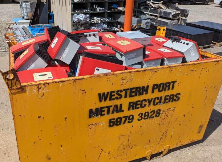

I found an image of the mother lode but I dont know where it is sniff...
I just found the company, www.westernportmetalrecyclers.com.au  (who would have guessed lol) maybe its worth a call next week ?

That picture makes me cry - A solar installer told me of the hundreds they literately threw in the tip over the past few years from school upgrades, these older SMA are getting as rare as hens teeth, and some people are still asking hundreds of dollars for one - crazy.

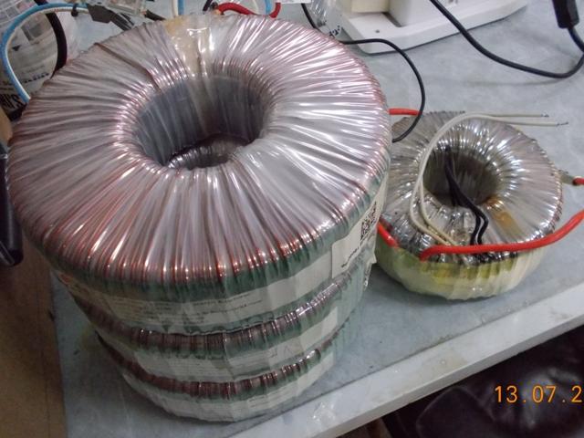

Cpoc I have run close to 8kW for 20 minutes on the current inverter, these 3 stack toroids are good for about 5kW sustained running with some toriod cooling, I almost never have that load level, but I do have short high peak demands.
With two of these 3-stack transformers and two power stages there is no doubt that it will run at 15kW, but not for long (toriod heat), but 8kW - 10kW should be a walk in the park, and way more than I would ever need.
You larger Toroids, combined with a slightly heaver output winding should have no trouble with 6kw for one set - 12kW should be easy.
The power limit really comes down to connection quality and loss (heat), you seem to have that fully under control and know exactly what you are doing from what I've seen in your posts, so keeping the Toroids and chokes at a reasonable temperature is likely the only limiting factor.
EDIT Removing center plug: I have a large tool socket the fits in the center hole, I support the Toroid on four blocks of timber on a concrete floor, use a small sledge hammer to hit the center plug out. It really sticks to the wrapping tape, I haven't tried cutting the wrapping with a Stanley knife first, I think it would come away easier if I did, about 6 hard blows usually gets it moving. I might try cutting the tape and removing one of these new cores today.

I was correct about cutting the Mylar tape first, I also use a chisel to cut/break off the green plastic base plate, this allows two pieces of timber to sit closer to the plug and fully under the windings on the under side of the toriod.
Only 1 medium strength hit with a "very small" sledge hammer and it popped straight out, the Mylar warp compressed between the windings and glued to the center plug is the only thing holding it in.
So easy, and to think that I bashed the living sh*t out of the first three to get them out

  KeepIS said  I was correct about cutting the Mylar tape first, I also use a chisel to cut/break off the green plastic base plate them out
No need to remove the green plastic, two pieces of timber against the plastic, not fully under the Toriod, one hit and it just popped out after scoring the Mylar tape.
Tried one without first cutting the tape and 4 big hits later, not moving, cut tape, one hit and it popped out. All 3 are done.
A 1.2kw toroid next to the 3 for comparison, plugs are gone.
