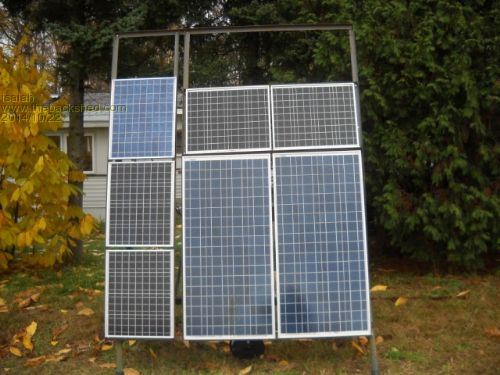

Bubs solar what we did is take most of his panels and put them on one rack.
Now he has to get them wired before snow flies . Ill; try and get a picture of it.

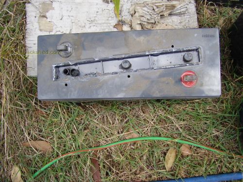

I tried to pry the valve chamber off but it was bonded on so I chopped it off with a hammer and chisel and completely buggered it, but at least I got access to the individual cells, this was on one of the wrecked batteries, so I decided to drill holes through the top of the case as a better move. I drilled 3/16 holes in the top of each cell and I will plug them with a piece of 3/16 O ring material when I have finished.
Based on the loss formula I come to the conclusion that it would take 50 CC of distilled water per cell, so I have them on an equalization charge at 32 volts per four batteries, and am adding 10 CC at a time to each cell doing it slowly to allow time for the water to soak into the cell pack, so far so good, I can actually see down through the little hole and see the water sitting on top of the permeable membrane so when that disappears I add another 10 CC, so far so good. I am getting a slight gassing from all cells. When I started the voltage went up to 33.5 volts, now after 2 days it has dropped to 31.5 across all the 5 battery packs, indicating I believe that the batteries are taking a charge better now. I will check each battery for even voltages tomorrow to see if there are any low ones. So far I have put 30 CC in each cell and it has all soaked through the permeable membrane, so I will have to go to town and get some more distilled water.
Based in the condition of the plates in the wrecked batteries there should be plenty of life left in them, that is the ones with some moisture in them not the dried out ones as the outer bars of the cell pack are badly corroded, but even so the inner parts are not to bad, if the case hadn't split open I think they are usable, but now will end up as fishing sinkers. It looks like a pure lead battery isn't as susceptible to corrosion as some of the alloyed cell plate grids.

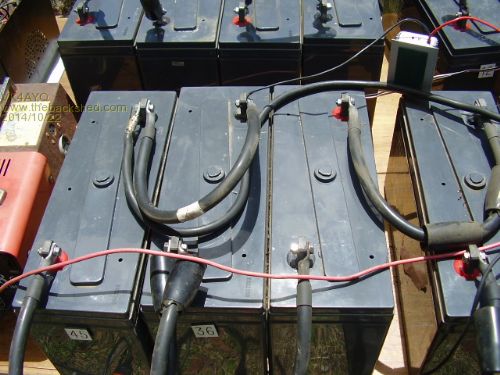

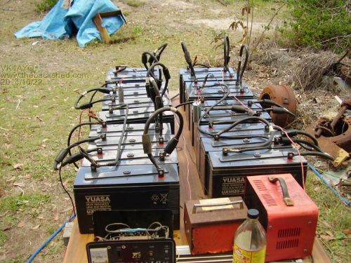

This is the collection of batteries that I think I can save there is 24 of them connected in series parallel for 24 volt nominal.
This is the valve chamber on the battery that I chiseled off to see if I could do anything with them.

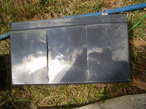

Here is the burst case where the sulphation built up on the end of the plates, this cell was still working with residual moisture in the middle of the plate pack but was not salvageable.

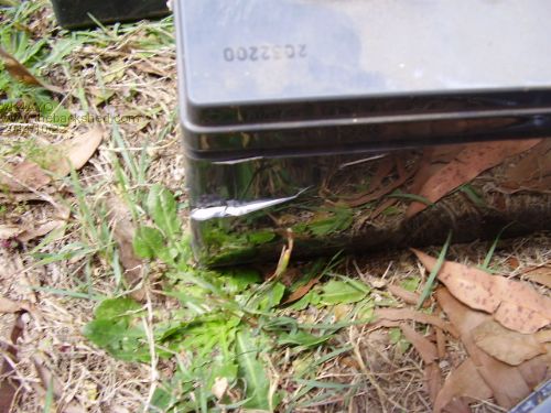

Looking from the side of the battery you can see the split case where the sulphation had built up.
If you look closley you can see the 3/16" holes I drilled through the top pf the case to get water into the cell packs that had not ruptured.

There are four of the five batteries that still work showing 6.5 volts although they are split so I will take your suggestion and try to save them, I am going shopping tomorrow so will get a tube of silicone and seal up the splits and make them into a separate 24 volt 125 AH pack.
I was thinking along these lines before but have been so busy trying to save the un split ones that I ignored the possibility of saving these ones, because they are absorbed matt cells the electrolyte is still in them as damp in the matt and sulfate around the edges so if I can seal them up and slowly reconstitute the sulfate there may be a chance of making something useful.

We have used liquid tape the 3 m kind to seal leaks up in battery's.
You might want to make a drill template to drill those holes.
If I can get it up loaded I have a picture of Bub's solar rack. we just took panels he already had and put them all on one rack.
In our area one needs both wind and solar .
We still have room for some more panels.

Bub's solar array looks like a good start but it will need to grow to produce useful power. Try to save up to buy one panel each month and they will soon build into a worthwhile array.

You might want to use a heat gun to warp some of those cases back where they were they heaved . Or cut a patch out of a junk battery and glue it in.
I used my big electric soldering iron on one and used some scrap plastic to close the hole. just about liker soldering only use plastic.

The heat gun was a moderate success I managed to salvage four more cases that where holding 6.5 volts per battery, the plastic gave me some trouble as when I put the heat on it it bubbled up and became porous so had to smooth it around with a screwdriver, it doesn't look neat but so far it is holding, I think I will coat it with some epoxy that is used for sealing fuel tanks in planes in case the porous parts leak later on.
So far I have got the whole bank up to 31,5 volts and am aiming for 32 volts, I will hold at that for a week to fully equalize the cells, there is some slight gassing at the moment but as I can now add more water that's not a problem, so far I have added 6 liters of distilled water and it will be more by the time it's finished equalizing.
While that is sitting bubbling I will have a go at some alum batteries.
