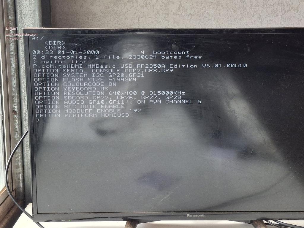

Ok picked up the package this afternoon and got everything down to the house shed and found I had to switch the TV to HDMI input, well that got the screen going nicely.
I had hooked up a USB keyboard that worked on my CMM2 only to find it won't work so went back up to the shed to look for more and only had PS2 keyboards so used the PS2/USB dongle and found the same.
Now at first the device manager said serial device with no driver and on pressing the reset button on the pico2 fixed it and assigned it to COM12.
I fired up teraterm and couldn't get anything typed in as a block was just flashing so tried MMCC and as the screen shot shows I typed list in the type box above as no input was working below and the output is shown on the TV
So not sure what is going on and in the corner by the USB outlets a red led is lit so that may be a clue

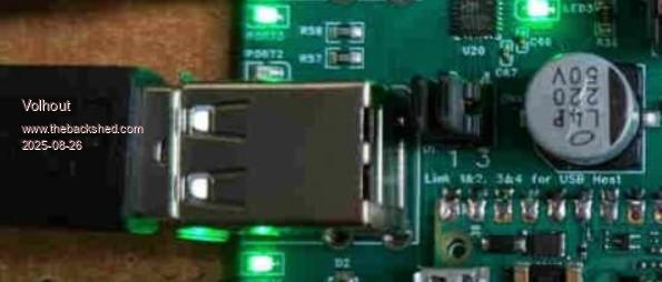

H Bryan,
I have had PS2-USB convertor that just was a connector change. So although it connects to a USB connector, under water is is still a PS2 keyboard. If that is the case, then this won't work for you, since this pico needs a genuine USB keyboard (the convertor  works for the CMM2 though, CMM2 expects a PS2 mouse that connects through USB).
So a genuine USB keyboard is needed.
For the COM port, make sure you select 115200 baud. Check if you have below jumpers installed on your board.
Edited 2025-08-26 18:47 by Volhout

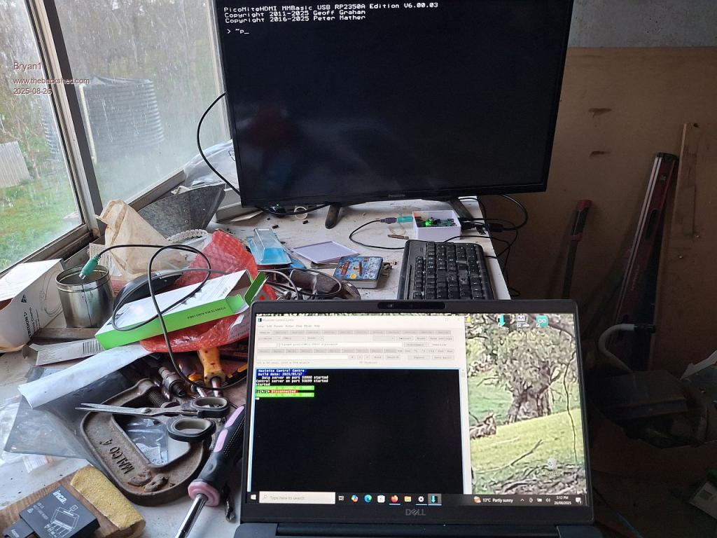

Posted: 09:22am 26 Aug 2025
HI Harm switching to 115200 in MMCC did the job on the console and when I typed list Gerry had put bubble universe on so typed run and the program worked
My USB keyboard is an old IBM one and no luck getting it going so tomorrow I will go buy a new one along with a new mouse then the fun can begin with the File Manager and my MP3 collection so I can sort out each band into it's own folder then workout which Bacoben songs I lost.
As you can see in the photo it was 4.30pm when I set everything up so a big cleanup is on the cards and mounting the TV so it's off the bench.
This TV has 2 HDMI inputs so when I do get another HDMI cable I can hookup my laptop to the TV and find the remote so changing the HDMI will be a breeze.
Got alot of reading to do so getting upto speed on each command by reading the manual in big print then switching back to coding in MMEdit on the big screen and then transferring to the board will make life that much easier.
Now 6.003 is on there so is there any need to flash a later uf file or just stick with this on for now.

Bryan,
Check the orientation of that 4*4 jumper block I sent you. It must end up connecting 1-2 and 3-4. Wrong way round and I only get the Red led, no greens.

Posted: 05:58am 27 Aug 2025
Hi Gerry just saw your post so came out to the shed and changed that jumper 90 degrees then turned the board on and the leds came on and YEA the keyboard worked.
Just plugged the mouse in and it cameup with
USB Mouse Connected on Channel 2
So typical of me not seeing the wood from the trees
Just reset the board and it did show both the keyboard and mouse are connected
