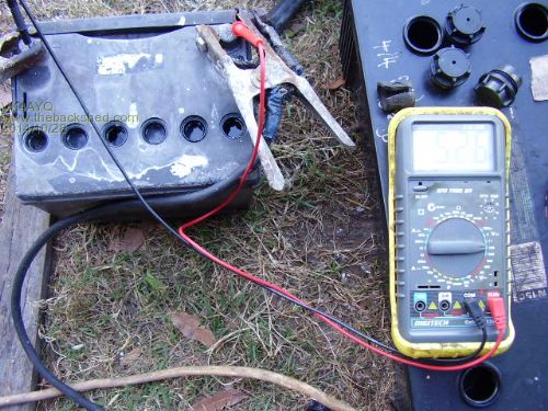

Hi All
As I suspected this battery is a worst case exercise, after six flush baking soda and charge cycles it has become apparent that the baking soda isn't doing the job, the plates are enclosed in a membrane so it is not getting in good enough, so today I took a different tack, after draining upside down for 12 hours a gave it a charge of water and a high voltage charge for 30 minutes flushed it again then added 3 heaped teaspoons of washing soda to each cell, it bubbled away happily for 30 minutes then settled down to slight bubbling half an hour later I checked the voltage and it showed 10.1 volts so it looks like I have a alkaline battery, I will leave it overnight and flush in the morning then add the ALUM and see what happens.
The concept I believe is working but it will now depend on how much active material is available as to the capacity it will deliver, the recommendation is to cycle charge and discharge a number of times to set the alum and plate combination so more work there.

Hi All
Morning report the battery settled down overnight, no more bubbling in the cells and voltage settled at 8.5 volts, I put it on the boost charger and it accepted 20 amps before it would accept only 5 amps so that is positive, There was quite a bit of grunge in the water so it got another clean out. I will leave it on the boost charge for a couple of hours and then flush once it is hot, I think one more flush and boil up with plain water and I will hit it with the ALUM.

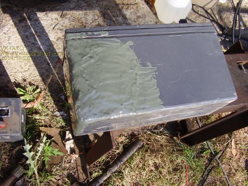

HI Isaiah
A photo of the resealed battery, I had to do it twice as there was a leak through the porosity but it looks OK now.
I have refilled all four damaged batteries and now included them in the battery bank for a equalization charge.

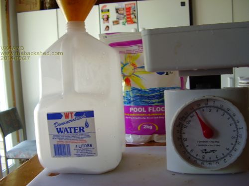

Hi All
Battery number one is now filled with ALUM electrolyte but it dosen't look to promising as it is only taking a small conditioning charge, the indicated volts off charge 11.5 volts but Not much capacity at this point, according to the experts it takes four or more cycle charges to get the capacity up so once again time will tell, I will leave overnight tonight and do another cycle tomorrow.
Preparing the electrolyte.
I used a four liter bottle of water to 400 grams of ALUM by weight.
I heated the water to make it dissolve the ALUM faster.
On filling the battery bubbled strongly and evenly across the cells, one hour later it settled down to a slight bubbling across all the cells, I then put it on the trickle charger and all the cells started bubbling evenly again so it is all active all that remains to do is to cycle it a few times and see if I can get any worthwile capacity.
