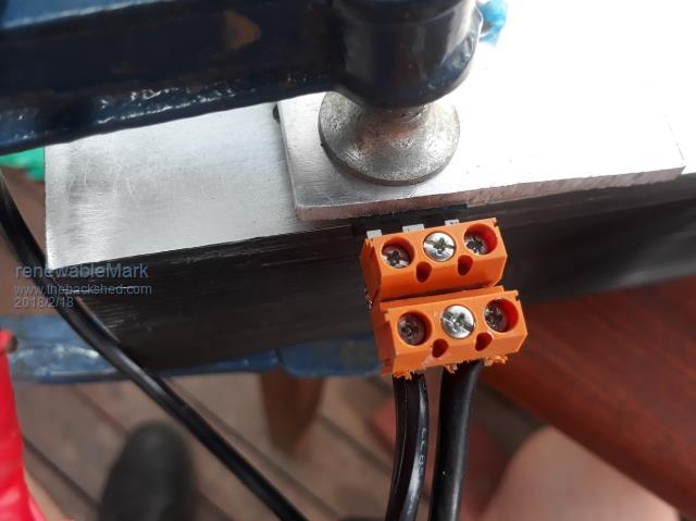

OK I am getting very consistent results now.
I was given another method to test, but didn't have the correct resisters, so pushed on with what I had.
I got two terminal blocks and drilled them through so the fet could fit two on the legs, soldered up the gate and source to the pins on the back. Now I can just slide it on and nip up the screws and have a nice safe connection.
The fet got clamped to the heatsink and the neg ammeter and voltmeter connect to the heatsink too. So all that is required it to gonnect the power on and use the multimeter probe close to the body and it's giving consistent results.
BUT I am getting 214 and 215's
Mad weren't you getting 277's?
I'm concerned my testing isn't quite right.
I'm using 4x20ah 12v in series 2x20w 33r resistors in parallel (in water)
Which is giving 10.3mv and .048A
Cheers Caveman Mark

Tinker
Joined: 07/11/2007
Posts: 1904
Posted: 08:52am 18 Feb 2018
  renewableMark said
HA I might just be learning after all!!
Yes, there is a learning curve with everything in regard to these inverters.
It would be very helpful if you quoted what you were measuring, like is it Amps, Volts Millivolts Watts etc etc.. Just typing the figure you see on your meter gets everybody who reads your post guessing which meter you were looking at.
Anyway, you have lots of testing power available from your battery bank but seem to be using too little of it.
There should be a circuit like: + supply(battery) - 10A meter - Heatsink drain connection. The return should be source terminal - big water cooled resistor - negative supply.
In that circuit your meter should be reading close to 10A when you apply 12V to the gate (negative is common).
You might have to mess with different resistors until you get a decent current to flow.
This is easy for me with an adjustable power supply but you should be able to get close to 10A with your battery.
It is *really* important to have a decent test current through the mosfet. But be careful, your meter internal fuse will blow if you get that resistor too small (Ohms).
Once you get that going have a go measuring the millivolts between the drain and source legs. One step at a time will get you there.
Now, the millivolt reading divided by the current on your Amp meter will give you the RDSon of the mosfet. Take care about the decimal places with this calculation.
But, since you are matching Mosfets the actual RDSon is only academic, nice to know.
What I do is write the millivolts on the back of each mosfet with pencil.
You then have a figure to compare with, so, select 6 off with a similar reading for one inverter leg, ditto for the other legs. It little matters if the reading between the leg groups are somewhat different, what you are aiming for is selecting those in parallel to have a RDSon as closely matched as possible. This way they will share the load equally.
Keep at it
Klaus

Something is not right there Mark, that results in >200 milliohms should be around 2.7 milliohms.
