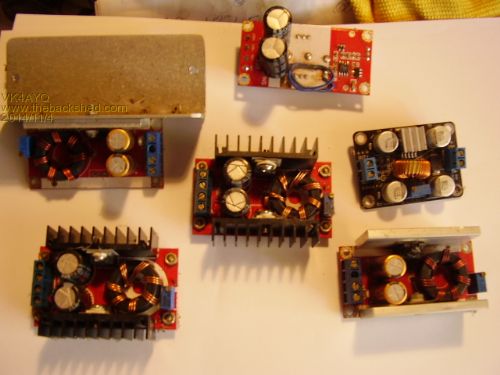

On the efficiency of the switch-mode converters it is the ratio of the power input amps * volts to the power output amps * volts , to do this you need a sensitive amp and voltmeter in both positions and a fixed load, the ones i have checked have worked out around the 90% for loads above 75% of rating with slightly lower at lighter loads due to fixed internal circuit losses, on heavy loads the losses go up again due to switching losses.
This is some of the ones I have tried and tested as windmill boost modules.

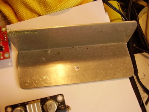

I found that their heat sinking was inadequacy so I used a piece of light alloy angle to solve the problem
Three terminal voltage regulators working in buck mode have a higher loss due to the dissipation of excess watts in the voltage reduction process, basically I see them as a variable resistor that dissipates excess power as it regulates to a load.

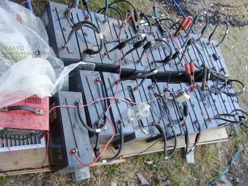

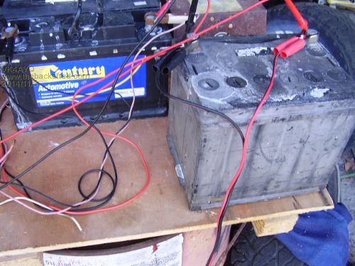

Joined: 02/12/2009
Posts: 2539
Posted: 01:56pm 04 Nov 2014
Hi All

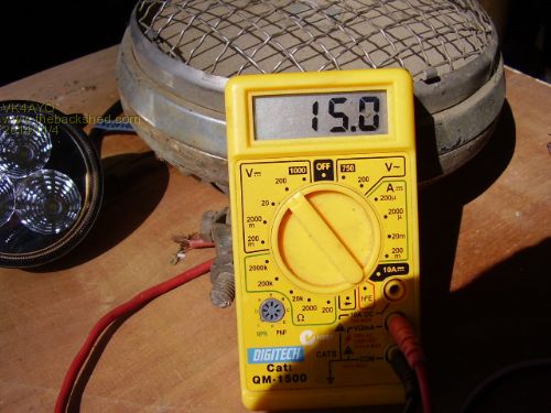

This morning I went to check the batteries being charged in parallel on the trickle charger and both had achieved a float voltage of 15.1 volts which the equivalent to the equalization charge on the 12 volt solar regulator that runs the water pump and keeps other batteries floated until I decide what to do with them.
At lunch time I will disconnect the batteries from the charger and let them sit until tonight to establish a resting voltage on both, then see what the natural discharge is over a week without load, in the mean time I will do a bit of work on the 12 volt lighting system for the house, replacing the fluro fittings with e 27 batten holders initially I will go for 240 volt leds but in the past I have found them very unreliable so when finished I will go all 12 Volt and hope for a more reliable result with them.
The original light wiring was done with 240 volt 3.2 mill cable and used as a 32 Volt system for a number of years until the power was put on, some 20 years ago. The wiring handled 50 watt 32 volt globes so should have no trouble with the LED loading.
All the best
Bob

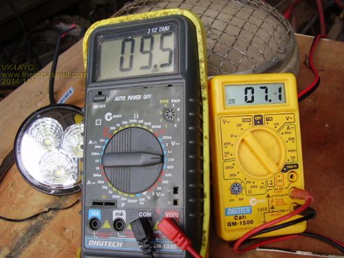

VK4AYQ
Joined: 02/12/2009
Posts: 2539
Posted: 05:18pm 04 Nov 2014
Hi All
Battery number one has settled to 11.1 volts but battery number two is still taking a charge at 3 amps so will leave it a bit longer to see what it will do, either it has increased capacity or developed an internal short, I can tell later when I check its voltage again.
All the best
Bob

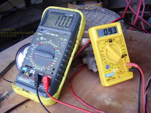

VK4AYQ
Joined: 02/12/2009
Posts: 2539
Posted: 12:13am 05 Nov 2014
Hi All

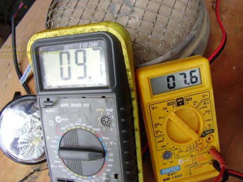

This evening six hours after the Finnish of float at 15 volts the two batteries are going their own way the older battery on the right was the worst in my estimation but is holding volts better than the left hand side battery, that had sat for less than 2 years but judging from the voltage sag so far it has a damaged cell.
Voltages are for left battery number 2 are lower right hand meter is the left hand battery number 2 sorry about that.
Start of test at lunch time both where floating at 15 volts.
All the best
Bob

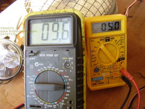

Joined: 02/12/2009
Posts: 2539
Posted: 08:45pm 05 Nov 2014
Thursday Morning
Thursday evening
Battery number has dropped of markedly during the day today while battery number one shows a little higher voltage not that is an issue as digital voltmeters tend to flick around a bit so its only a point of a volt.
By the reading it indicates to me that battery number two has a weak / faulty cell as it is about the 1.75 volt per cell below battery number one.
All the best
Bob
Foolin Around

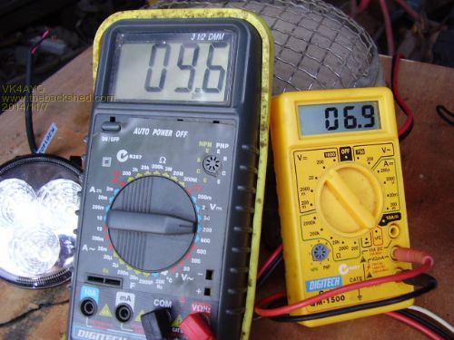

VK4AYQ
Joined: 02/12/2009
Posts: 2539
Posted: 10:26pm 06 Nov 2014
Friday
Friday Morning
Friday Evening
Battery Number one has held a reasonable level of voltage whereas battery number two continues dropping.
I think the experiment is at at end as the batteries are nor=t going to be useful for anything other than running a few leds or small transistor radio so we could say the concept of recovering batteries from the junk heap is a myth and not worth the effort.
perhaps starting with a good battery and converting it may have some merit, but why convert a good battery, it doesn't make sense to me, a good desulphate and some extreme cycling to break open the sulfate would I feel give a more useful result than playing around with different electrolytes.
The problem I feel, and am open to discussion on the subject, is the conductive power of the electrolyte, I tested ALUM and compared to acid at 30% concentration the alum has more than twenty times the resistance and compared to strong alkaline caustic soda as NIFE electrolyte there is a big difference in conductivity so the internal resistance of an ALUM battery is much higher and therefore less able to deliver current to any load in particular a heavy one.
I tried increasing the concentration of ALUM in the solution but as soon as the electrolyte cooled the ALUM precipitated out of solution and didn't decrease the resistance of the solution.
So back to my main battery bank as it has been sitting in desulphate mode for a bit over a week and all the cells are lightly gassing, hopefully next week I can get it to 16.1 volts to finish the desulphation process and do some load testing to see if it has recovered to a usable capacity.
You will note that my bench gave way to gravity the trestles collapsed so now I am watching them on the ground.
All the best
Bob
