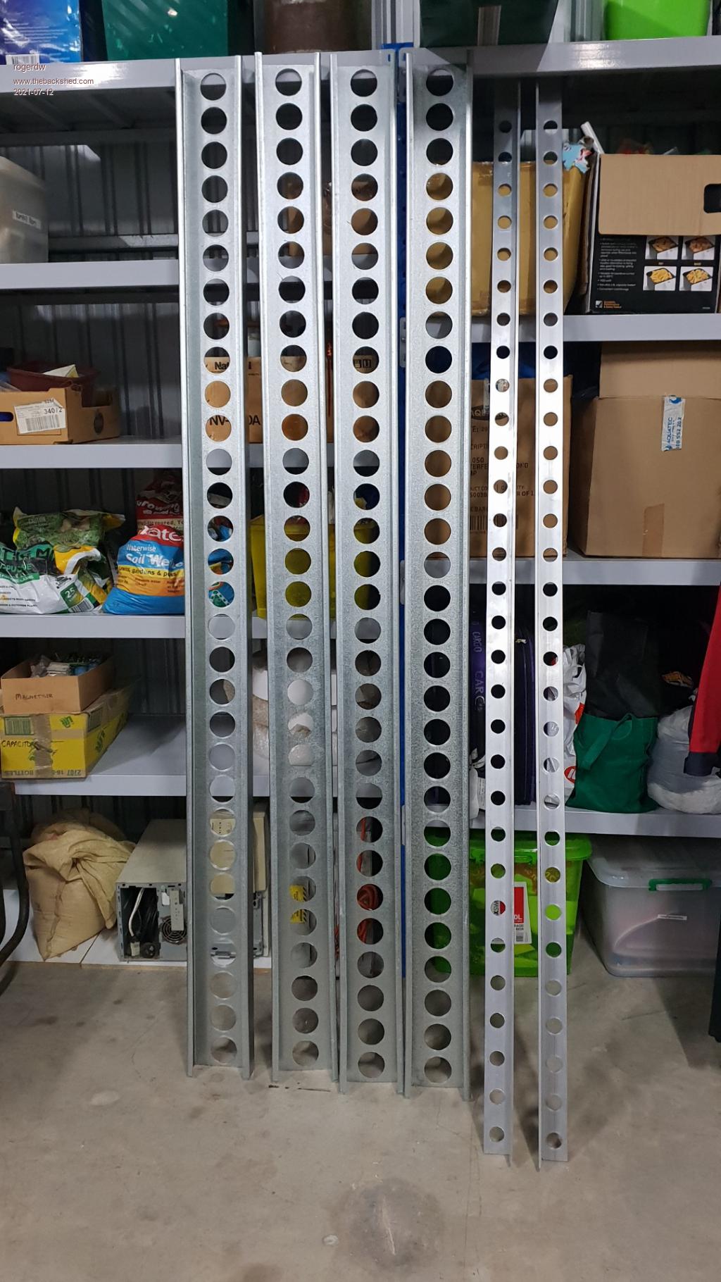

Well I'm still at it.

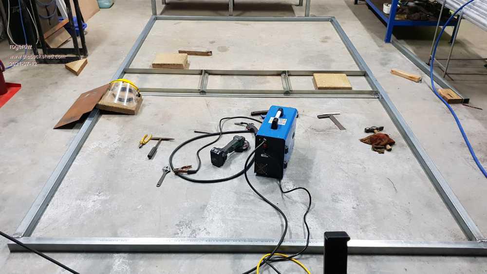

Wife and kids were away for the weekend so I made a plan to get stuck into building the big version for the roof. Had all the main steel for a few weeks but been dragging my feet  ...  plus had to clean up a fair bit to make room to build this thing.
The main frame is 4.1 meters wide by 2.4 meters high and will have the ducting down the centre and with the evacuated tubes sticking out each side, horizontal  ...  60 in total.
Looking at the size of it and realising the weight, I'm starting to wonder how I'm gunna get it up there  ...  might have to call in a few favours.
It's really only the main frame that will be the issue  ...  the rest I will assemble up on the roof.

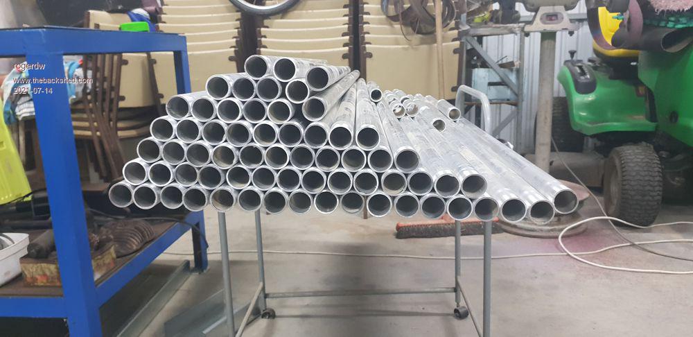

I started by drilling the aluminium angle with 32mm holes to take the ally tubes  ...  then tackled the c-section with 63mm holes. Took a while but very pleased with how it went.
Then I cut up the steel and welded the main frame together. Need to do a lot more welding yet, but its getting there. It's upside down at present.
If nothing else, you can see I'm serious  ...  or mad!!!

Roger, I can't see how you "drilled" those big holes so neatly. Did you do what I would, drill a 10mm pilot hole and then use what's called a 'chassis punch' to remove the remaining material?
rogerdw
Joined: 22/10/2019
Posts: 957
Posted: 08:40am 13 Jul 2021
  Murphy's friend said  Roger, I can't see how you "drilled" those big holes so neatly. Did you do what I would, drill a 10mm pilot hole and then use what's called a 'chassis punch' to remove the remaining material?
I did drill pilot holes, though only about 5mm  ...  then used a holesaw to create the holes.
I screwed a guide block to the drill press table then slowly did each one.
I was going to try kerosene or even WD40 when I did the aluminium  ...  but when I was in Bunnings I spotted a spray can of cutting oil put out by Suttons, who also happened to have made the holesaw set that I have  ...  so I used that for all of the holes and it certainly went well. Was $19.95, so expensive  ...  but seemed to help.
Took all evening to do the aluminium angle  ...  had them clamped back to back  ...  so the saw had to go through 12mm of metal.
The C-section I clamped back to back as well  ...  so halved the setup time in shifting it through. Those took pretty much all day to do.
I was amazed at the swarf coming off the cutter. If I fed it in properly I could get a curly piece a couple feet long before I backed off, blew away the swarf and lubed it again.
Got a nice box full of washers now.

I actually missed the fact you drilled all the metal looking at the pics till I read your post. It looks factory neat. I have some sort of steel that is perforated like the wider stuff, don't know the name but they use it for making walls and partitioning in offices which is where I got it. Your's looks every bit as factory neat as that does which is what threw me.

I bought some of those trick aluminium brazing rods to try, and they do work very well with just a propane torch. Only two disadvantages, they are bloody expensive, and the aluminium must be in perfect pristine degreased and unoxidised condition.
I'm relieved to hear that Tony, hopefully they will do the job when they get here.
My tubing is secondhand, though I think it was all offcuts from new material and is in good shape. I have buffed the ends and it has come up beautifully.
  Quote  But for fresh new store bought aluminium. it works great if you can get enough heat into it.
Perfect for one off small jobs, but doing repetitive brazing to heavy gauge sections will be very slow and use up an unbelievable amount of propane and those (solid gold?) brazing rods.
Mmmm  ...  so can I use the oxy to heat it or do I need to get some propane?
And in my naivety, I wondered if I preheated the join area somehow close to temperature and then used my hot air desoldering gun to do the job. The melting point is supposed to be 480 degress and the hot air device goes to 550. I know, dreaming!!!
  Quote  As you have discovered, aluminium filler rod and oxy acetylene torch definitely does not work.
Haha yes, though that is what I used to join all the pipes for my first device. I didn't take any photos because they'd be too embarrassing to show  ...  but they did stick together. Though a lot of them would have a lot of globs of metal inside where it started to cave in!!!
