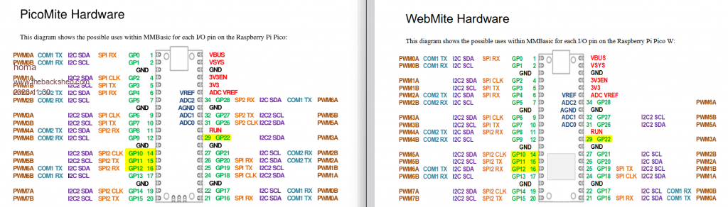

Are GP10, GP11, GP12 or GP22 used by anything special on the Pico W? I've never used one. Those pins are dedicated on that Waveshare board.

  Mixtel90 said  Are GP10, GP11, GP12 or GP22 used by anything special on the Pico W? I've never used one. Those pins are dedicated on that Waveshare board.
I do not think so **grr** I2C2 SDA is missing :-(

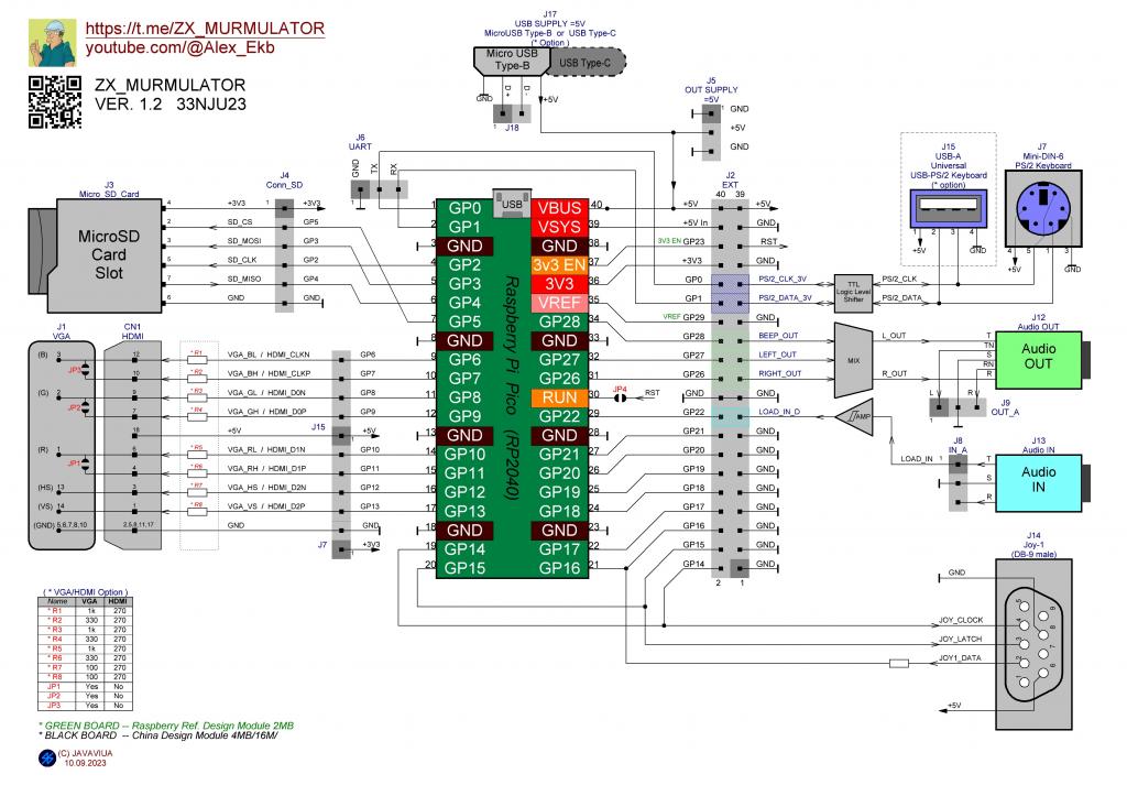

Since I am testing PicoMiteVGA on a different circuit, I assembled the MMBASIC system from sources with changes for my circuit, taken from https://github.com/UKTailwind/PicoMite
But the last update (PicoMite V5.07.08RC19) was two weeks ago.
Where can I download the latest updated release candidate source code?

  javavi said  Since I am testing PicoMiteVGA on a different circuit, I assembled the MMBASIC system from sources with changes for my circuit, taken from https://github.com/UKTailwind/PicoMite
PicoMite V5.07.08RC21
Assuming your circuit is based on the Pico (and not simply the RP2040) I'm curious as to why the circuit matters since the firmware is built around the Pico circuit, I suppose you might have changed the VGA wiring ?
Anyway, the contents of that github repo is the latest PUBLISHED source. If it isn't up to date then you just have to be patient. Peter doesn't use github (or any public service) as his master repository and is under no obligation to keep it up to date. At the moment I think he may be "away" hence his lack of reply.

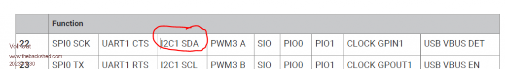

The Raspberry Pi Pico Datasheet doesn't show I2C2 SDA on GP22 either, so it doesn't surprise me that it's not shown for the Pico W. That doesn't mean that it's not there though. :) It *is* listed in the RP2040 Datasheet.

The chip can do it.

I suspect the original Pico Datasheet missed it in error and it's been a cut & paste job for the W version. Peter seems to have worked from the RP2040 Datasheet for the MMBasic port so he got it right.
