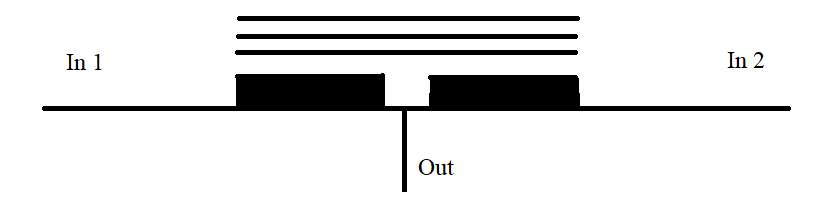

Posts: 3412
Posted: 10:57pm 29 Aug 2024
As you mention the imbalance is small compared to maximum output, and likely to get smaller when they have the same primary inductors so you could leave it at that.
However if you really want perfect balance it is possible by adding a relatively small 1:1 autotransformer to the output.
As the voltage difference is a fraction of a volt 1 or 2 turns through a 300VA toroid should ensure the current is shared equally.
I have seen it done when extra chillers were being added to a 3.3kV buss. The existing 22kV/3.3kV transformer was too small so another was added in parallel. The impedance of the system was so low that a fraction of a volt difference resulted in a current imbalance of almost 100A / phase. The 1:1 3⌀ autotransformer cured it.
The chillers were quite large - 140A @ 3.3kV.
KeepIS
Joined: 13/10/2014
Posts: 2282
Posted: 11:29pm 29 Aug 2024
Very interesting idea, but as you say, it's a relatively small difference.
Even if I can't improve on what it is now, I'm absolutely stoked with the result as it is, I mean, 6.5kw is just idling to this beast, I can't even move the toriod temperatures above room temperature.
The extra room around the toriods and the silently assisted natural airflow is allowing complete air flow around, through and over every mm of both toriods.
I'm just amazed at how well this beast is working, it looks like I finally managed to get it right this time, it only took me 3 different builds and 2 years though

Posts: 3412
Posted: 03:48am 30 Aug 2024
An excellent result.
This shows the very low impedance of the large toroids requires everything to be matched to get good current sharing.
The autotransformer idea might still be useful for anyone that does not have identical toroid stacks, but clearly not needed here.

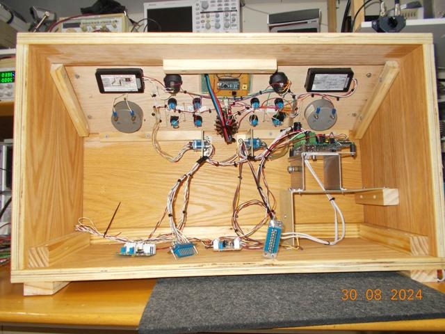

KeepIS
Joined: 13/10/2014
Posts: 2282
Posted: 03:50am 30 Aug 2024
  phil99 said  An excellent result.
Thanks, very happy
Almost forgot A big shout out to wiseguy for his brilliant Inverter designs.
BTW I just unplugged the control panel-controller housing and placed on the workbench to fit the extra trip boards, the two small boards on the bottom are the Peak DC meter drive boards, once the AC trip boards and the over-current latch and indicator boards are fitted, they will all be mounted, and then I'll be shortening cables and fitting colored cable ties correctly.
This is looking a bit messy because of all the temporary cable ties as I'm still building and laying it out.
But you can see how easy it is to work on, again, literately seconds to unplug and remove this cabinet controller section, which also completely opens up the toroid cabinet, power board, high current DC input and kilovac & precharge section.
_
Edited 2024-08-30 16:14 by KeepIS
