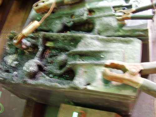

Back to my burnt battery rescue.
After two weeks on the desulphator the batteries are now at 15.8 volts and balancing well the total destruction and a two year sit will have done some long term damage but it looks like I have a usable 12 volt battery for my troubles. It can sit for another week in the desulphator then i will have to devise a closure over the damage to keep the dirt and rubbish out.
All the best
Bob
