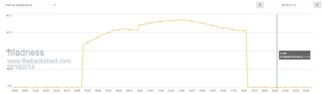

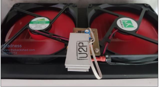

I just added 2 140 mm fans with Oztules control board to the top of my 5KW Zeversolar GTI. The GTI is in a shipping container that is airconditioned, previously it was showing temperatures in the mid 50's and according to the manual, it starts to reduce output at 45 degrees.
Since the fans are on there it now does not get above 35, I don't know if it has much of an effect on the power output but I am sure the lower running temperature won't do it any harm.

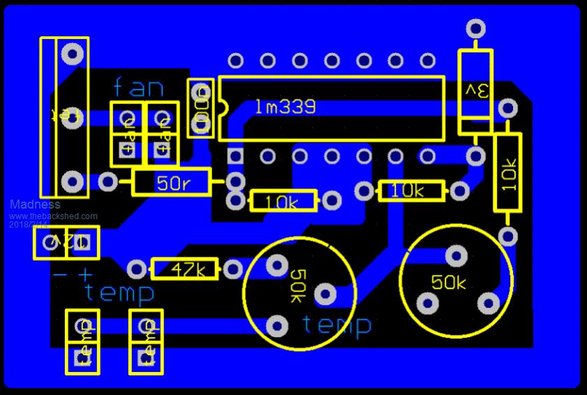

I have got all mine inside, I know GTI's are designed to go outside but I prefer inside. My fans are and control are powered by a 12V plug pack. The control board above comes on gradually so the fans only run as fast as required.
This the control PCB.
Further details here.

The variable speed of the fans in your design may be an asset in some instances.
I thought about this using different temp switches and activating relays with different resistances to the fan.
To me seemed overkill. I have a speed control on the 240V fan I'm using atm and have found a setting where it supplies adequate cooling at low speed and minimal power consumption. Turning it up make no diff to the inverter temp as the ambient air is usually pretty warm here being summer anyway.
Spose there are trade offs to every approach lot easier for me just to wire some components together than make up a board and put all the components on it.
If I go to 12V fans, the power they use is so minimal I won't be worried about saving a few watts slowing them down. As mentioned, they can be pretty hopeless with resistance and backing them off makes that far worse.
