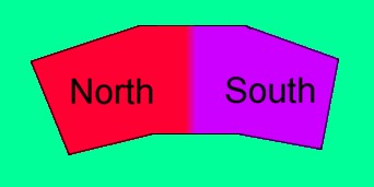

Maybe somebody will correct me if I'm wrong but I seem to recall from my trade school days that one cannot have a SINGLE pole magnet.
There is ALWAYS a N and S pole. If, as I imagine you did, you cut a HD magnet in half, the original of which had a N and S pole on the SAME surface, you get a similar polarised magnet, only half size and less power. I think you have to remagnetise your cut HD magnets so their poles are as below.
What you need is a magnet that is magnetised THROUGH the body, eg. having the N pole on one side and the S pole on the reverse side. This will let you place a N pole magnet tile alternating with reversed (S pole up) magnet tiles on your rotor laminations.

Hi Klaus,
You are not familiar with the magnets that have been discussed. The magnets are really 4 poles. The poles are according to the pictures posted elsewhere on this thread, and the poles are through, between the opposite faces. Spiral has described the N & S inner pole faces. There is obviously the corresponding opposite pole face for each of the N's and S's that he described. .. .. Gordon.

Thanks Gordon, for enlightening me. It did sound confusing in the message I referred to.
