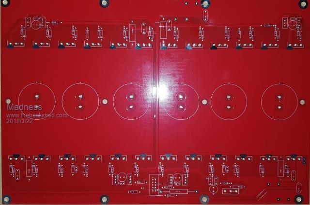

That's more interest than I expected, so we are over 20 now so Power Boards are $25 control boards $10 plus postage from me at 4556 QLD Australia.
A pair of boards weighs 310 grams up to 3 sets would be $15 (1KG) for more 3 KG is $17 for express post within Australia.
Also what colour do you guys want, I have got red before as below but you can have Green, Red. Yellow, Blue, Black or Purple with white or black silkscreen. Once ordered from China they take about 1 week to arrive in my hands, but I need to redo the control board with the latest mods first. It would be good to add low voltage shut down to the control board if anyone has any suggestions.
Please note this is the previous version of the PCB I have deleted the mounting holes across the centre near the caps, added 20K resistors across GATE - SOURCE on the MOSFETs and Totem pole Transistors, plus a few other little tweaks to the tracks and solder mask.Edited by Madness 2018-03-23

Do you drill the holes for heatsinks yourself?
Posted: 10:07pm 21 Mar 2018
I don't have any holes for heatsinks, they mount directly to the MOSFETs. I have had need or reason to screw the heatsinks to the PCB. I screw a sheet of perpex to the top of the heatsinks, this keeps them ridgid and provides a place to mount the control board.
