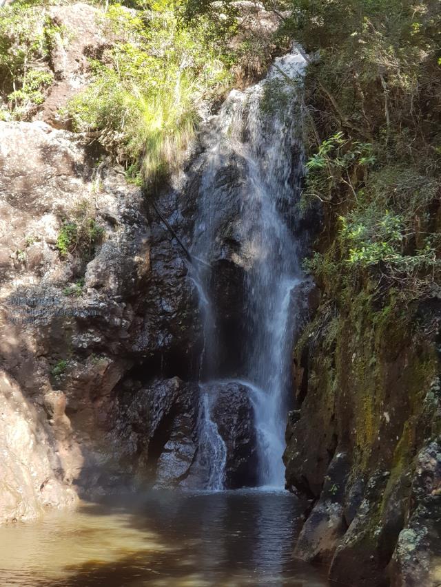

The boards that I am making will do what you want Yahoo with a battery bank, much the same as Clockman except in my case I will have control over the charge current. So the charge controller will use PWM to reduce the power available to GTI's based on battery voltage and charge current. It won't matter what AC loads you have running as the battery current is what is being controlled. If the sun is shining bright and you have the AC, HWS, oven etc running the GTI's will power them and the leftover power that is going to the battery via the Inverter is limited to the set current.
I am doing this now except for the current limiting which I am working on ATM. There will be the possibility of turning on the HWS and similar loads when the regulator starts to throttle back the GTIs, ie if PWM =< 80% pin 4 = HIGH & if PWM == 100% pin 4 = LOW. The threshold for this would need to be set to suit the amount of PV being used. You could also have circuits that are turned off when the power input reduces the charge current to help avoid any discharge during the day.

Posted: 10:39pm 28 Apr 2018
Hay Madness, that's a fantastic sexy waterfall you have there. wow!
Madness
Joined: 08/10/2011
Posts: 2498
Posted: 10:51pm 28 Apr 2018
  Clockmanfr said   Hay Madness, that's a fantastic sexy waterfall you have there. wow!
Yes I like it, there are a few others but that is the best one.

George the property is in the Sunshine Coast Hinterland in SE QLD. Took me a while to find this place and I am a Real Estate Agent.
The flow over the waterfall is after a few months of good rain, after heavy rain there is massive amounts of water that goes down that creek. In drier times though it never stops but slows down to a trickle. It is not suitable for 24/7/365 hydro however I plan to build a dam near another small creek up the top. I will then be able to use excess solar power to pump up to the dam during the day and run hydro at night. Getting 1 KW continuos at the head I have available would require a flow of 2 litres per second using a more efficient motor from a F&P washer. This will supply high voltage DC to the house about 400M away where I will connect it to a GTI. I will be aiming for around 750W going bigger requires pipe bigger than 50mm which starts getting very expensive very quickly with the pressure involved. With this setup and the dam I am planning I could get about 2 weeks running from a full dam, it will eliminate most of the draw on the battery.

Sounds Brilliant.
2 week capacity pure water battery. Every home should have one!
Sure beat the hell out of one of those silly tesla batteries.
Brilliance of this is when the solar is not producing much through the day it will probably be raining when means the hydro will be working.

That is 2 weeks with 0 solar which won't happen (I hope), I would not want to drain it completely anyway.
I would not be so hard on the Tesla battery it might not be cost-effective ATM but it is causing a shift towards batteries for everyone. I am sure if a couple fell off the back of a truck at your place they would be up on the wall very quickly. You get f all for exporting power so why not store and use it at tnight.
