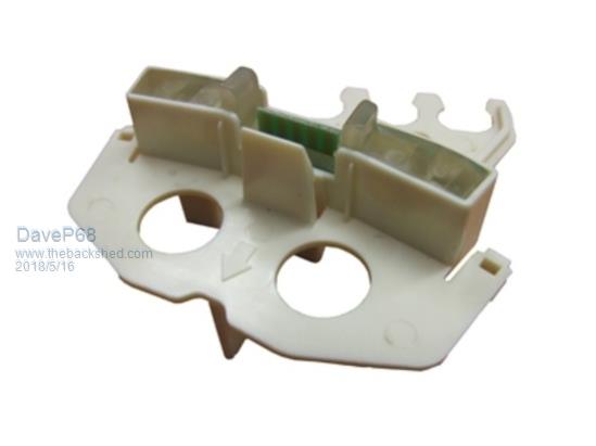

The IGBT I used is a 600 VDC version with lower current limit IRGBC30S
It can still be use to drive a resistive load of about 20 - 30 ohms if used in the high voltage low current mode. To use the 1.5 ohm heating element will require a lower voltage higher current device.
For an RPM sensor just reuse the RPS unit that was mounted on the 36 pole copper stator.
Has 5x pins +15 VDC, 0 VDC, phases 1, 2 & 3 outputs. Only need to use a single phase output to measure RPM.
24 pulses per/sec = 60 RPM.
David Edited by DaveP68 2018-05-17

BarkyJ
Joined: 26/04/2018
Posts: 114
Posted: 07:44am 16 May 2018
Thanks Dave
So 15VDC for those RPM sensors, is that the limit, or thats the nominal voltage? Can it run from 5VDC?
24 pulses per/sec = 60RPM, is that for a stock stator, and does it change when you change the stator wiring, or totally independent of that?
where does 24 pulses per second come from exactly?
60 RPM = 1 RPS so 1 rotation is 24 pulses... ? But arent there 36 coils, split into 3 phases, so wouldnt you get a 12 pulses on each phase output of the sensor, each rev? How do you get 24?
