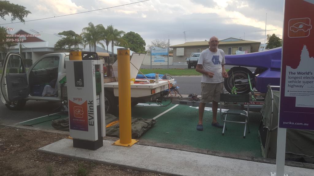

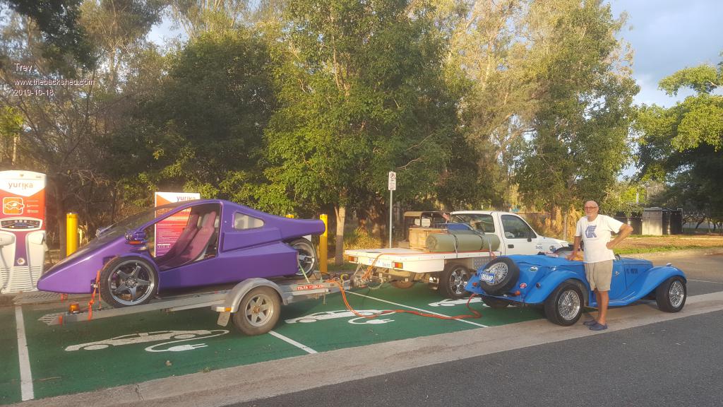

We left Mt. Larcom at 12.15pm. Lost track of time at Gladstone. We couldnt find the 3ph outlets. Some kind locals took us to them. They were no where near where plugshare pointed us. But no joke. there must be a hundred outlets. I didnt go counting but everywhere you looked, there was another one. So we found a shady outlet. Connected up a 3 phase and 2 single phase outlets.
Ee did have people stop by and talk, but had the opportunty to have a look at the Zivan charger again. It is Fair bit of work to get to the charger. Found nothing wrong in the back. it turns out to be the fuse in the front, under the Soliton speed controller. very hard to get at, but managed to get it out and wrap in aluminium foil. It works again.
No record of power as these are just standard power outlets.
We left Gladstone at 3.42pm.

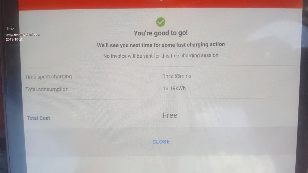

Arrived at Miriamvale at 5.02pm. From Gladstone to Miriamvale is around 69km, Charging was done only with EV Hilux chargers. No power taken from T-Rev, so didnt connect it up. Charging finished about 6.45pm, but left it connected to do a cell balance. plenty of time, camping here the night.
Here is the Chargefox recording. Only one charge cable was used

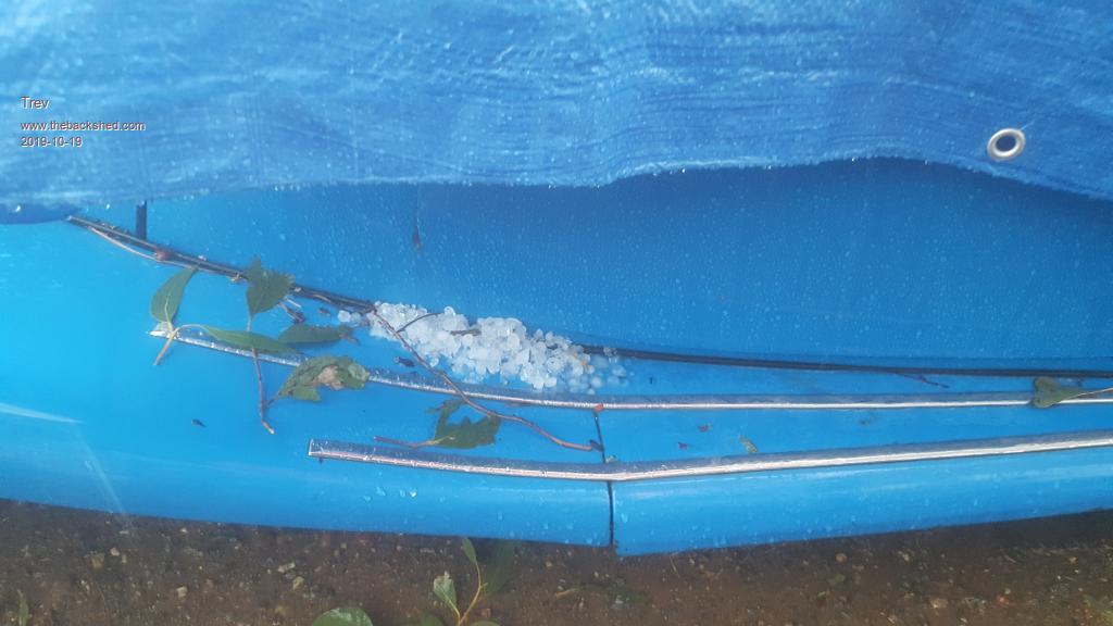

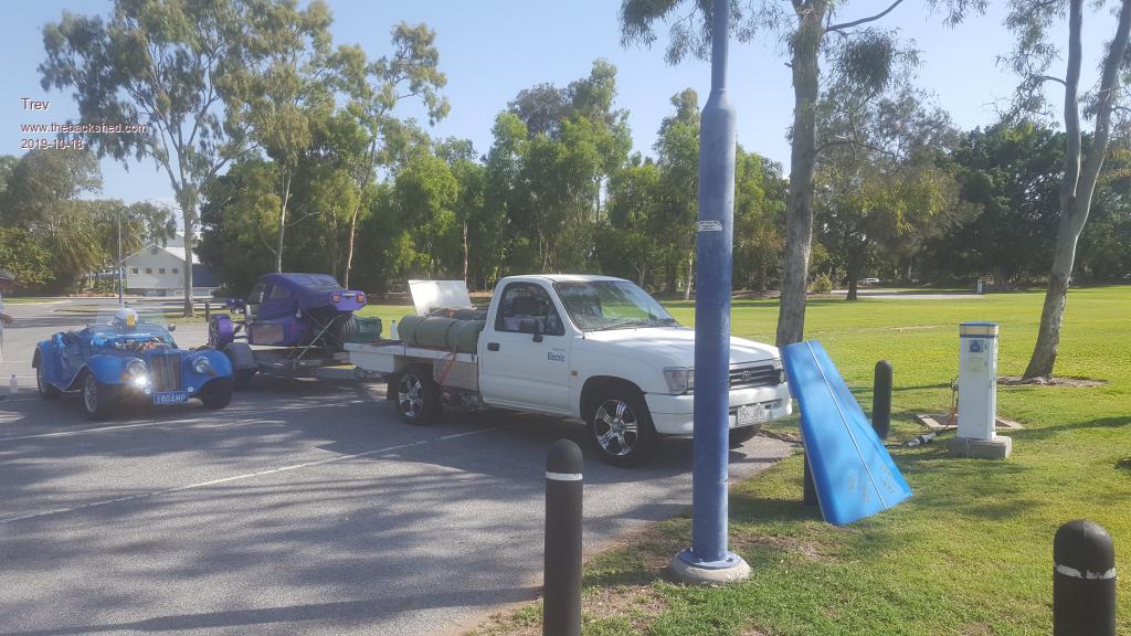

After going to bed, lighting and thunder started. So got up and put on a few tarps and other general storm preparations. Glen was already asleep, but woke with the thunder and got up to put a tarp over MGEV. As we finished, the rain started. So quickly got back in the swags. Slept dry and warm. Dont know how long it rained. I just went to sleep. Rained again a little around 3.30am. Rolled up swags thismorning wet.
Left Miriamvale at 5.14am.
Dumping power time about 22km north of Gin Gin. Quite a few long steep hills in that last section of road. Gladstone is on the coast, not much above sea level. Where we are now is about the highest peak on the first elevation chart.

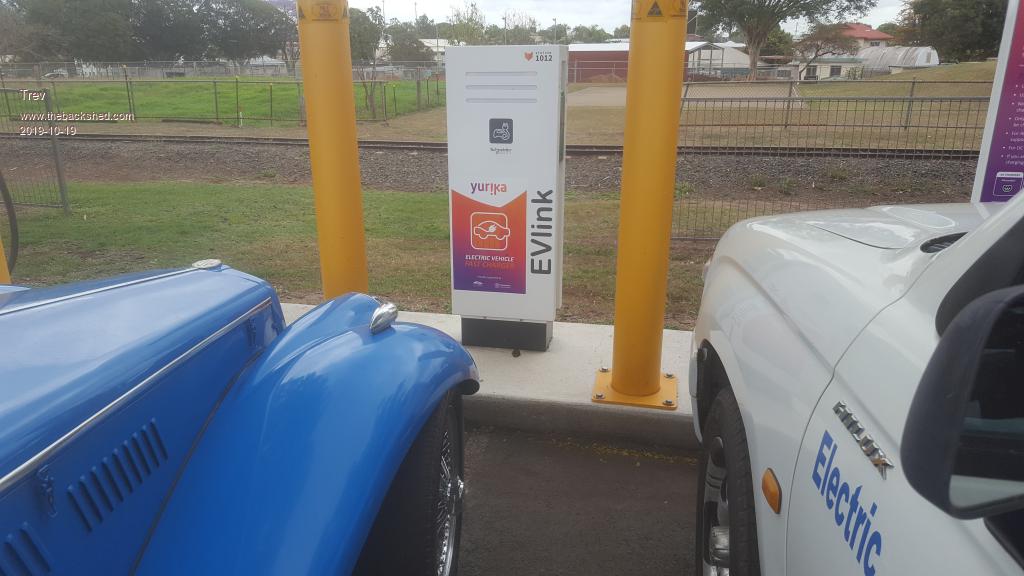

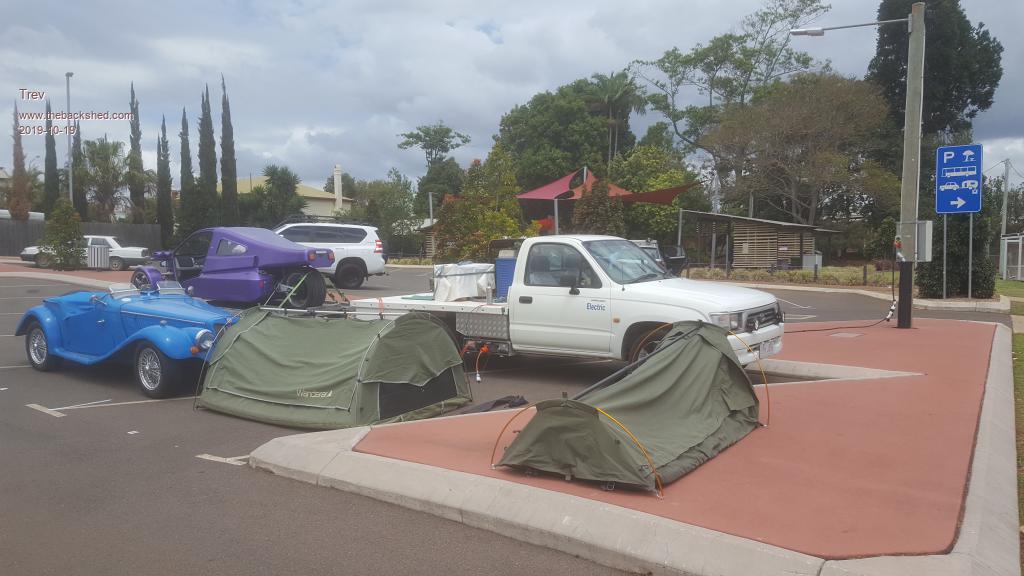

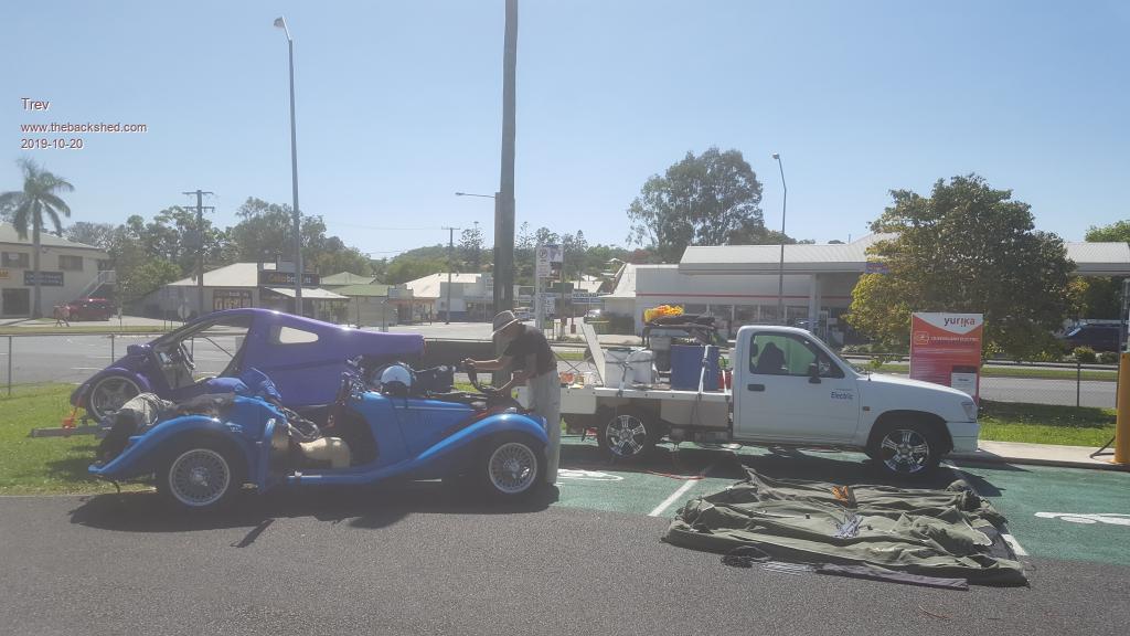

Arrived at Childers at 10.00am.

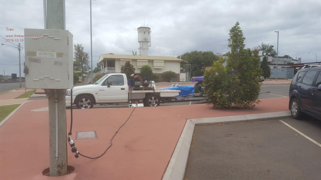

Electric Highway Chargefox Type 2 outlets still not working. I reported it not working on the 9th Aug and again on the 17th Sept. It is still not working now. I reported it not working again today.

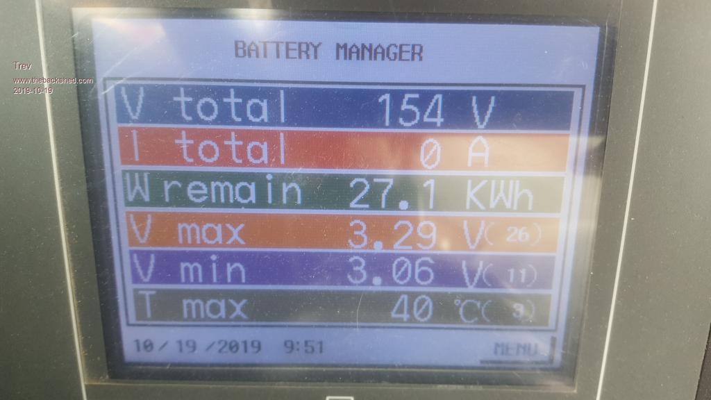

So we are charging at the 3ph outlet across the road in the carpark. set up the swags to dry out.

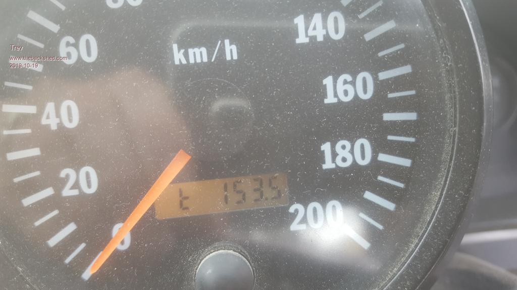

153.5km from Miriamvale to Childers. EV Hilux had 27.1kW out and T-Rev had 143Ah out. MGEV had 60Ah out.
No charge details again as is from a standard 3ph outlet.
Finished charging at 1.37pm
Trev @ drivebynature.com

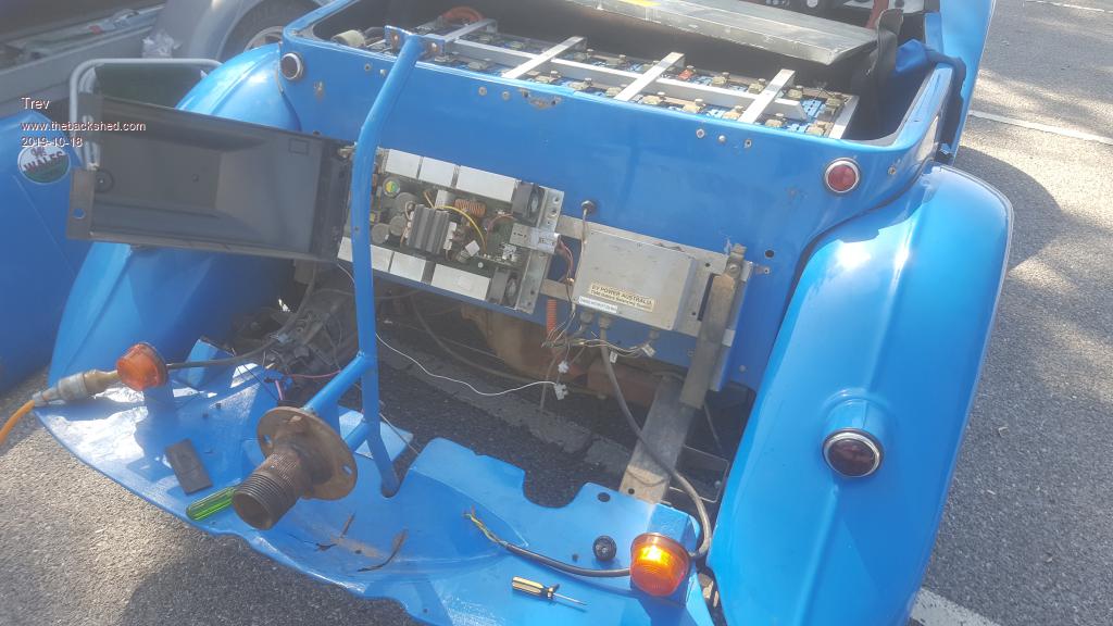

We arrived in Maryborough at 2.47pm.
The charge outlet did not work. It stopped working the last time I was there 17 Sept. I reported it and they sent an electrician to come and get my cable out of the outlet.
We had done from Miriamvale to Childers, and the distance from Childers to Gympie is less and down hill more, so just did a dump from T-Rev to MGEV and headed off. Just north of Gympie we were headed into very dark clouds, so stopped to take shelter. Before we could get the tarp on MGEV, the rain started. Both of us got drenched...... and then hail. It hurts too! 10 & 15mm size. When the rain and ice eased off, I got some pictures. The hail melted as quick as it came down. The whole ground was white, a total matt of ice balls.
Glen does not want to drive in the dark or rain, camping here the night. Between showers set up the swags.

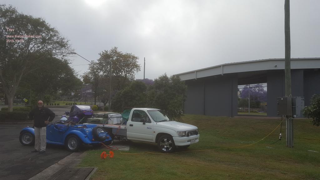

I got up at 4.30am and set up the dump from T-Rev to MGEV. Glen was up soon after and we got things sorted and swags etc packed up. Got driving by 5.15am. It turns out, where we camped in the bush, was 52km north of Gympie.
Arrived at Nelson's Reserve in Gympie at 6.15am. It was hard driving with fog and heavy cloud for a while. We didn't do a full charge, only charged enough to get to Cooroy. No charge data as was standard 3ph and 1ph outlets.
Left Gympie at 7.39am

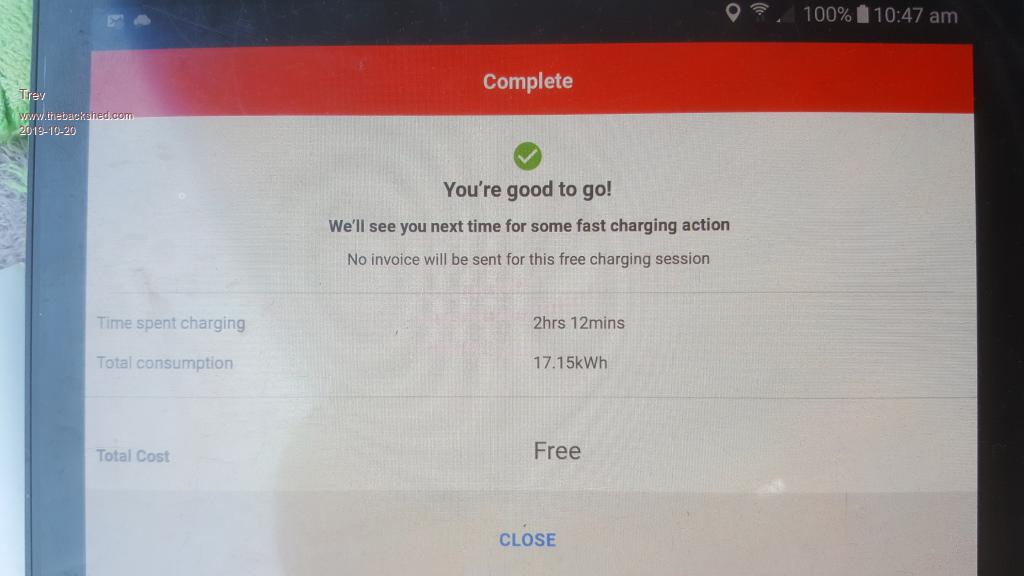

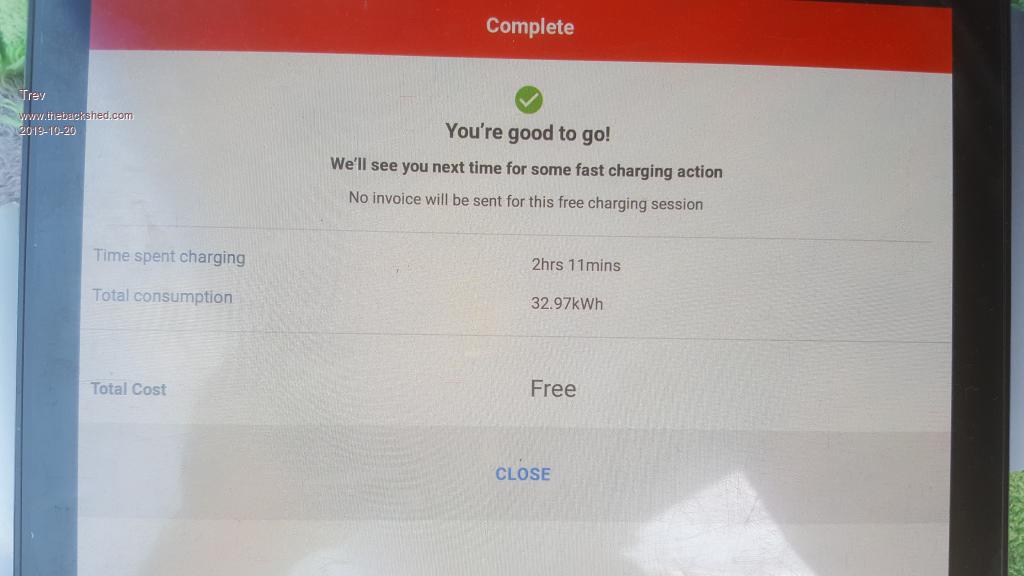

Here is the Chargefox data for Cooroy.

Why does the chargefox? system give you so much free power and says you won't be invoiced. How much is power KWH when they do charge you? Is the EV link with that app and could you explain more about those outlets as you seem to be charging from a lot of them.
I notice there are significant variations in time and power you get on the app. Is this because of single and 3 phase charging? what are the max charge rates respectively.

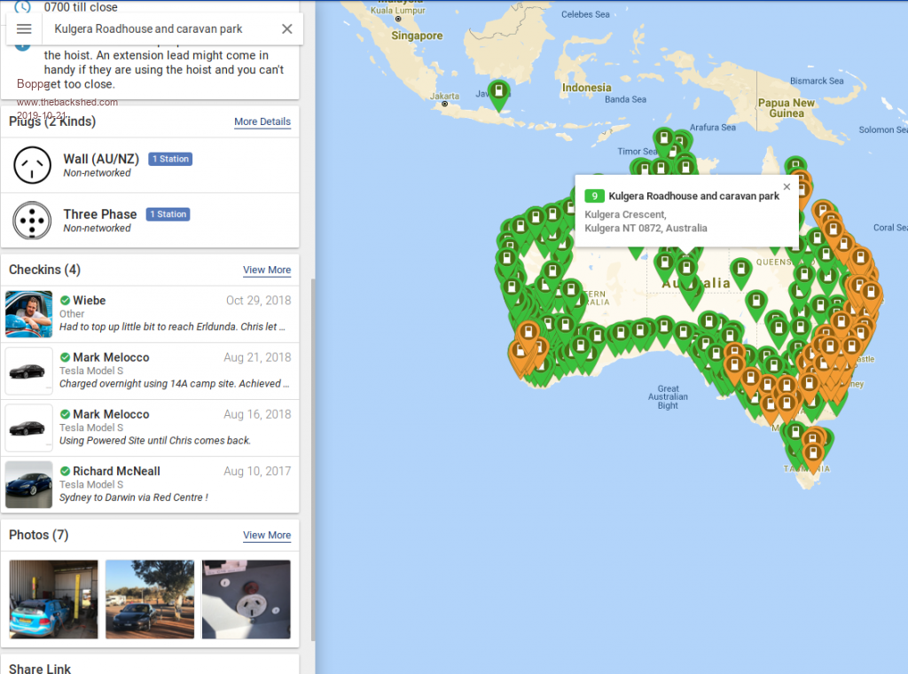

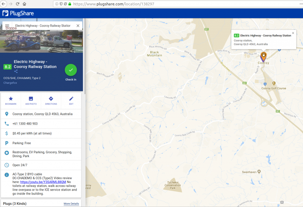

Plugshare is the most common one (I believe this is the one Trev is using???
Gives you an interactive map like this (you can zoom in on the website to get more accurate points)
Click on a map point and get something like this
Gives you the address, what plugs are available, often even pics of the actual charge point (handy for spotting ones hidden away out back lol)

What is the difference between the orange and green markers? Proper charge stations and  just regular power outlets?
I noticed the pic of a regular outlet and trev saying they used single phase outlets.
As they are normally 10/15A, wouldn't that only be supplying 2.4/ 3.6 Kwh?
Given that the pics above show 17 and 35 KWh charge supplied, wouldn't that take basically all day from a normal wall outlet and render them virtually useless when travelling other than over night stays or is there something I'm missing ?
