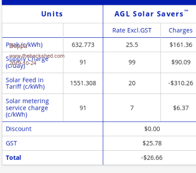

We're looking at putting in a second battery charger/grid hybrid inverter here- basically disconnecting the panels from the existing one and connecting them to the hybrid
Our gridtie has pretty much paid itself off already (next bill or two and it will have, however they are talking about cutting our payment level in half, which will make the batteries look more attractive...
I did some number crunching and as we only use 7kwhrs a day (solar HWS, 2 people living here) even with the electric stove (we don't use it much though- most of our cooking is microwave, one of those 'air grillers' or the old crockpot)
If we use 160ahr batts from Trev, running at 48v, the total battery cost is only $4700- only 700 more than we actually paid for the solar install- and it paid itself off in 3 1/2 years
At those discharge levels, we would get 20 years plus out of the batteries, and with the elec bill still practically zero, even at the reduced rate, we would be looking at a 4 year payback, after that power for free again...
Plus of course not reliant on the grid (we would rarely pull power from it at all, maybe if we got 4 or 5 days of heavy overcast)
The hybrid would be set up to charge the batts first, then excess goes back to the (official) gridtie inverter
Same at night, it would pull power from the battery bank first, and only if it is too low, will power be pulled from the grid
Officially it will still be the same system, the only difference will be the unofficial hybrid inverter in the chain
Of course our consumption is far lower than Davo's which makes it far more practical, we don't have heating costs (as we don't even have a heater lol- we fitted roof and wall insulation and retractable sunshades over the windows and simply don't need it here) or a pool (would love one, but simply not a big enough block of land to put more than a kiddies wading pool in it lol)
So for us, I can see it being worthwhile, others maybe not
