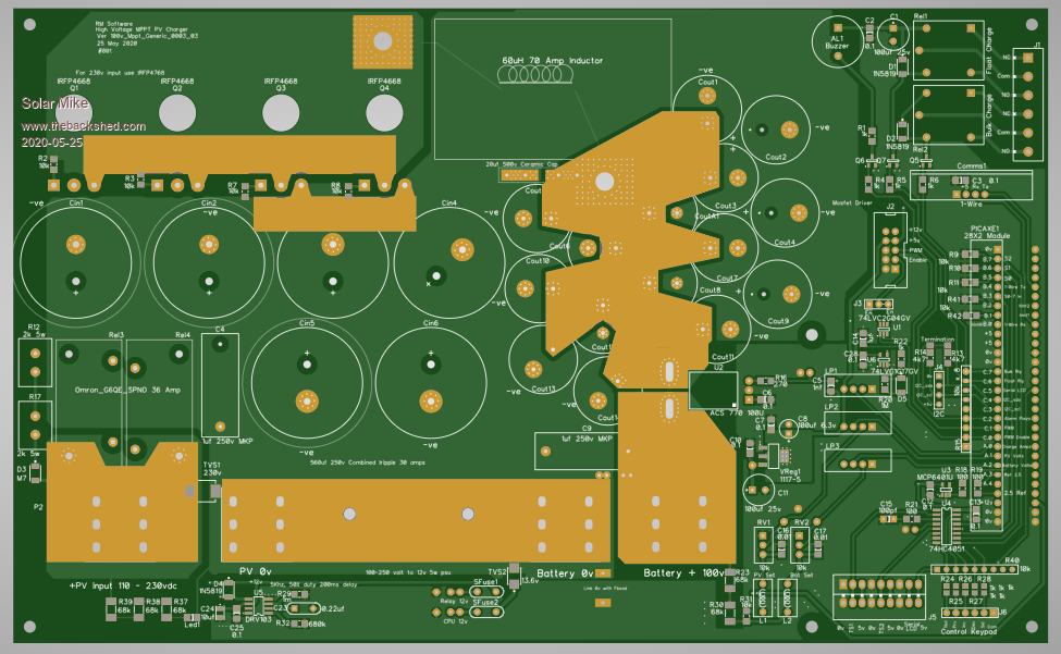

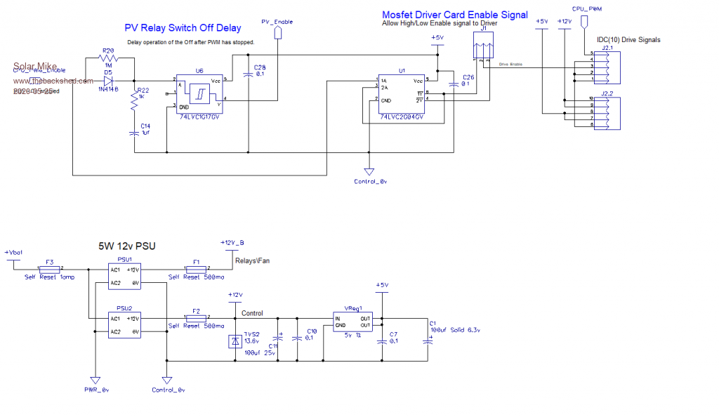

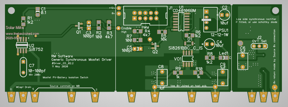

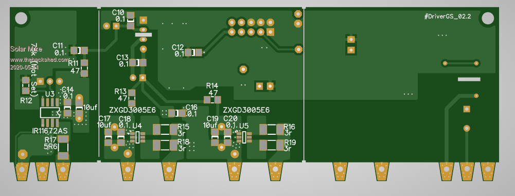

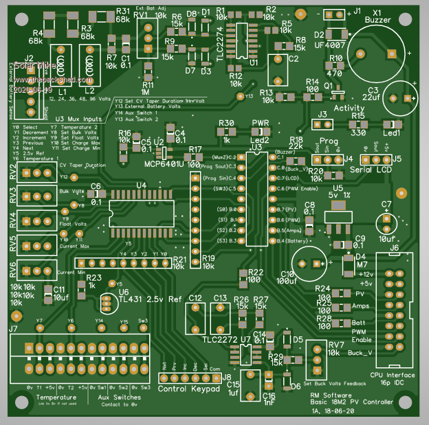

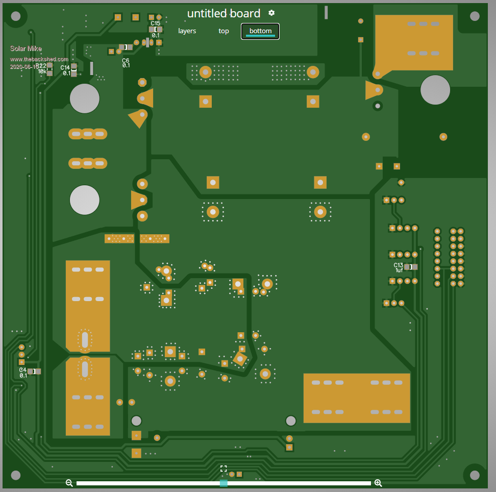

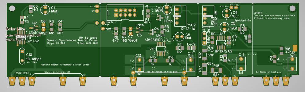

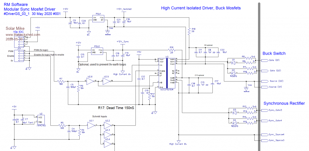

Well I still haven't sent those files off. I want to do some more experimentation and have made a more generic module that has these optional functions (129 x 46mm).
1: Synchronous mosfet driver
2: PV Isolation Switch
3: Buck driver
I want to run the mppt section at 62 to 100 Khz, so a better design is needed.
The pcb has the functionality such that the buck driver may have the optional sections simple cut off with tin-snips. In light of the work Poida is doing, the mosfet PV isolation switch may not be required or replaced by a relay. The synchronous rectifier section similarly maybe chopped off if not required and a schottky rectifier used instead. Rather than send off multiple board designs its easier to do it on one.
The buck driver section is always needed and maybe used standalone, I have changed the design of this section to use a modern fully isolated emulated opto type coupler driver, Si8261BBC-C-IS    this version of it has under voltage lockout set at 8 volts and low 2.5//4 amp capability, the chip drives dual ZXG3005E6 10amp drivers positioned directly at the gate of each mosfet. The mosfets used IRFP4668 need quite a high gate current to switch quickly and as I have  at least 50 of those tiny ZXG things, about time they were used.
Here is the PCB, will draw up the schematic to check it.
Mike

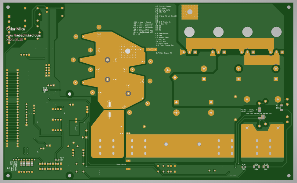

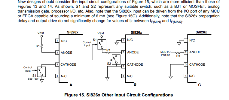

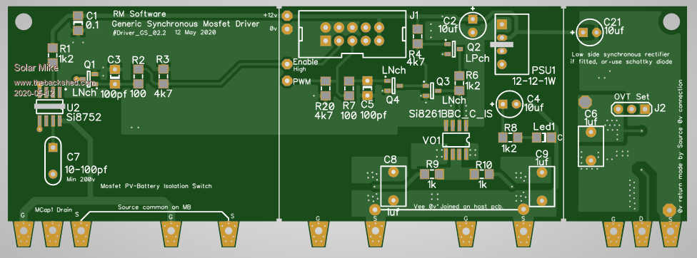

Pays to read the manual, drawing up the circuit and checking the spec sheet, the pseudo opto input doesn't like reverse drive voltages in the off state, here is what it expects.
(C) is only good for short wires back to the cpu, (B) is the best, so that's what I have re-done on the more critical buck switch.
Here is the final layout and pcb.
schematic.pdf
Few more items remaining then I can send this lot off and get started on actually building something.
Mike

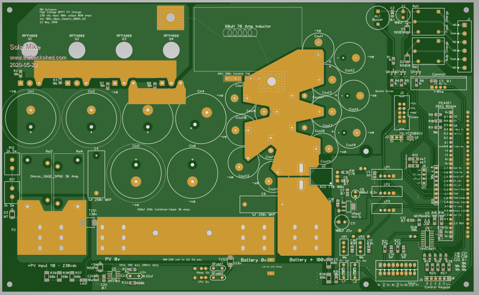

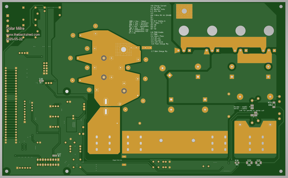

Well the few more items remaining has expanded some what; after tromping all over my roof armed with a tape measure last week to work out where to put the new PV panels that have now arrived; I'm limited to various series combinations that will fit.
The existing solar thermal hot water panels residing in the center of the roof means the best combinations of PV that will fit are groups of 5 panels in series, so the mppt voltage will be 156v with an upper unloaded value of 192v. Means I need 250v capacitors of which I have none, after re-doing the calculations for the buck converter components I need an input of around 2000 to 3000uf 250v with approx 30 amp ripple rating. The output caps require approx 1500uf with 26 amp ripple.
The previous design needed a few modifications to the pcb to fit the extra components, I have implemented a relay for the PV isolation should that feature be required, or shorted out if not. Added modular plugin pcb's for the double pole analog filters and edge mounted cpu card. The mosfet driver card solders to the pcb pins.
RS sell these 30mm dia 560uf 250v items each with a 5.43 amp ripple rating, so 6 are required for the input.
The output capacitance is better achieved with many smaller items in parallel, These 100uf ones each have a 2amp ripple rating, so 15 in parallel will give me an easy 30 amp and 1500uf. I could have used the bigger 560's but then I would have too much capacitance and the voltage feedback response would be way too slow for stability.
Here is the first cut of the new layout.
Mike

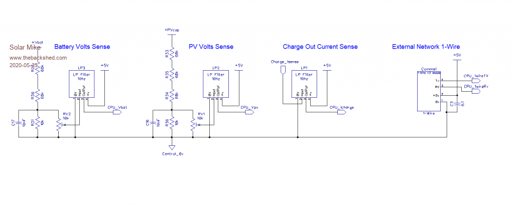

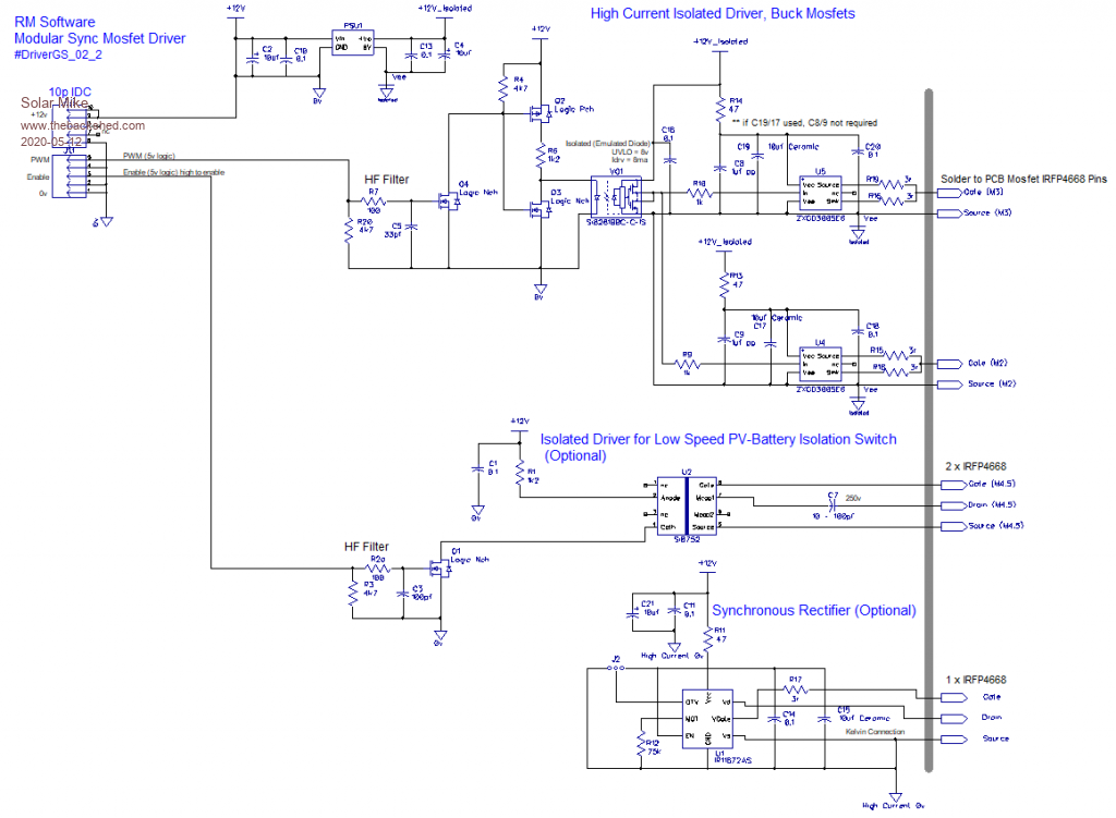

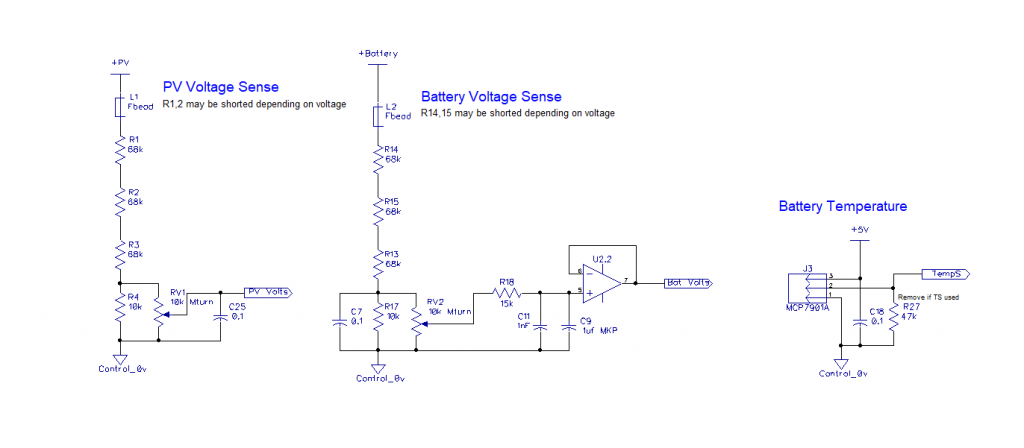

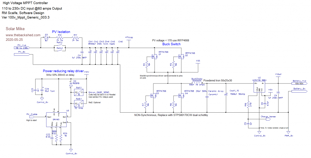

This has been an interesting exercise, found a couple of issues in the circuit, and made some changes to the keypad connection. Otherwise no errors that I can find. I will have to modify the mosfet synchronous driver card as the driver chip "Drain" voltage sense has a 200v max, so will add a resistive divider.
Here is the bulk of the schematic which I drew up to check the pcb layout, not shown are the actual CPU card details or the 2 charge state output relays, reason I have for using the plugin CPU card is to make it an easy exercise to replace the CPU with another, like one of the "Mite family"
Mike

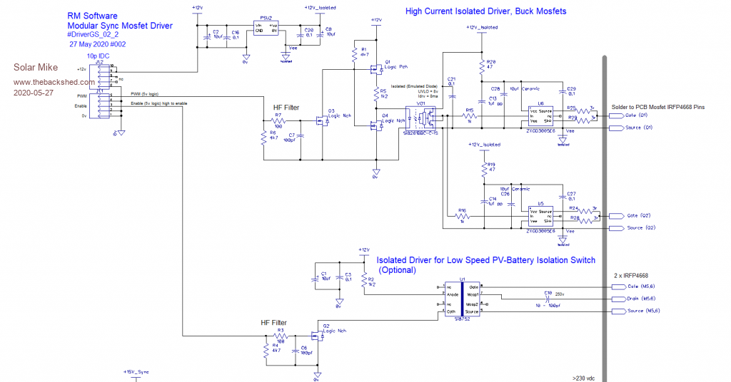

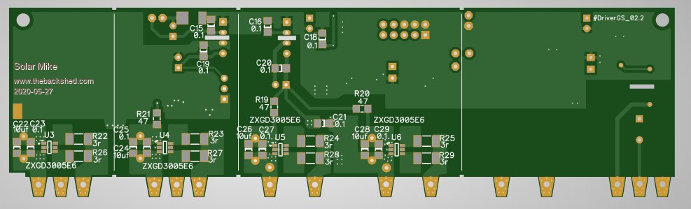

Posted: 08:56am 27 May 2020

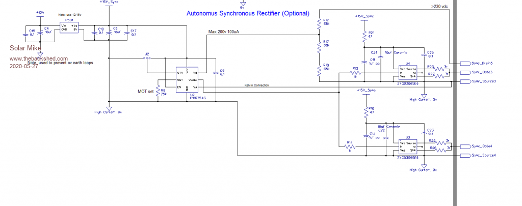

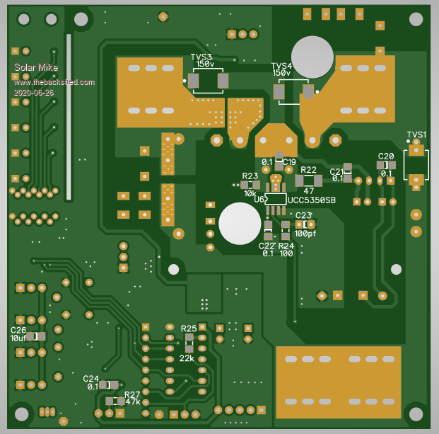

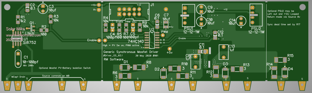

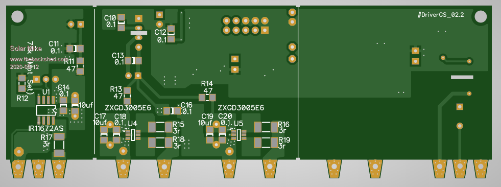

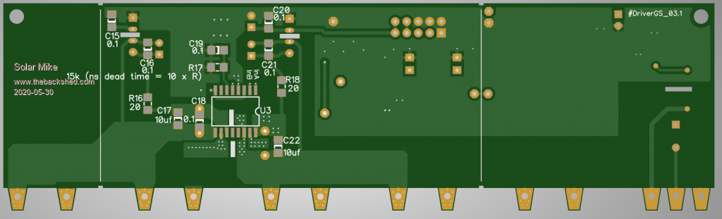

Made changes to the generic driver module to allow it to run with > 200 volts input, the synchronous rectifier driver chip IR11672 has a max sense input of 200v, have added a resistive divider to allow in excess of 250v; this change also affects the chip voltage sensing points, but seems ok looking at the spec sheet.
As these drivers have limited current drive of only 2 amps, have implemented supplementary boosters for each mosfet using the ZXGD3005.
Have made the pcb so unwanted optional sections can be simply cut off, rather than designing multiple boards, the cut off bits can also be used standalone. Noting that all mosfets are mounted spaced 28mm apart on the heat sink.
Will make a schematic to check it.
Mike
Edited 2020-05-27 19:06 by Solar Mike
Solar Mike
Joined: 08/02/2015
Posts: 1255
Posted: 11:18am 27 May 2020
Seems ok.
Mike

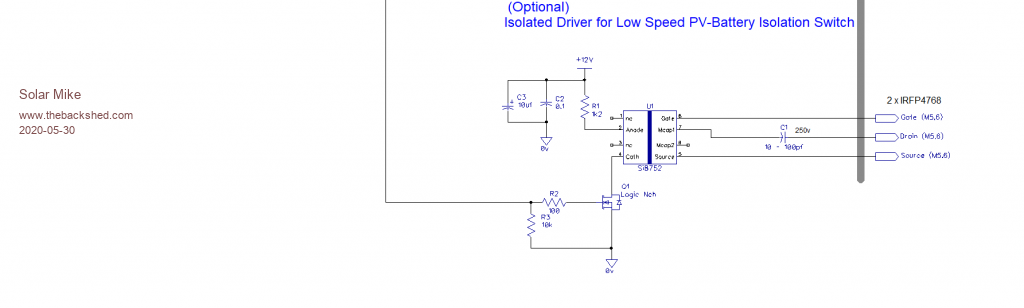

There is always the possibility that the above circuit won't work in the synchronous rectifier part, so have prepared a "Plan B" pcb and will get made at the same time......... just looked at JLCPCB site, only postage option to NZ costs US$35, must be the strife in Hong Kong, seems there is no air post or less expensive courier options any more, this makes small quantities of boards very expensive.
Will check the schematic.
Mike
Solar Mike
Joined: 08/02/2015
Posts: 1255
Posted: 11:22am 30 May 2020
No Errors on pcb that I can find: Circuit below.
Mike

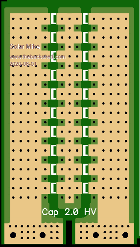

Posted: 01:10am 01 Jun 2020
Last pcb done, its the low esr ceramic capacitor module, the pcb has 20 x 2 series in parallel to give me a higher voltage rating.
Even good quality electrolytic's dont absorb high frequency spikes, the small module placed across the output caps makes quite a difference to the amount of EMI produced.
I have a reel of 1000 1uf 100v caps and want to continue using them; the 250 volt and above 1uf ceramic caps are expensive, ones on AliExpress are most likely not voltage rated and not recommended here.
Placing them is series has certain advantages if one shorts out, as the other prevents a melt down, when they short they usually burn holes in your pcb as they continue conducting current as they carbonize up. Placing them on a small pcb allows easy removal if this happens.
All gerbers have been sent for manufacture, cannot wait...

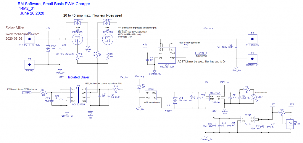

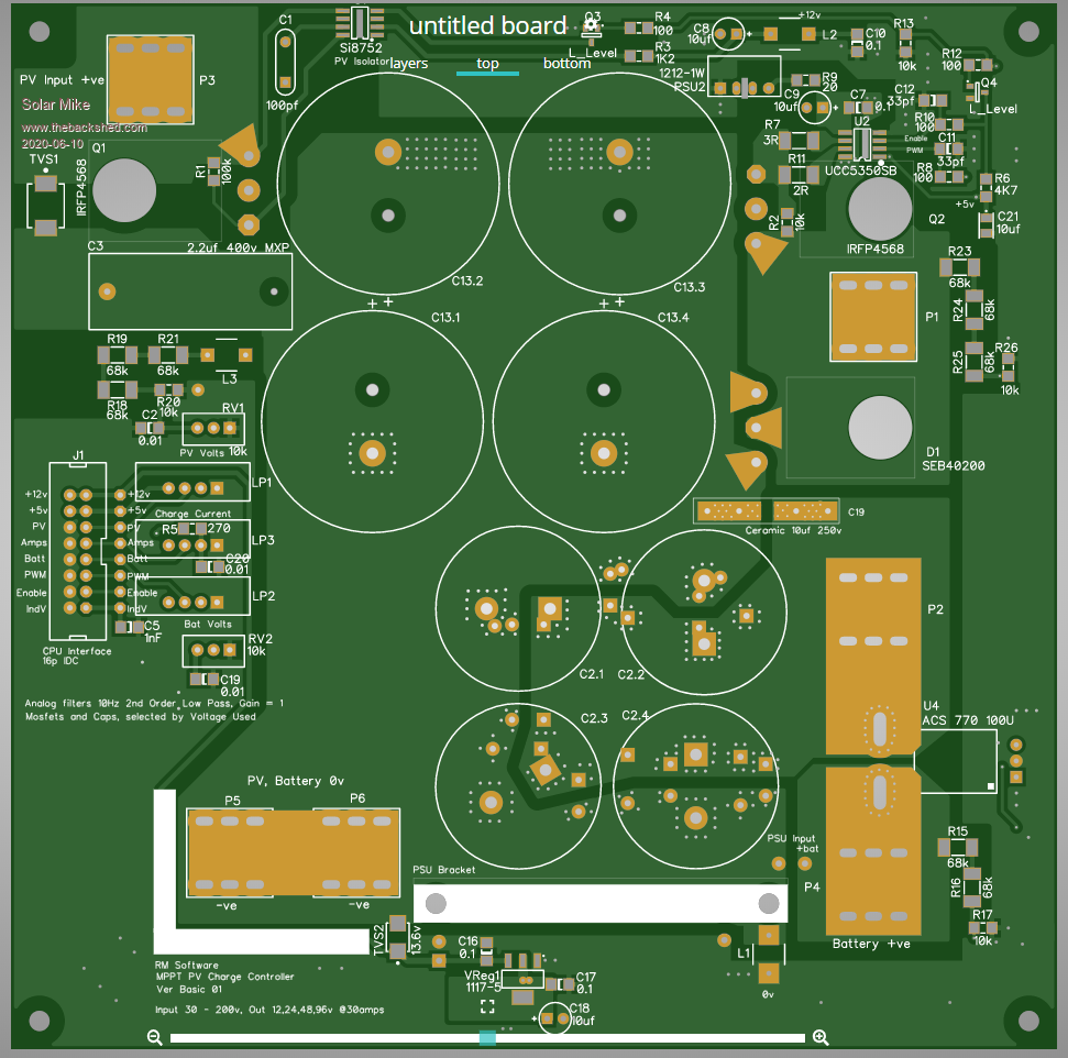

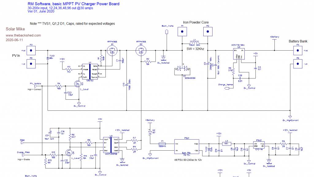

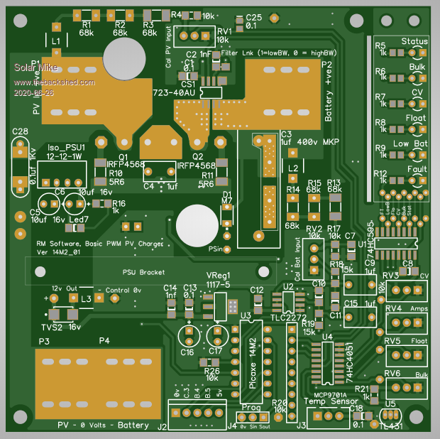

Cool, boards are done and being shipped back... meanwhile I need a couple of smaller controllers that can be used for 12 to 96v battery and up to 200 vdc input at 30 amps charge out. I have a couple of 1Kw UPS units that I want to charge via PV panels; Expect most of the time charge currents will be < 20a, so physically smaller.
Have come up with this minimal no frills design, fits on a pcb 165 x 165, cpu (Picaxe 14M2) fits on a daughter board and connected by 16p IDC cable. PWM frequency is 32 kHz and a small 50mm OD. powder Iron core is used for the inductor. There is a mixture of hole sizes for the electro's, as components used are dependent on the expected PV input and battery voltage.
Will draw up the schematic.
Mike
Solar Mike
Joined: 08/02/2015
Posts: 1255

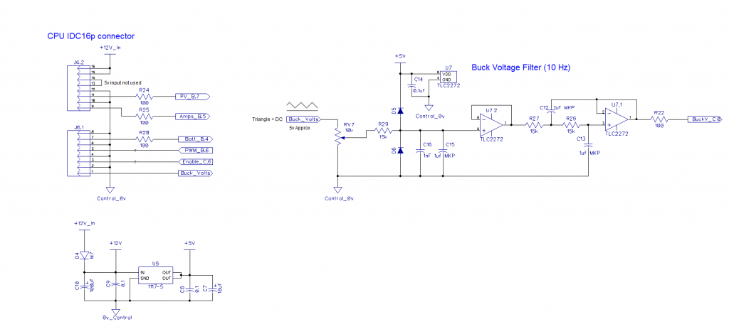

Posted: 01:30am 11 Jun 2020

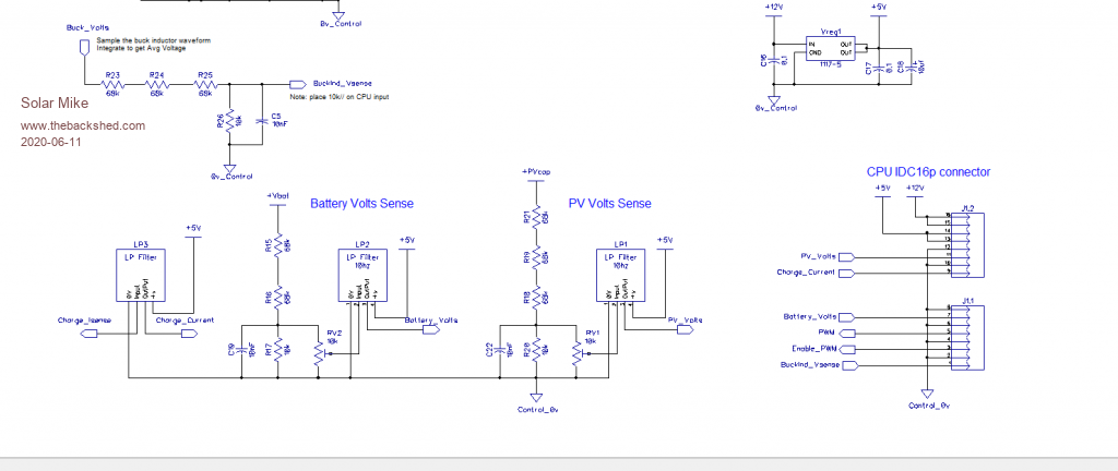

Schematic done, couple minor issues on pcb, now fixed, have increased the buck inductor to 150uH, needs 30T on the core I'm using, testing will pick up any issues... normally at the lower charge currents, anything below 1 amp the software will probably turn charge off.
This design will have a secondary voltage feedback loop integrating the buck inductor triangular waveform, the average of this is an accurate measure of the output voltage and could be used to vary the output if no load was connected, eg a power supply.
Schematic: 2 halves don't quite line up sorry.
Mike

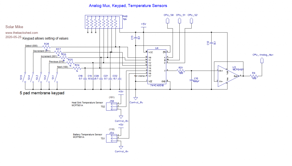

Solar Mike
Joined: 08/02/2015
Posts: 1255
Posted: 11:10am 19 Jun 2020

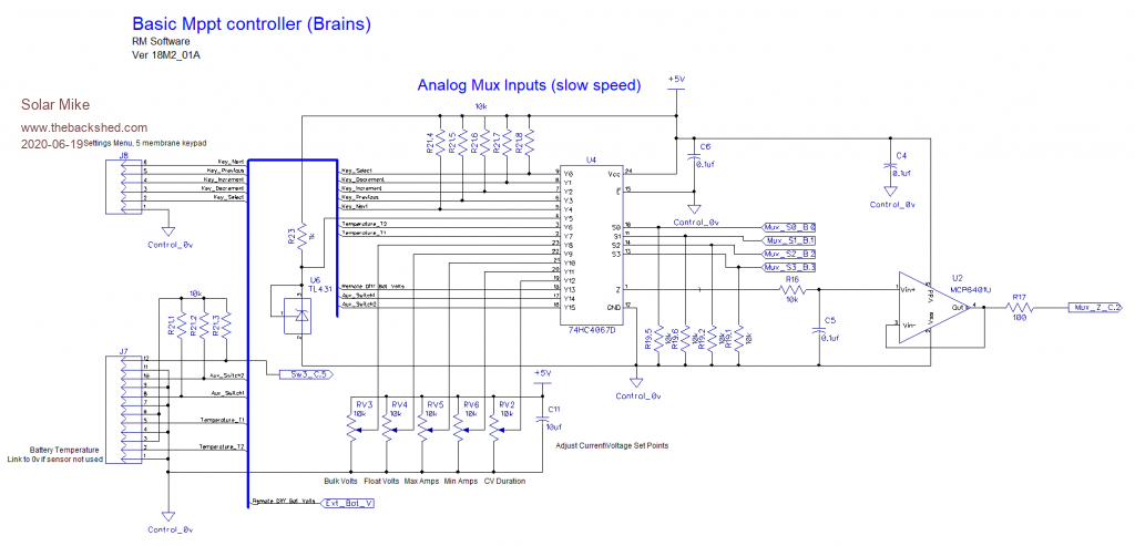

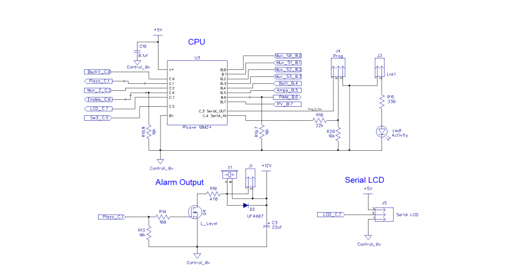

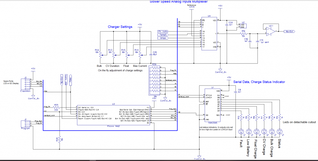

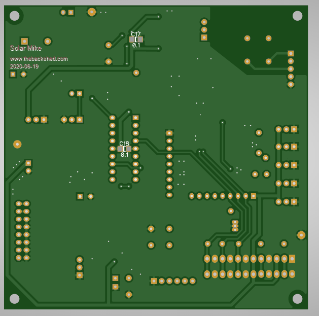

Made a controller for the power board, fits on a 100x100 pcb.
Features:
Have made provision to add a 5 key membrane keyboard so a settings menu can be modified on the serial lcd screen.
Basic voltage set points can be adjusted on the board via multi-turn pots if required.
Added 2 temperature sensors, one used for measuring battery bank temperature so accurate charge voltages can be set.
TL431 reference used, internal cpu is not that accurate.
Voltages for mppt calculations made via Buck Inductor voltage sample, as mppt will be used at all times because in a live system with varying loads which can be quite large, even in float mode near max charge current maybe required. Switching from mppt to PWM mode will only be used when load currents are very low.

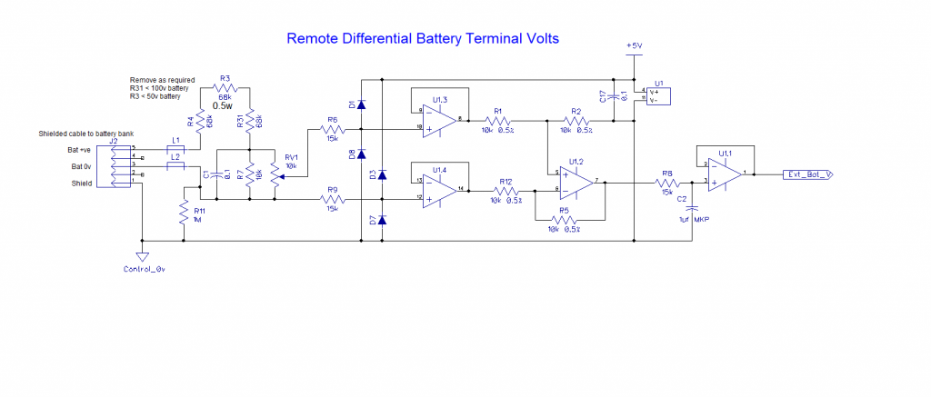

Differential voltage sensing input can be used to read the bank voltage direct at the battery terminals, so avoiding various voltage drops in output cct breakers and cables, required for Lifepo4 banks.
Circuit:
CPU used here has a max PWM with 10bit resolution of 32 Khz, this makes the buck inductor bigger than necessary and problematic to make. To have good voltage control at low charge currents the buck operation should remain in continuous conduction mode, this requires quite a lot of inductance > 1mH; however at high currents 40 amps in this basic design, a much lower value is required near 150 uH; I aim to run with approx 25% output ripple current or 10 amps ripple, any more unduly stresses the caps.
The DC current in the inductor decreases the unloaded inductance quite a lot, so is a bit of a juggling act to get the right core. Those ferrite E-cores E70 type saturate so easily they require air gaps approx 2mm and more turns; They are better suited for > 80Khz operation, so that rules them out for this design.
More suitable for 32Khz operation are the powdered iron type like this one
MS-292060-2-DataSheet.pdf, this requires 35-45 turns of 10mm wire and will work well, I already have some so will be using them, available from Micrometals for US$6 each.
Will post the pcb shortly.
Edit: Checked pcb, added couple of extra test points, no errors found. Gerbers sent to JLCPBC
The temperature sensors I use are these MCP9701A , they are calibrated buffered thermistors with low Z output, reason I use these over the DS18B20 1-Wire is that the picaxe doesnt have to interrupt its running software to communicate with them, as they have an analog output. Using any 1-wire or I2c devices stuffs up PWM outputs with altering speed or jitter, not good.
Those MS-292060-2 cores are low cost but possibly expensive to ship, have sent an email to Micrometals, see what air postage charges are.
Mike
Edited 2020-06-20 10:12 by Solar Mike

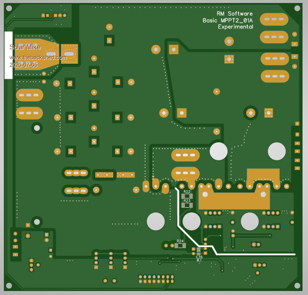

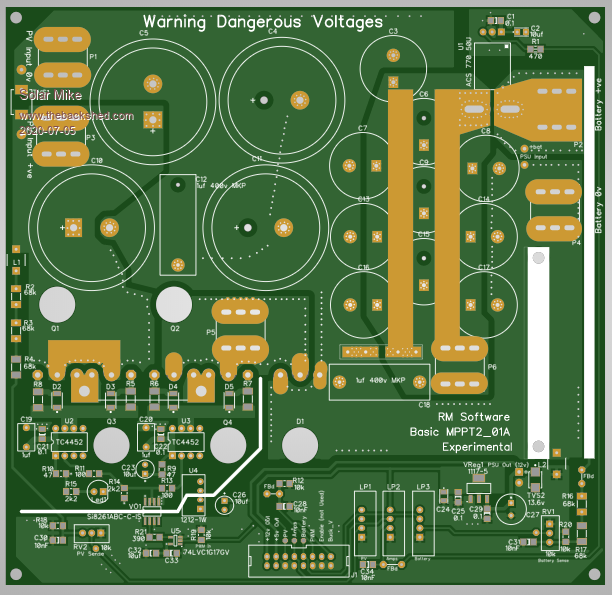

While waiting for boards to come back, have thrown this experimental non-synchronous design together, uses a different switching arrangement of the buck mosfets, so when they are off, there is no self discharge of the battery back into the source supply or PV array, the MPPT module uses the same controller as previous design. PCB measures 167 x 161mm.
Will be using this for a 5KW battery charger, as we need one with a variable current setting front panel control, to stop placing too much load on the generator.
Finally MicroMetals in USA got back to me, the cores I want are readily available but in min quantity of 50, I have asked for a reseller who can sell me 10, but have had no reply back.

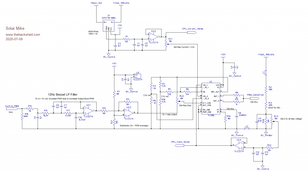

Seeing as MicroMetals can't be bothered to reply and tell me where I can purchase their cores from, will come up with an alternative solution for use with the generic controller.
Having a high frequency PWM drive to the buck inverter makes things like finding a suitable inductor core easier; smaller cores are more readily available online and being lighter, cost less for postage.
Have decided to use a pwm power supply chip to generate the PWM at 100Khz and maintain a fixed output voltage. The TL494 family of chips have a dead time voltage control input that allows external control of the chips PWM duty cycle. The CPU only needs to have a DAC output that can be connected to the chip to vary its output.
I have put this schematic together that uses a 1Khz 10 bit pwm control signal to vary the duty cycle and thus output voltage of the PWM controller, for this have used the TL598, which has totem pole drive outputs, otherwise near identical to the TL494.
Control PWM is passed through a bessel filter to produce an average DC out, 0 duty cycle will produce 5 volts out, as control duty cycle input is increased, the output will move closer to 0vdc; connecting this voltage to the DT control input allows the CPU have direct control of the psu chips output drive to the buck mosfets. That's the theory anyway, will make a small pcb to host the extra components to test.
Mike
