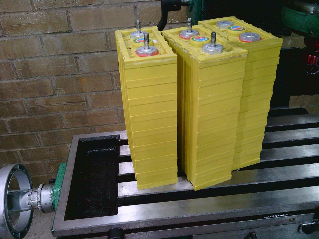

Posted: 08:40pm 25 Nov 2020
  Revlac said
With a properly managed lithium setup (still more improvements to be done in future) should be maintenance free, setup and forget.
That is what I had hoped for.
However, several sudden catastrophic cell failures have made Lithium less attractive.
That is about $150.00 per year worth of dead cells, which would buy a lot of grid power.
Even if there were zero capacity degradation over time, battery storage looks like a financial loser.
Cheers,  Tony.
